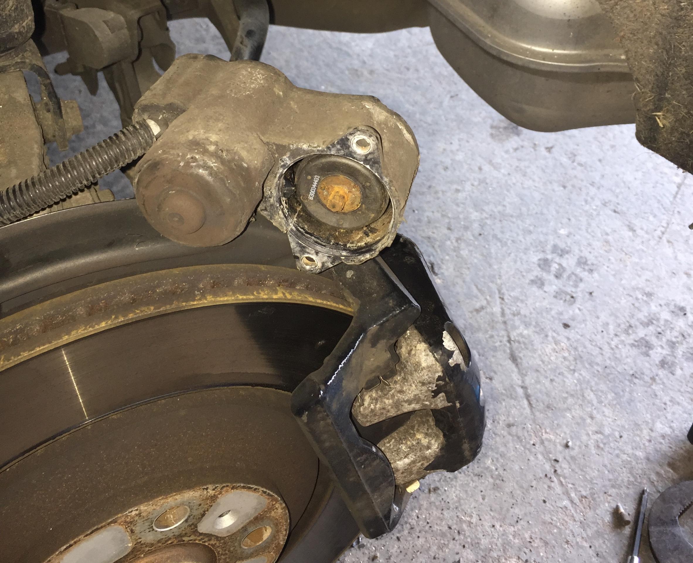

So after much testing, dismantling, reassembling, hitting with a hammer, spraying with lube...... both the calliper and motor for my N/S EBC will need replacing. Damn it.
