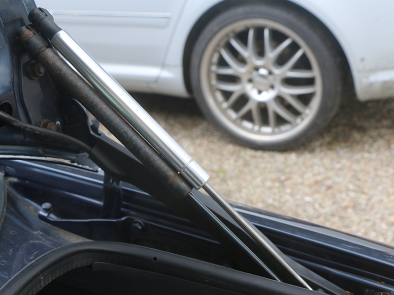

I think ever since I saw the first D3, I wanted to fit chrome boot struts to my D2, except I could never find them for sale anywhere. I chased a few companies, but no one seems to manufacture the chrome ones anymore.
Fast forward to a post I saw on Facebook about a fortnight ago, announcing the demise of the A8parts company W12 D3, along with some photos, one of which included the gas struts. A very quick call to Maria and I had them paid for.
This is what arrived. Nice and shiny, but a quick going over with a little Autosol and now even cleaner. So far as size is concerned compared to the original ones, the D3 chrome ones are about 1/4 inch longer overall... thankfully. This is a rough side-by-side view of them:

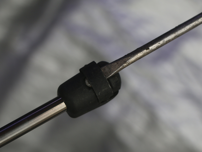

So far as fitting them is concerned, there is a small flat piece of metal wrapped over each connection point. I used a small flat bladed screwdriver to gently prise is off slightly, as shown.
I started with the strut end attached to the boot itself as it was easier to get at. Once you prise the metal away from the strut, you can just pull back gently and rotate the strut of the ball joint. If the boot is open fully, there is no excess movement from the strut. I then moved the strut back over the lower joint to get at the second indent for the clip.
Fitting the new ones are pretty the same in reverse. First, insert the screwdriver blade into the first indent (lower end of strut) and set strut on ball joint. Slide the screwdriver blade out and the strut locks in place. The same process works for the upper attachment (to the boot lid), but test the strength of the strut beforehand to see how far you will have to compress it (since they are slightly longer).

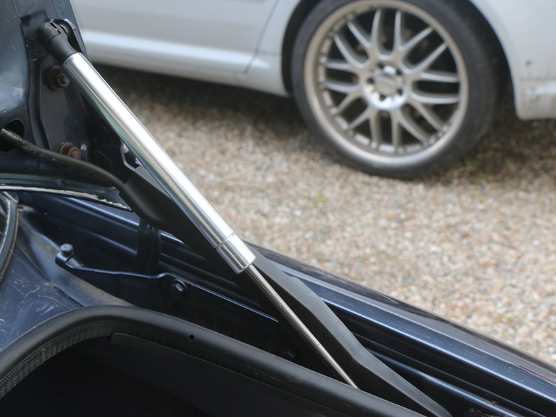

Repeat for the second strut, and then give them another wipe down, and they should end up looking like this:
