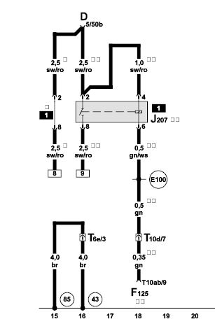

I don't appear to have a photo of it unfortunately. Its J207 which Elsawin claims is top left in the relay panel in the footwell. I remember it being more in the middle of that panel tbh. The manual has a jumper between pins 2 and 8 per this diagram:
I used some 2.5mm wire and some 6.3mm terminals to bridge 2 & 8. The factory one is a bent bit of copper, but I have no idea what the number is so just made my own.
If you jump power to pin 8 it will spin the starter which might be diagnostically useful.

Late at night and just been sampling 27 and 36 year old whiskies, but that looks good.
I'll investigate further tomorrow.
Do you remove the relay and put the jumper in or need both?
Also I can't recall the layout there, is that the main panel under the "board" under the passengers feet, or the section that I think is above it?
