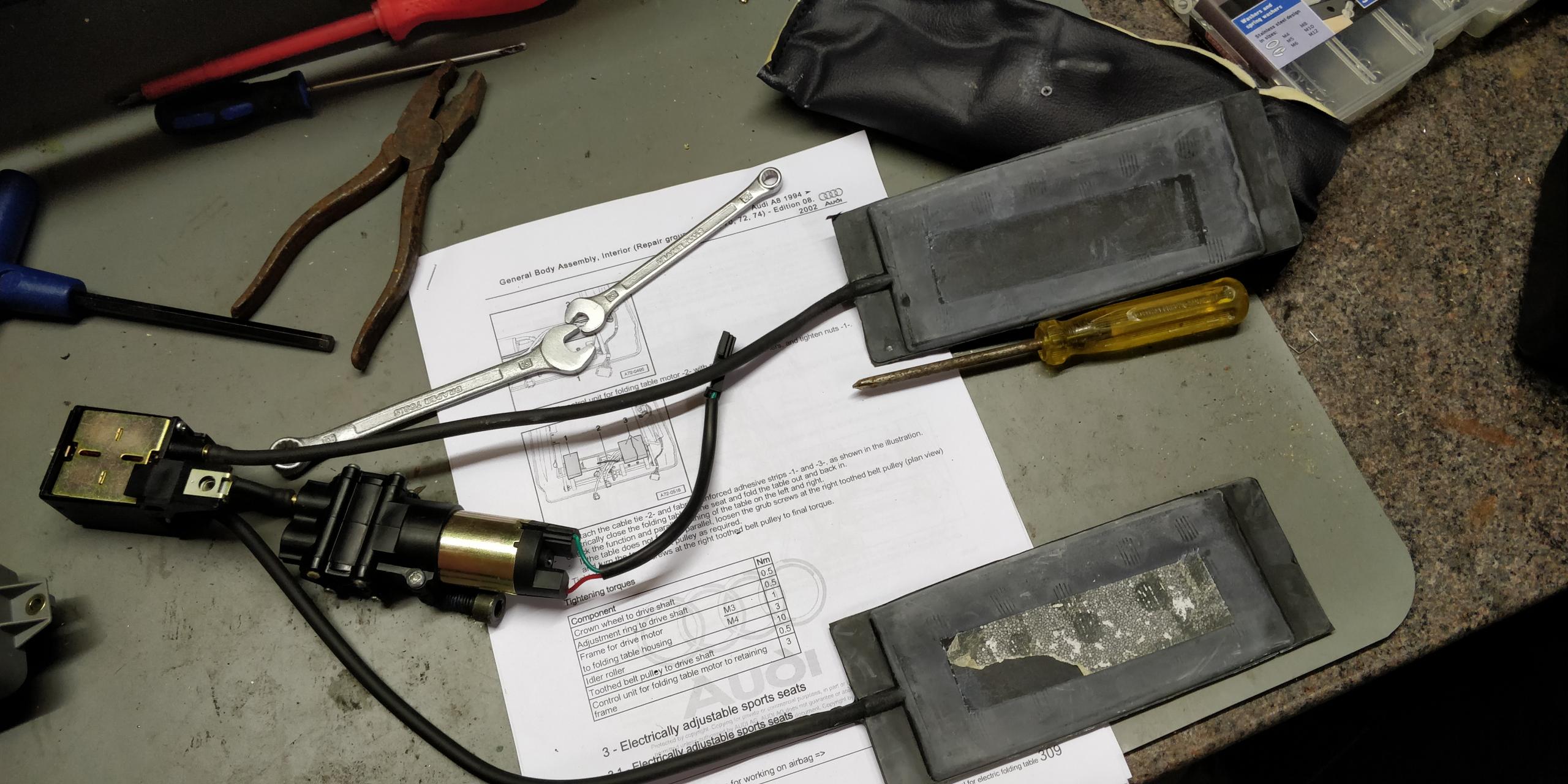

Has any of you done this?
Both front seats in my car have leaky lumbar support.
I've taken apart one of the seats and will be doing a leak test to see where its actually leaking from.
I can't find much info on this online so will post here and update you with my findings.
So far I've tested the air bags themselves and they are holding up just fine so the fault must be somewhere else in the system.

OK, i tested every single part of the air system and found it all to be OK except for one of the outlets on the valve block, it has a little crack that quickly lets air out. My car is a 2002 so i doubt it was ever fixed.
The second pic shows the brass insert with an O ring, and the red lines show how tall the 'collars' so to speak are. Only one (the tallest one) is cracked.
I'm not gonna risk fixing that with some epoxy after taking all this time to carefully take apart the seat, i think ill look for a similar pump in other VAG models, or maybe pre fl A8 had a metail manifold on the valve block or something...
I also thought about submerging the whole thing in some sort of liquid rubber or tar and letting it set, but thats a bit extreme.
suggestions are welcome.

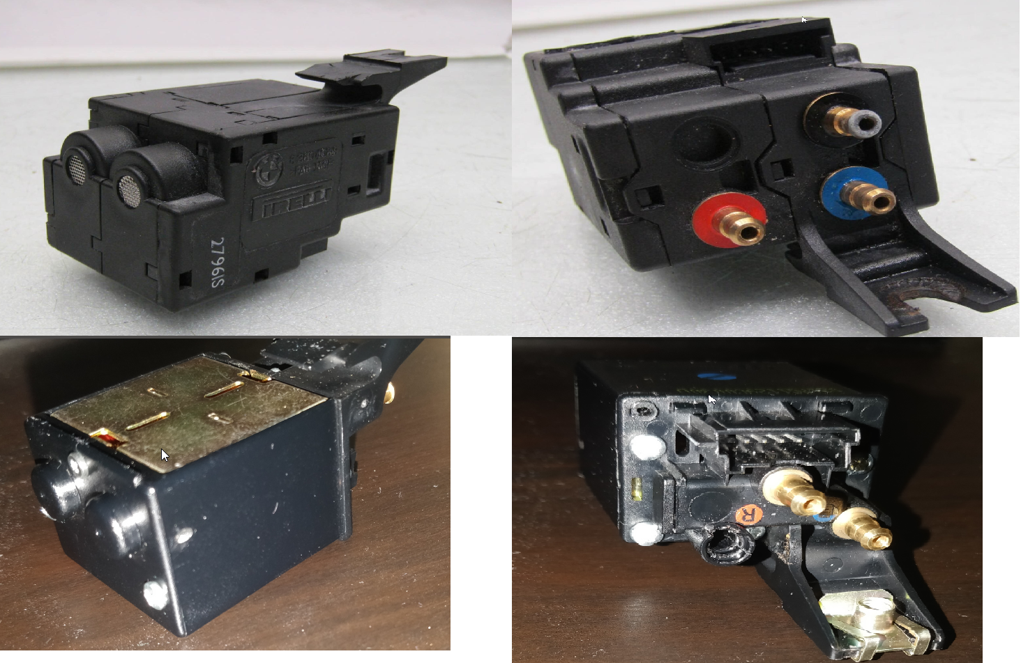

Update:
7 series e38 valve block appears to be suspiciously similar to the audi one, except they don't seem to have the cracking issue as the inlets are completley recessed in the plastic. I bought one to try and will let you know how it goes.
