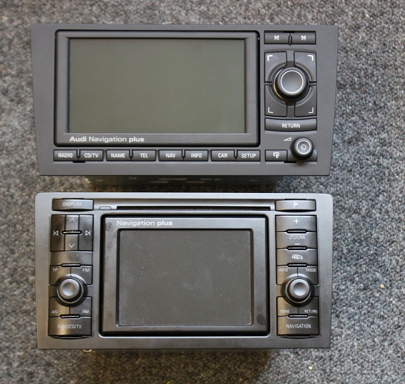

A quick, and very productive half hour this morning:
Firstly, a quick shot of RNS-D and RNS-E side by side. Notice the taper on the sides is bigger on the A6 RNS-E than the A8 RNS-D - This is good, no gaps. The top edge between the screen and top is almost identical too. Notice also the more matt effect on the RNS-E that comes on the later Audi models. Its one of the few downsides of this upgrade that it wont quite match the climate as well....
Here is a side on view. Notice that the RNS-E comes with these lugs on the side, now call me chicken, but because I dont know 100% that this RNS-E is going to work/fit, I'm not willing to snap them off just yet, which is what most folks do.....
And here is a rear shot to complete - Notice that not 1 single connector is directly transferrable! - Eveything changes......
My solution to the side lug problem - A hack saw:
and it works beautifully, the RNS-E drops in nicely....
And in goes the climate module. Arrows show the discrepancy between the A8 taper and the A6 taper, not a great deal in it. From memory, the A4 units have a more narrow front so the overlap is the other way. You can see the different in plastics now too....
but all is forgiven, look how fabulous that is
..... And the front cover has popped on without trimming the sides off, which means I can test to my hearts content and consider never trimming the sides off by the looks of it... The slight gap between the climate module and the unit is because I have no screws in the climate module - that will nip up perfectly me thinks... Cool, what a result....

To answer my above question with a quick test fit, it seems the sides need a little sanding down as the wood otherwise doesn't sit flush. Here's some pics from my test install.

Hmmm. Interesting. It will be interesting to see if mine fits on still when its all bolted up, I guess it wont if yours doesnt....
Never mind, a little trim it will have to be then...
