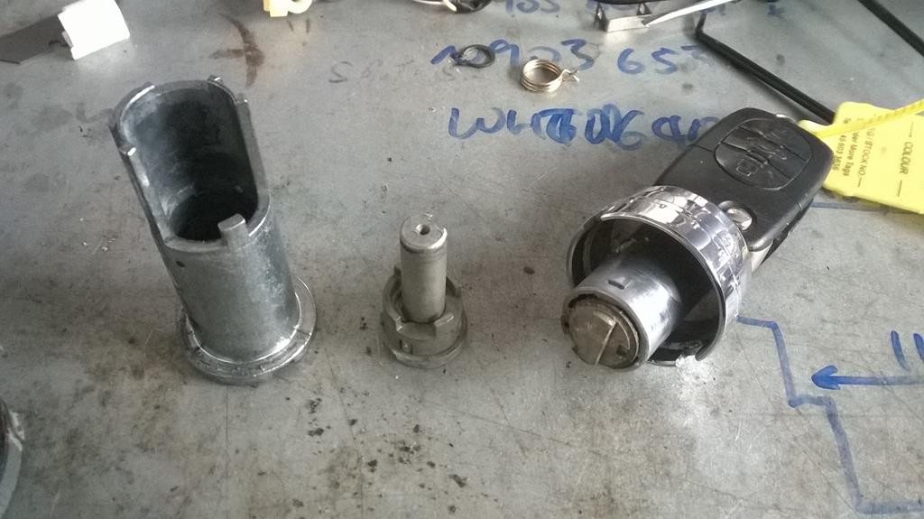

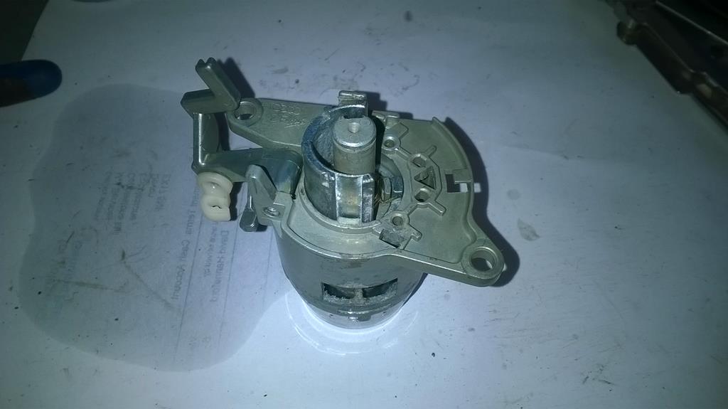

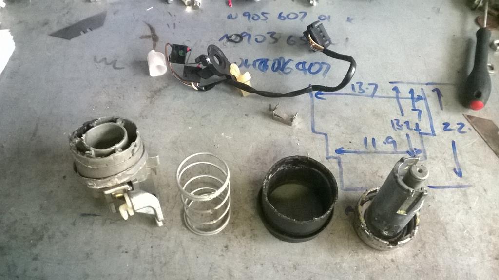

Also fixed the boot lock since it was seized completely solid

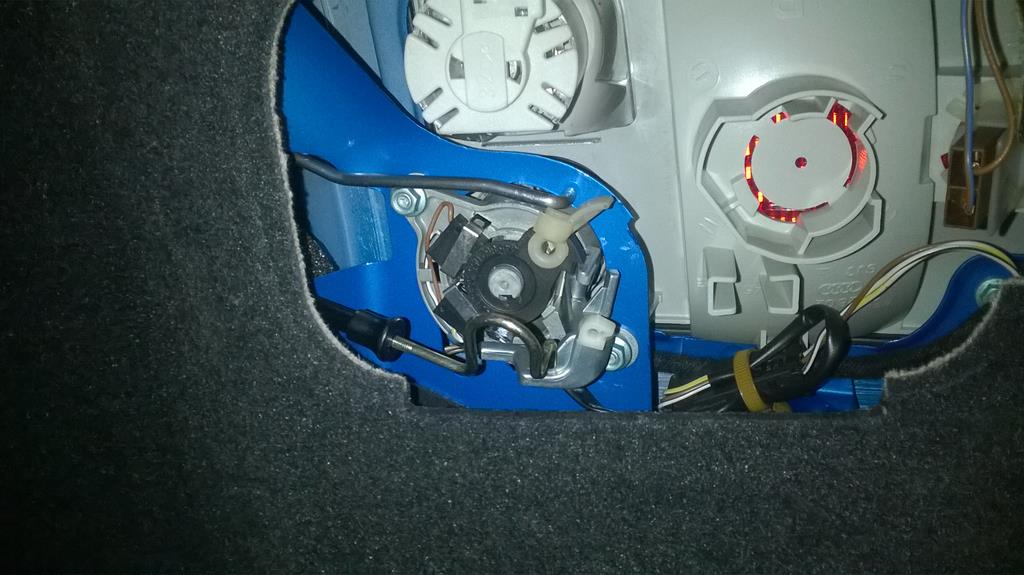

Removed via the door for for the light cluster
Disassembled the main body
The lock barrel was completely seized in the housing. Lots of WD40 and wiggling and it finally came free.
Crusty!
Started removing the tumblers

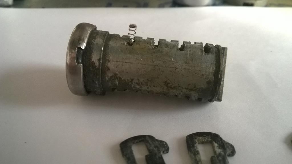

All disassembled. It took about half an hour cleaning schmutz out of the barrel with an assortment of pokey tools, degreaser and compressed air before the little door would close again!
Cleaned all the tumblers up
Reassembled prior to re-greasing
Going back together

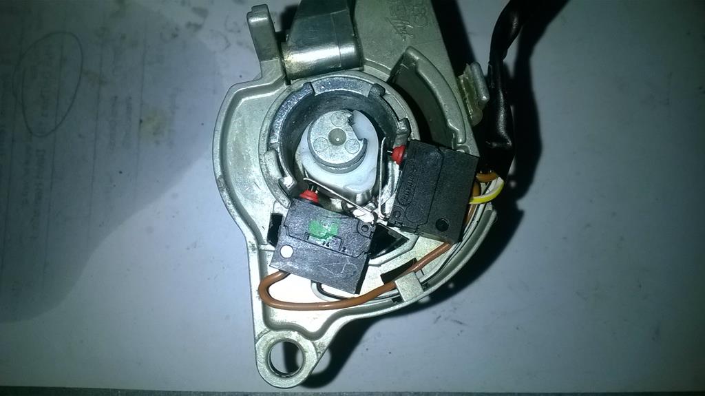

You can see the cam which operates the central locking here via these two microswitches
All back together and ready to put back in

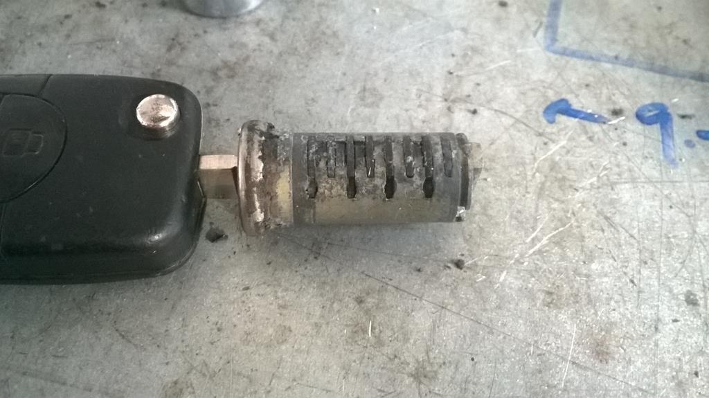

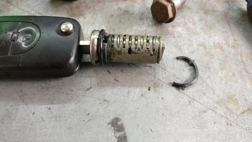

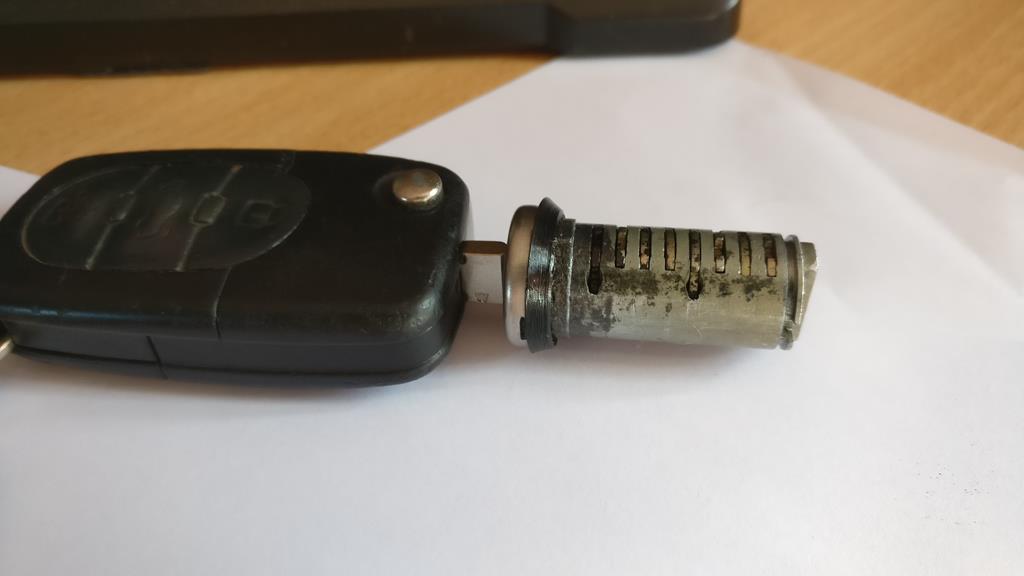

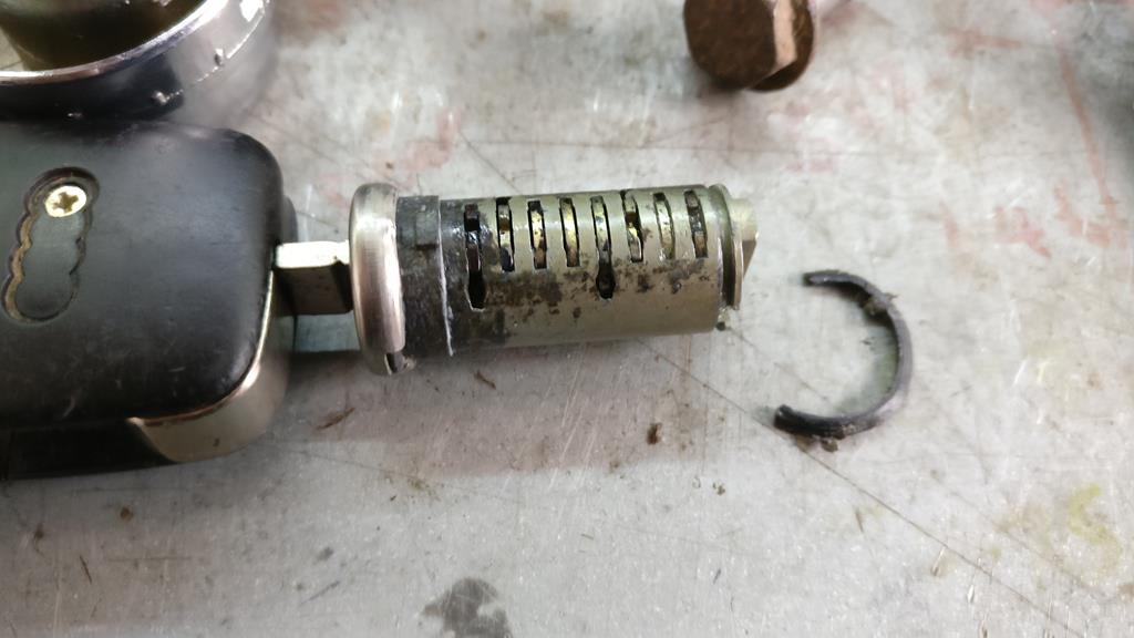

I've been having a look at David's lock over the weekend. Everything seemed in good order and nicely greased, but the barrel was stuck fast in the surround. After sitting overnight in WD40 I managed to get it apart and discovered that it was just corrosion on the first few mm of the barrel holding it place.

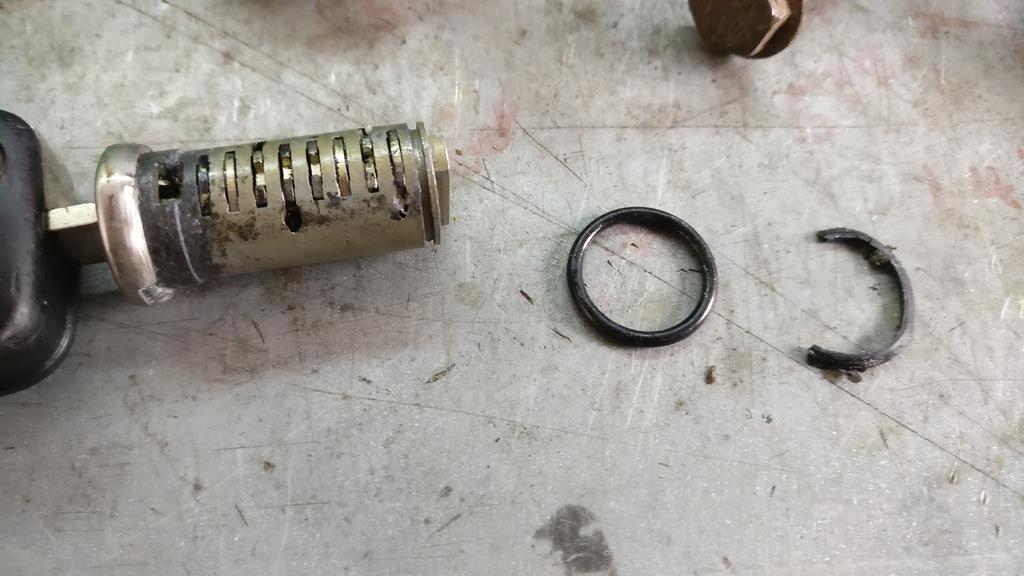

After cleaning, it was clear why - the rubber seal was perished and disintegrated so moisture could get in.
The seal is a flat-ish moulded thing which is not available as a spare part. The thought occurred that an o-ring might work to replace it, and the oil cooler pipe o-ring appears to be just the right size
It actually goes together quite well, but its a little stiff to turn so it might need a smaller o-ring.
Or, I might see if I can print a polyurethane replacement for the original seal.

Mine doesn’t have a seal there at all, and the barrel was corroded at the top end like David’s. I’ve got a load of different sized O-rings, so I’ll pop one in when I fit the last tumbler. Good job you pointed that out, otherwise I expect mine would have corroded again in no time!
Old 22nd February 2021, 11:09 AM
I'm about to try printing one. If it works, I'll post you one with the tiny spring which will be on its way this afternoon
Old 22nd February 2021, 12:11 PM
The printed part is perfect for the job will post a pic later

Printed seal in place:
