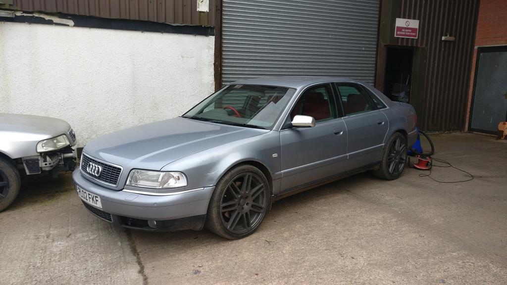

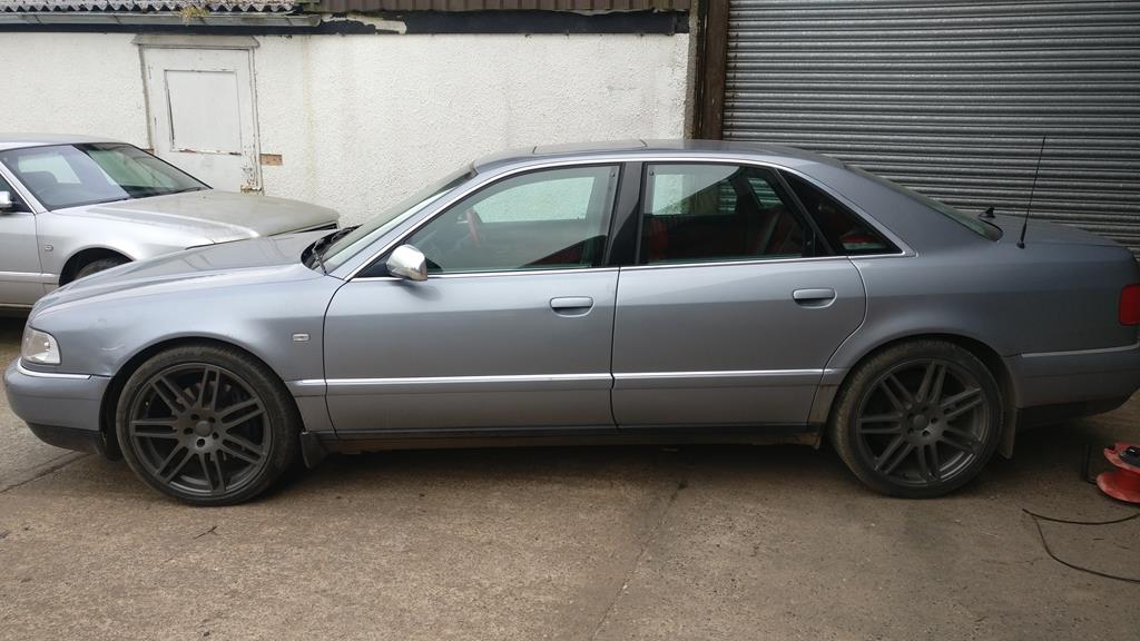

Bert bought it, basically to save it. At the price it went for it would have been bought by some test pilot who would have thrashed it until it was dead and then scrapped it, and we can't have that

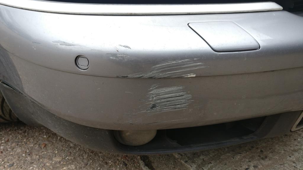

The conclusion is 'needs TLC but definitely saveable' Someone has attempted to recommission it but realised they are in over their heads and bailed, so lots of trim is removed and things have been tinkered with, but underneath that is a good solid car. The front wing and bumper are a mess, but its all original paint other than that which is great. A replacement wing and bumper and a day or two on the DA will have it looking lovely. The one thing the ebay seller was right about is that the interior doesn't look like it has 170K on it - that will also clean up very nicely.

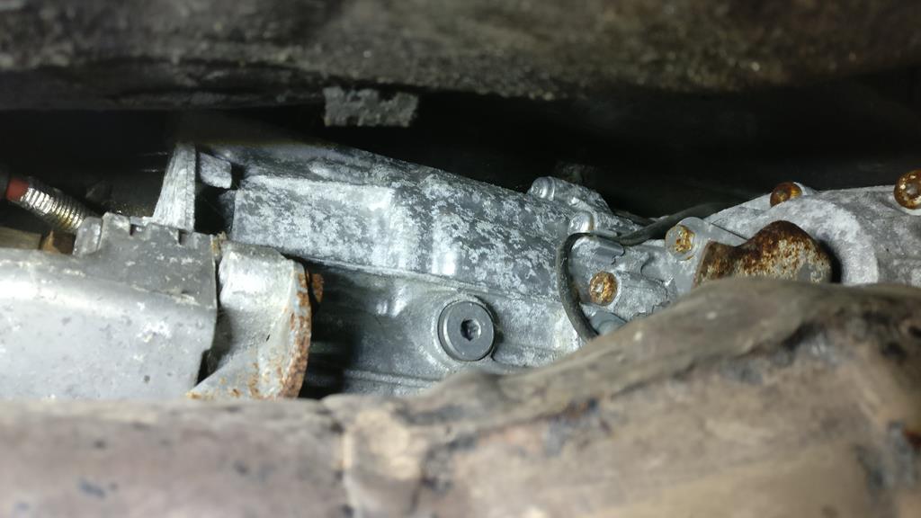

One bonus is that it does appear to have had a gearbox refurb at some point as the box has been blasted and painted. There's no paperwork with it so I might call the usual suspects and see if they have any record of the registration number.

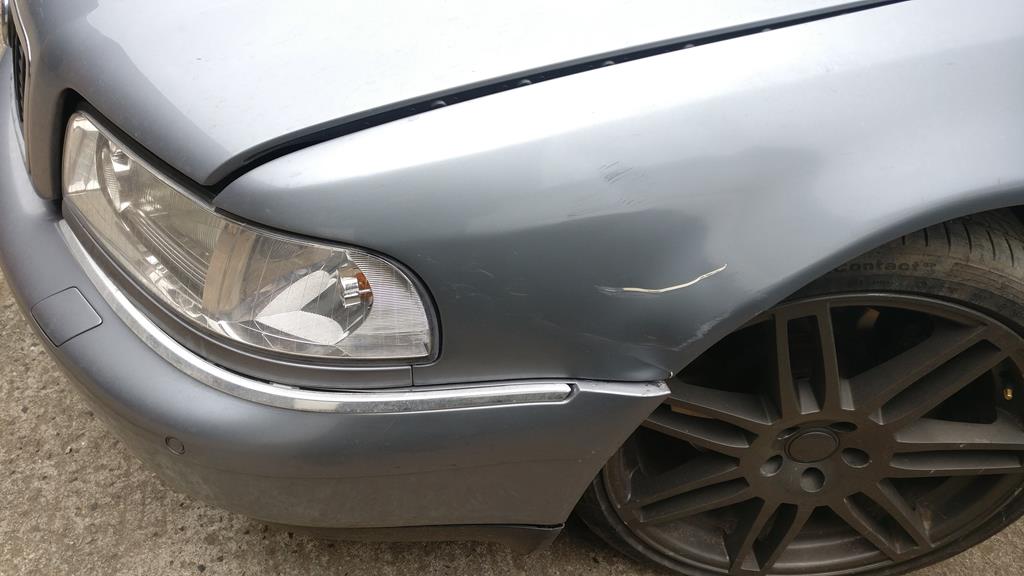

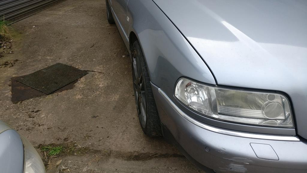

Scratch on the bumper:
Damage to the wing:

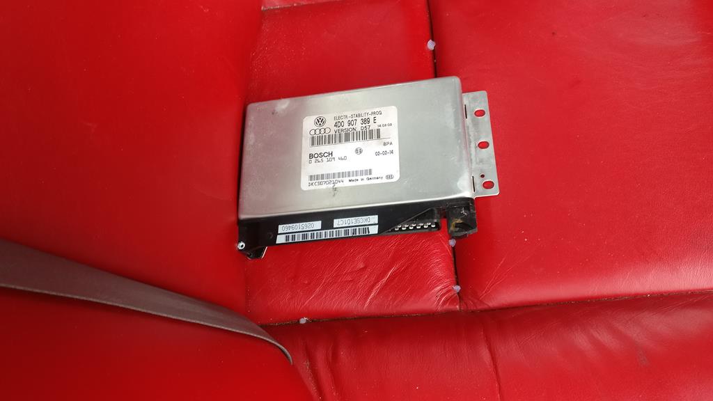

The ESP unit has been replaced but not coded which is the reason for the ABS lights so hopefully that will be simple to fix. Here's the old one on the back seat!

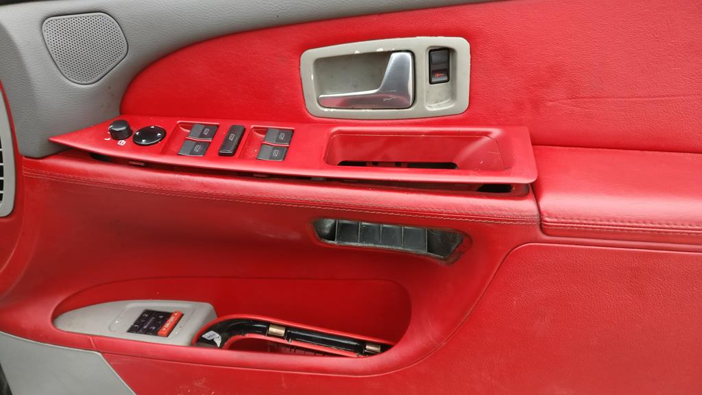

Not sure why the driver's door card has been been fiddled with, but the red inserts are all in pretty good condition

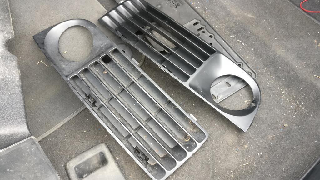

Both foglight grilles! One of which is fairly new

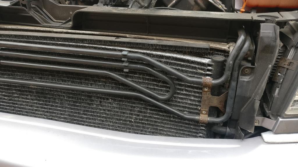

'needs an AC regas' Yeah. Needs a new condenser as I suspected!

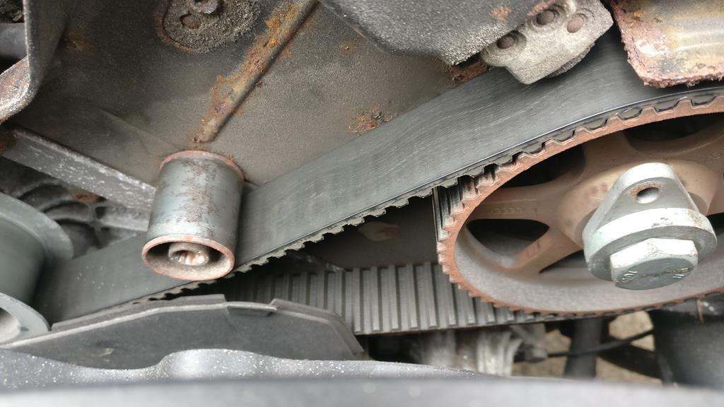

The timing belt is in good order and the tensioners are all good so it hasn't done many miles since this was done. We'll fit a new kit anyway of course

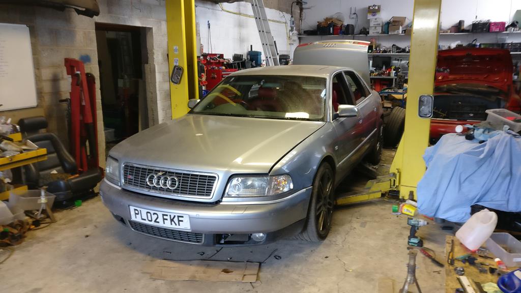

In a rather unexpected twist, Bert's barn-find FE is now my barn-find FE
I snuck it on to the lift after Ricky's went home so I could get a really good look at it, and I made 'the list':
Its a biiig list After discussion with Bert about how much it was going to take just to make this in to a usable car again, not even considering the cosmetics, we concluded that it simply is not economically viable in any way - much the same as the discussion in the original thread. If this was bought by someone who wanted an avus and red FE, who could do the work themselves, and who was prepared to spend more time and money on it than 'market value' because they planned to keep it, then this would be a viable project. But, as a 'fix and flip' it just doesn't work.
The sound financial thing to do, per Ian's suggestion, would be to break it for parts, but thats not going to happen now I have hold of it Its an FE, and it must be saved, in part because I still feel guilty about the two I took apart already
So, Bert and I have come to a mutually acceptable agreement and I have taken ownership of it as a longer term resurrection. I have avus body parts from my dead one (which is in an even worse state than this one as it doesn't have an engine or gearbox), so that one will be fully dismantled now to save this one, and I will use my stock of spares as necessary (or at least what is left after the Murple disaster) to rebuild it to a decent state whence it will be sold on. Alternatively, if anyone wants to take it on as the resurrection progresses I'm open to discussion. I'm not going to make a profit on it but I am going to save it, and we have Bert to thank for grabbing it in the first place
So, on to the inspection...

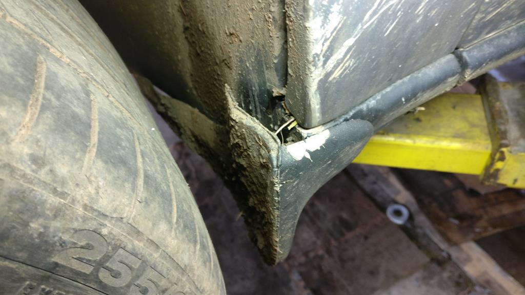

Nasty nasty mudflaps! These have got to go.

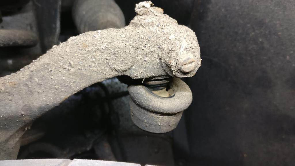

A repair has been attempted to the power steering lines using hydraulic compression fittings. It has not been successful.

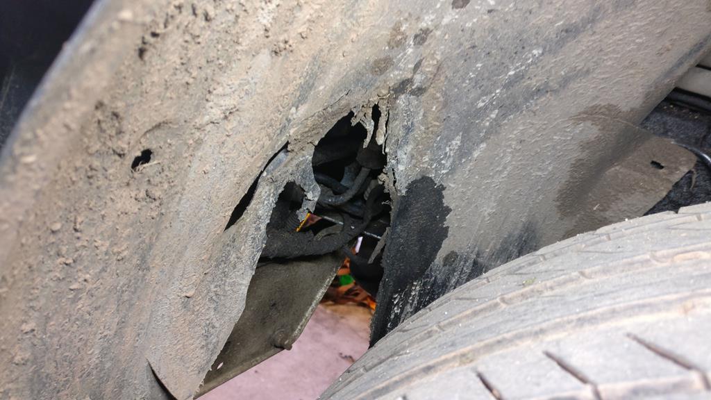

The undertray is missing so the arch liner has been rubbing against the tyre

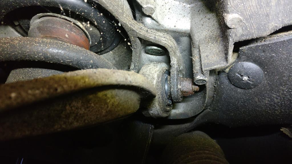

The leaking power steering fluid has sprayed up on to the upper arm bush and dissolved it! The inner sleeve and rubber are still bonded but have split from the outer portion of the rubber

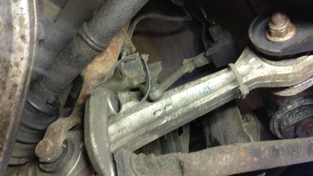

The headlight level sensor was attached with a cable tie

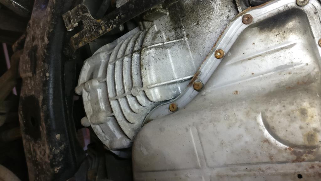

The gearbox has been refurbished at some stage as it has been both sandblasted and painted. Whoever did it painted the sump silver as well which is an odd move. I think its safe to assume it wasn't done by Mackies! The gearbox shifts nicely, but until I open it up I will treat it with the same suspicion I developed from the Murple's gearbox.

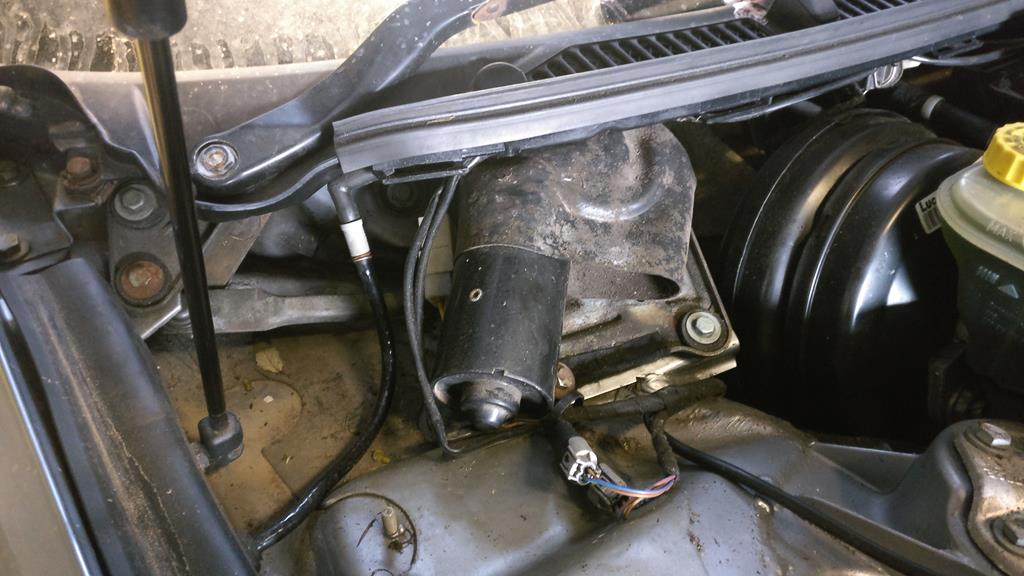

Someone has also perpetrated a slightly unorthodox repair to the wiper mechanism. This is not a D2 motor and isn't sitting in the correct place so I'm not sure what's going on here. The movement of the wipers could be described as 'glacial' so I suspect the mechanism is almost seized which burned out the original motor. This replacement motor is interesting though because (if fitted properly) it might be a handy alternative to the original.
