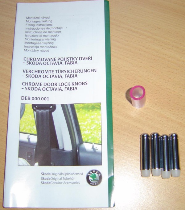

VAG also supplies 4 chrome pins in one kit + instruction. Part number is DEB 000 001. Yes it looks strange, but this is actual part number. This 4 pins kit cost below 10 pounds and is orderable from Skoda or Volkswagen dealers. Not sure you can order those from Audi.

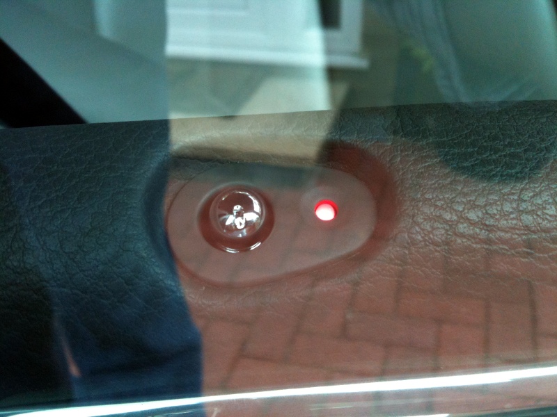

OK, received DEB 000 001 kit from Skoda today and installed chrome pins on my beloved A8 D2 2002
First of, I confirm these Skoda pins have the same geometry and the same attachment system as original Audi A8 D2 2002 pins The only difference is design of upper part of the pin. Chrome pin has a dome shape tip as shown on photographs. Original pin has a flat tip.
Installation manual that comes with the kit is self explanatory -- see picture at the beginning of the thread. You don't need to remove door cards.
Additional tips:
1. I would advice to lower window glass to allow more working space and work from outside of the car through window opening.
2. With pliers and supplied cylindrical plastic piece of pipe (it is used to avoid scratching) rotate the pin 180 degrees any direction.
3. After this operation you'll notice that pin doesn’t sit firmly in place when you move or shake it a bit with your fingers. This indicates that you can now lift/extract the pin up. Again, do it with pliers and cylindrical plastic tool. Don’t be afraid to apply some force at this moment -- there is nothing to break in lock mechanism, but please don't sue me if you started to extract it before it actually reached 180 degree position.
4. When you finished removing the first pin take your time to observe the way it was attached to steel threaded rod. It'll become 100% clear how to install the pin back in place (picture 5 in installation manual).
5. Take chrome pin. Put into desired depth. Rotate new pin 180% with pliers and cylindrical plastic tool as indicated by arrow in the manual. Be careful at this point, as new pin doesn’t have any thread inside it yet, so this operation require some force. Look that you don't damage pin with pliers as cylindrical plastic tool can get worn quickly if your pliers have sharp "teeth".
6. Please notice that by design the pin attachment allows you to install pins at different depths. It took me some time to remove/install new pins to perfectly align all of them at my favorite depth, so that they all "park" at the same perfect depth when you lock the car. I think I removed and installed each pin at least 3 or 4 times to get perfect alignment, but it'll take you less time if you're not that crazy.
During this final exercise I scratched two chrome pins, as my cylindrical plastic tool got worn. I'll be ordering another DEB 000 001 kit from Skoda on Monday to change two scratched pins. I would advice to order 2 kits from the beginning just in case you damage some pins (two kits will cost 8 x 2 = 16 UK pounds). Also, it may be a good idea to apply some silicone spray or some grease on metal threaded rods to reduce traction, but I didn't do that.
The whole job took about 40 minutes, which is less than it took to make pictures, to come to computer, and to prepare this write up.
@jayzee: You're right, chrome pins are better visible from distance for checking if car is locked or unlocked and add that distinctive look.

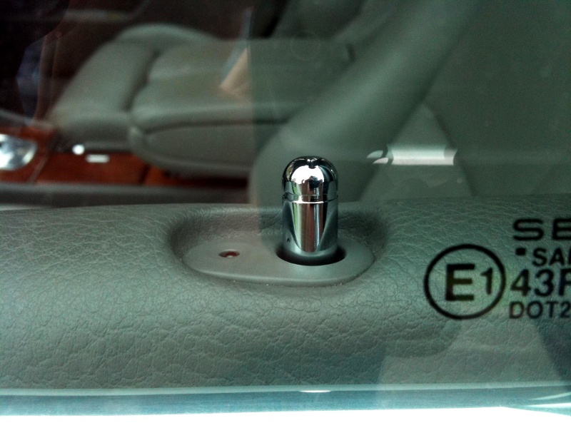

A couple of pictures of installed chrome pin at locked and unlocked position are below (umm... my favorite depth ):

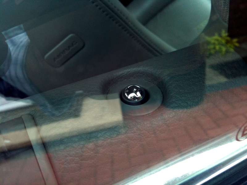

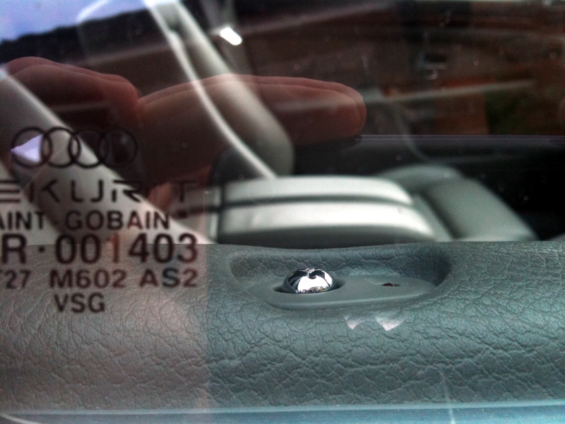

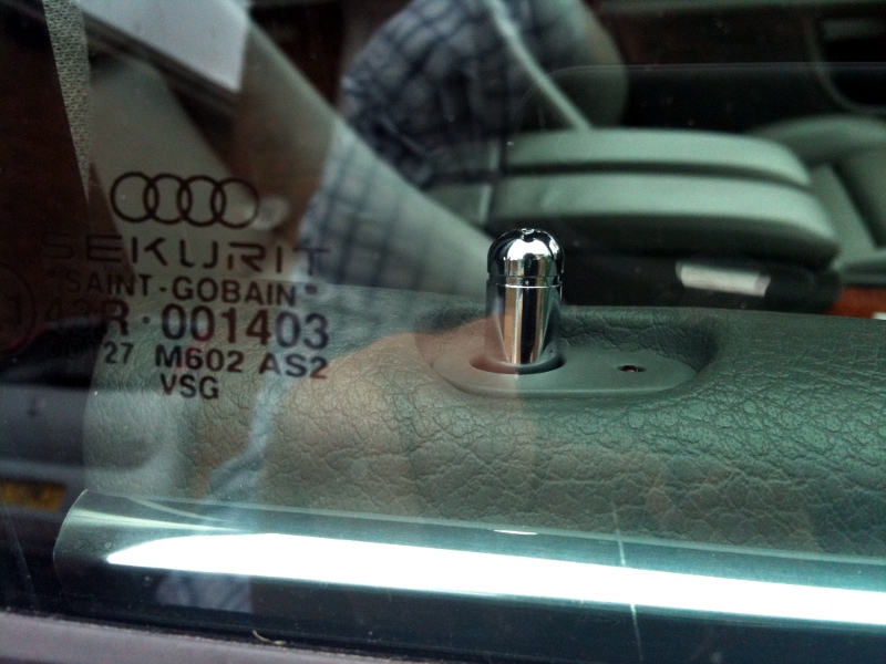

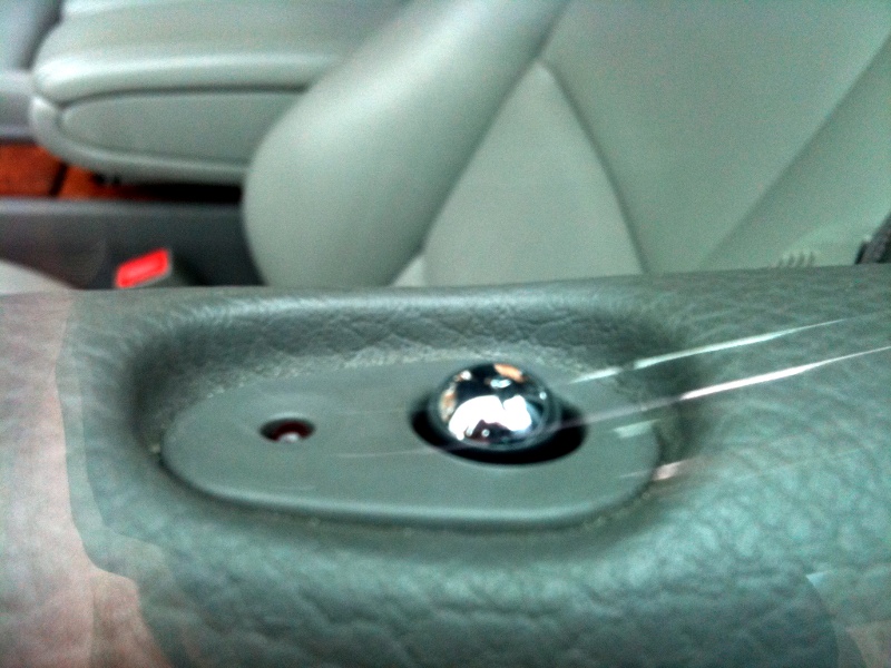

More pictures below for undecided minority
On some of them inner and outer chrome strips can be seen
...Yes I have iPhone 3GS and yes it makes sh*tty pictures...
