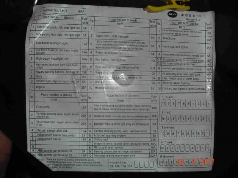

Default Fuses
I don't have fuse assignment sticker in car so I was looking for it on the net. Found a picture of it and thought I should post it here in case somebody is in the same boat as me without a sticker.
