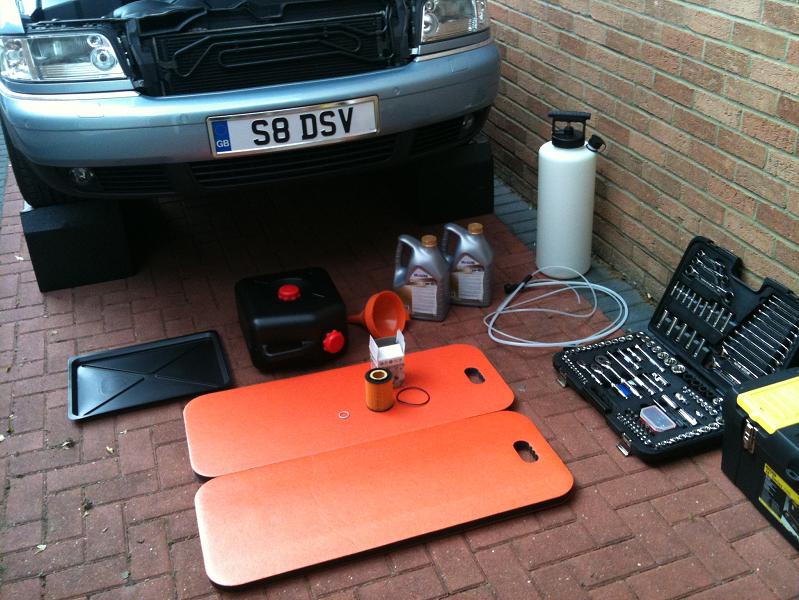

Here's what I have:
1. Parts: New genuine Audi filter with rubber O-ring. New oil sump plug sealing washer. Don't have oil filter plug sealing washer. Not sure if this required to be changed every time. I don't write here part numbers since they can be different for different V8 petrol engines.
2. 3 x 5L bottles of Mobil one 0W-40 New Life oil (VW 502 00 specification). Should be good to 2 oil changes (7.5L per change?)
3. Pela Pro 14L Marine Oil extractor. Ben doesn't recommend to use extractor. ETKA recommends to use the extractor. Not sure I will use the extractor, but here it is: http://www.pelapumps.co.uk/default.aspx?a10page=pl14k
4. ~ 20 L canister for used oil
5. Relatively small tray from Halfords that they claim was designed to collect spilled oil. Looks a bit small for me.
6. Halfords torque wrench. Love that one.
7. Halfords 100 peice tool set with different wrenches.
8. This is absolutely cool one. Two piece 67 inch Race Ramps: http://www.raceramps.com Love them.
9. Paper towels and surgeon's gloves
10. Halfords mats to work under the car

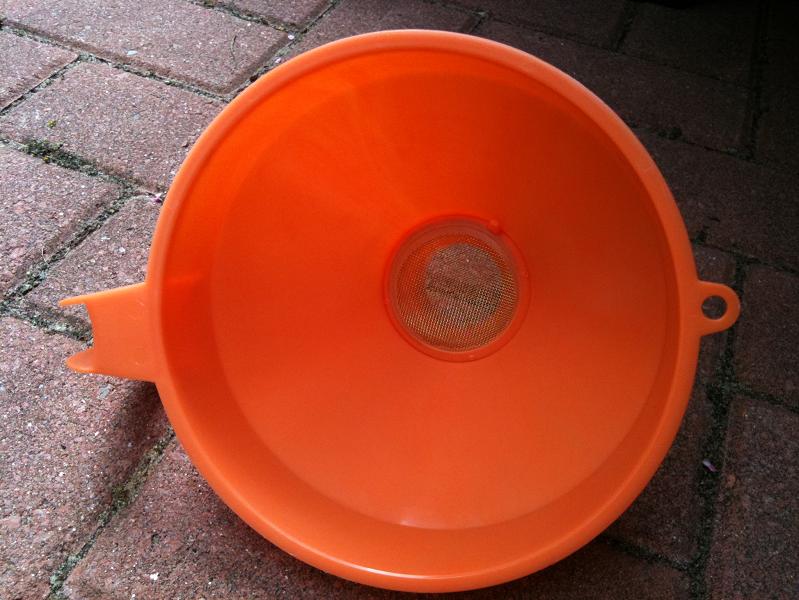

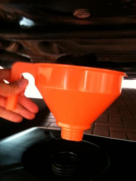

First picture:

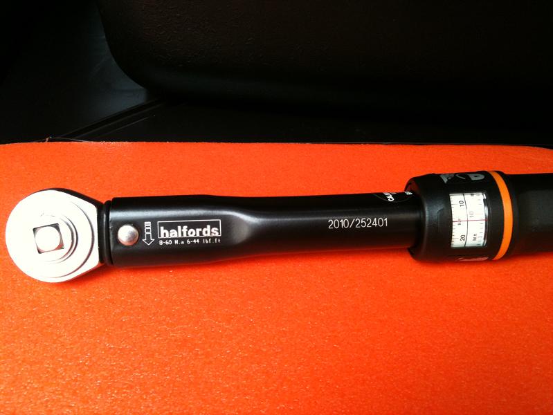

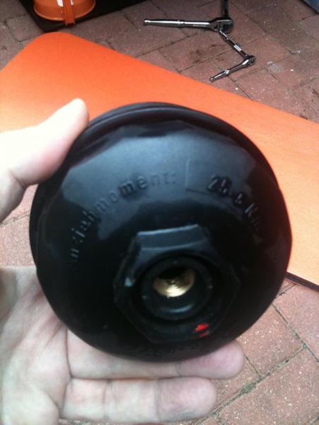

* Tightening torques from previous service were not correct. I don't know if it is important, but I've used correct torques for my engine: oil filter cover 25nm, oil drain plug to cover for oil filter housing 10nm, oil drain plug to sump 50nm.
* I've used modified Halfords funnel for my draining operations. I've cut bottom of the funnel, so it has now much wider hole. You need to do this because drain plug hole is about 1 inch wide. As soon as you open drain plug the stream will be 1 inch thick, so you need "high performance" funnel or you risk to have your used oil all around.
* Notice the funnel has a net in it. When you separate drain plug from the sump you can immediately throw the plug into the funnel and remove your fingers immediately. Net will catch the plug. This is convenient for several reasons: 1. less spillage; 2. oil is very hot, so the faster you throw the plug, the better for your fingers; 3. no risk for oil to run over your hand under your sleeves. SO, you just open plug and immediately throw it into the funnel. The net will catch it, so it doesn't fall into the canister with used oil.

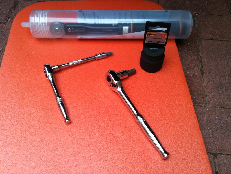

* You will need 36mm flat socket to remove the filter housing. These socket was not supplied with my Halfords set. Perhaps because it's too large. I've purchased that socket.

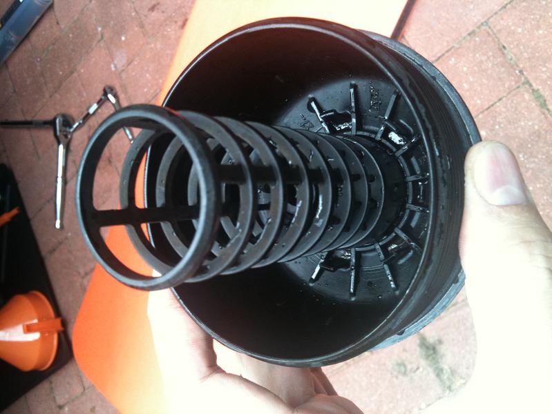

* My oil filter housing was VERY contaminated at the bottom. Thick oil sludge and even some sand! It seems guys at service don't bother cleaning bottom of oil filter housing. They just pop in a new filter and housing goes back into the car. It took me about an hour to clean it to 100% perfect condition with different solvents. This perhaps explains as to why cleaning operation is skipped if you change oil in garage -- 1 hour of work. When I change oil next time I'll check that area again. It is interesting if all that crap builds up there during lifespan of each new filter was or it was there because cleaning was consistently skipped during car life.

Some tools:
Plug ready to be removed. See modified funnel.
Some tools (see 36mm socket)
Oil filter housing (need 36mm socket to get it removed):
Oil filter housing after cleaning:

... the funnel net and torque wrench:
