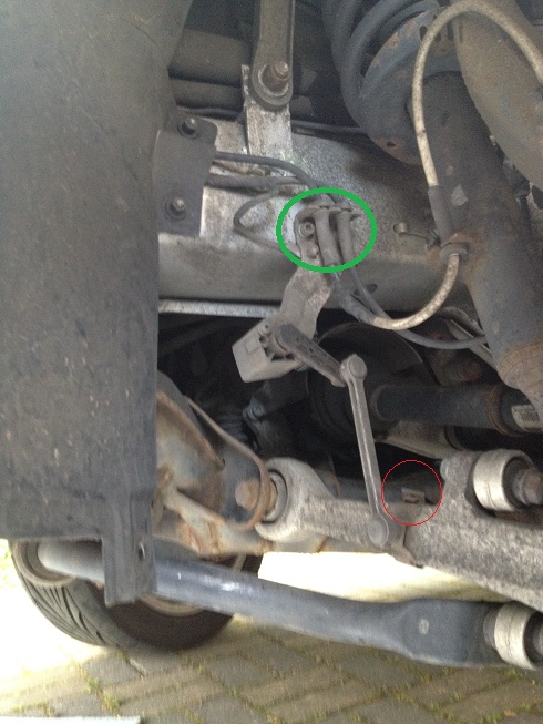

Heres a photo of the sensor in place on the front n/s suspension. The red circle is where the clip disconnects from the lower arm, the green circles are the two allen bolts that hold the bracket on.... Really easy change over
