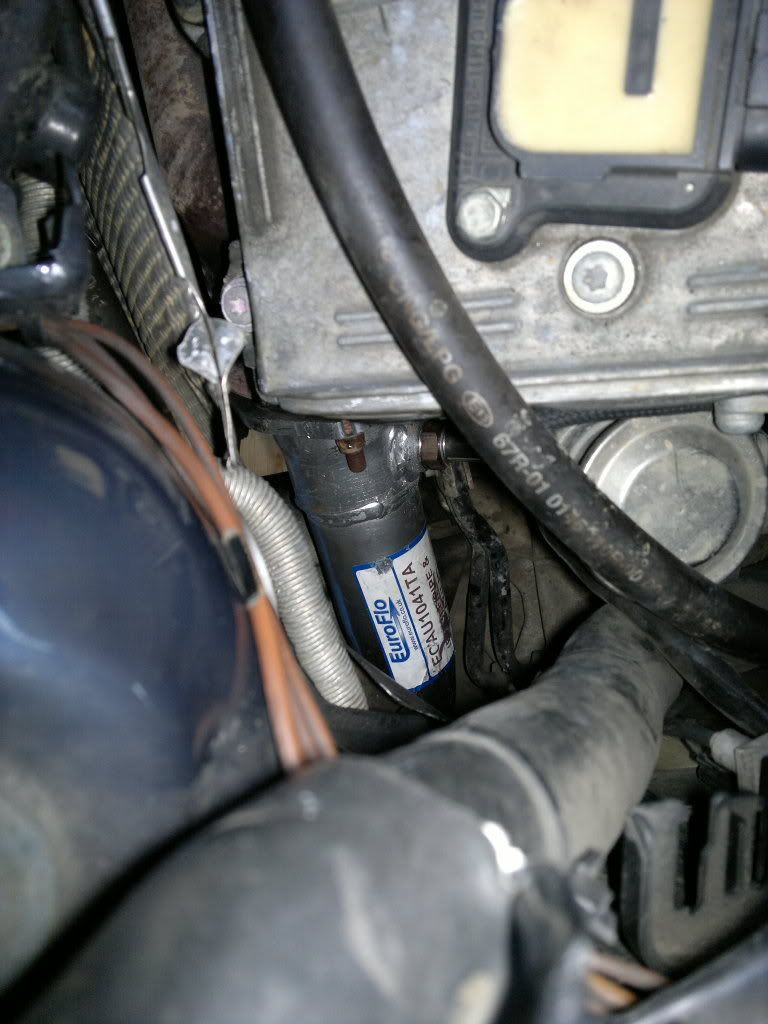

The upper nut isn't so easy to get to, in fact I couldn't even get a decent photo of it. However it is at the back of the LH cylinder head and I had to move the header tank out of the way to get to it, initially with a 12mm ring spanner and then a 3/8 drive socket.

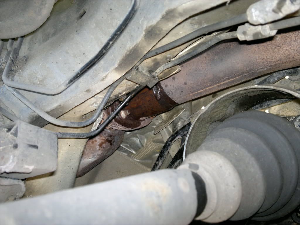

With all the fixings taken care of, the pipe can be removed. Its very tight at the top and you can just see the flared end of the pipe here:
and I could have done with the front of the car being higher in the air but in the end I managed to wiggle it free. Just needed to take care that the pre-cat lambda which is at the very top of the pipe didn't catch anything.

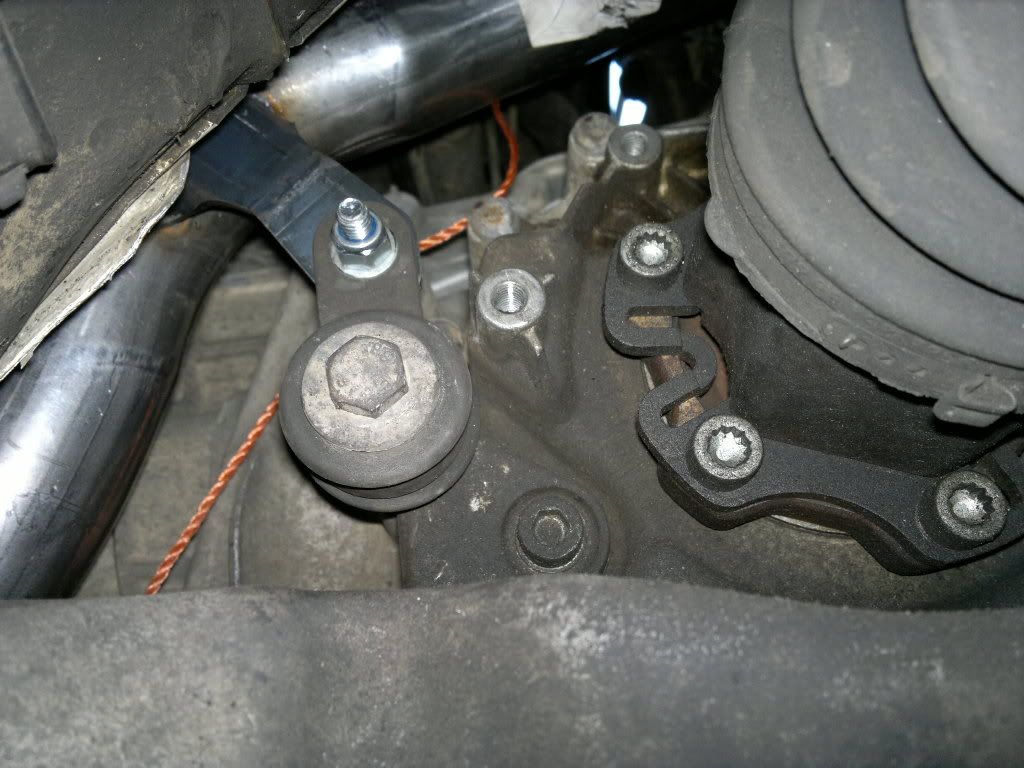

The drivers side was slightly more difficult to fit, I couldn't get the end of the pipe over the driveshaft area. You can see the end of the pipe (and lambda) here and in order to get the pipe in place, I removed the cast alloy shield that goes over the driveshaft and is held with 3 allen bolts. I don't know how I got the old pipe out with this in place so maybe the shape of the pipes were slightly different but eventually the new pipe was in place with a bit of persuasion.
This is the support bracket on the RHS - the orange string was tied onto the old lambda wiring when it was removed and was used the pull the new wiring back into position.

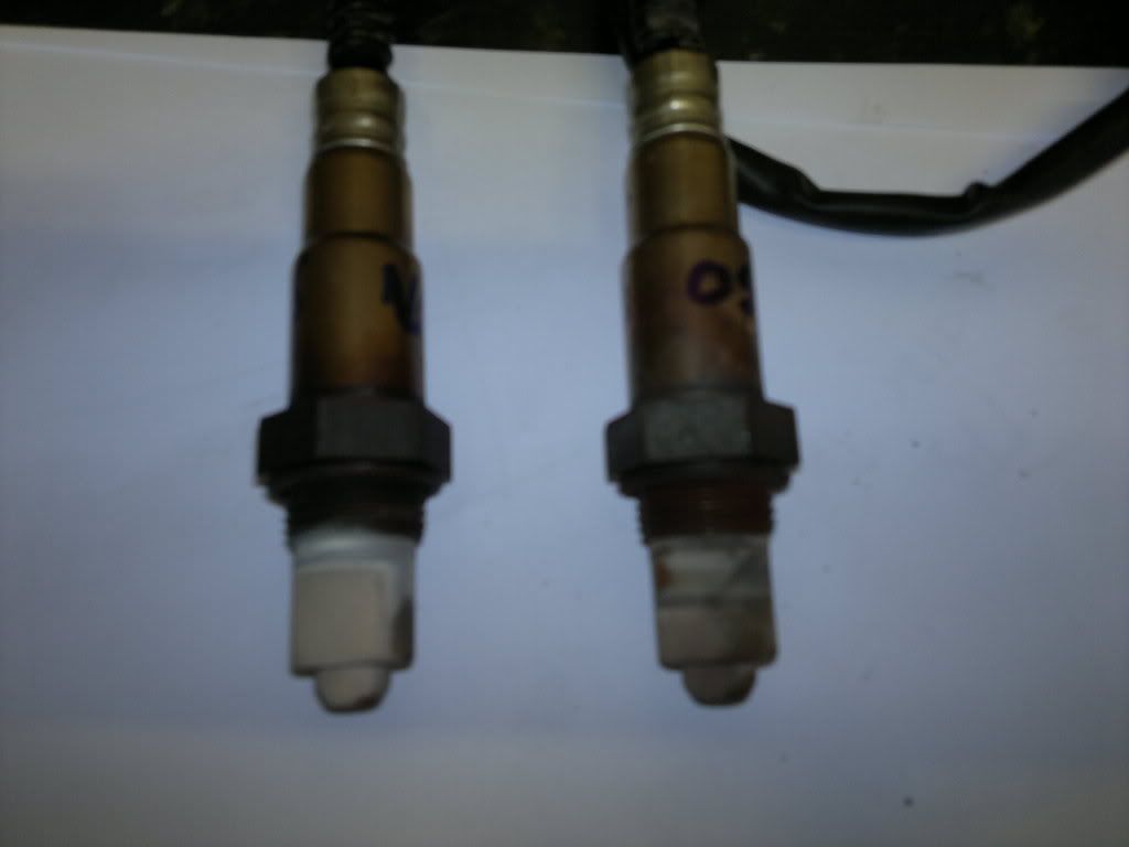

and here's the old pre-cat lambdas, LH on the left, RH on the right. The LH one rattled when shaken but I couldn't get anything to drop out so maybe it was fractured internally but still holding together. The RH cat had a VAG part number and stamp on it (still original?) whereas the LH one had no markings at all so maybe this was already replaced.
Slightly more deposit on the LH one which might be a sign of running rich, or maybe not. Either way they've been replaced and I'll see if there's any difference in how it runs over the next few weeks and report back any findings.
