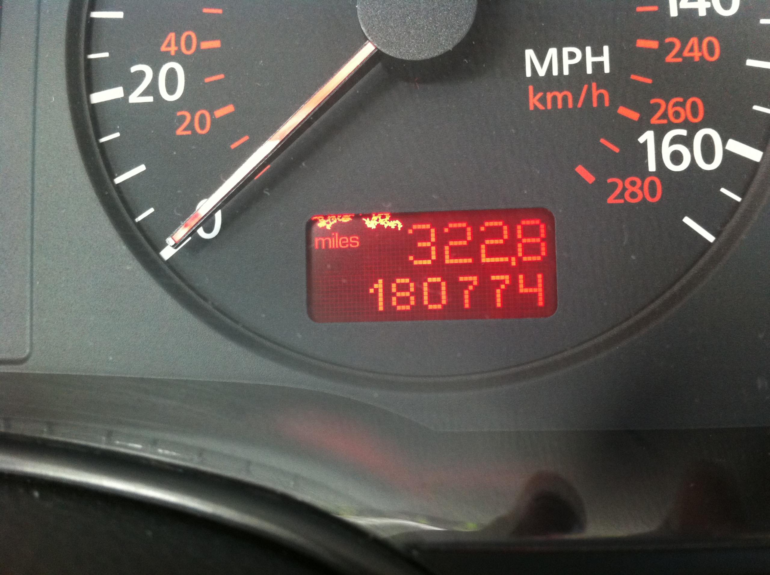

Attached to this post is picture of the current state of the LCD, if you look up at the display from a lower angle you can see the creep along the top of the LCD. I guess the only long term solution will be an LCD replacement or cluster.

The problem continues to get worse, the creeping on the second inner most end has worsened dramatically recently and is now heading down towards the hundreds of miles on the trip indicator.

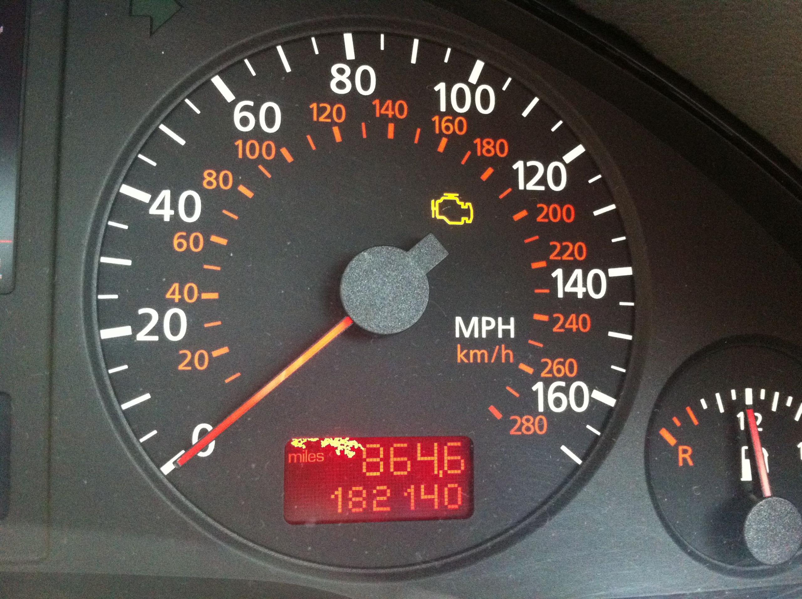

They do repair the A8 dash, but sadly when I contacted them about this before they cannot get the displays for the facelift cluster. Seems spares for this cluster are not available, and digging around on google I am coming to the same conclusion.
I may well have to take the plunge and buy a cheap donor cluster to dismantle to see what's what inside.
The picture below is how the display is now, with the damage just touching on the 8 in the 00's of miles on the trip. I know its going to get a lot worse since it shows no signs of stopping yet, and car has hardly covered any miles since this showed up.
