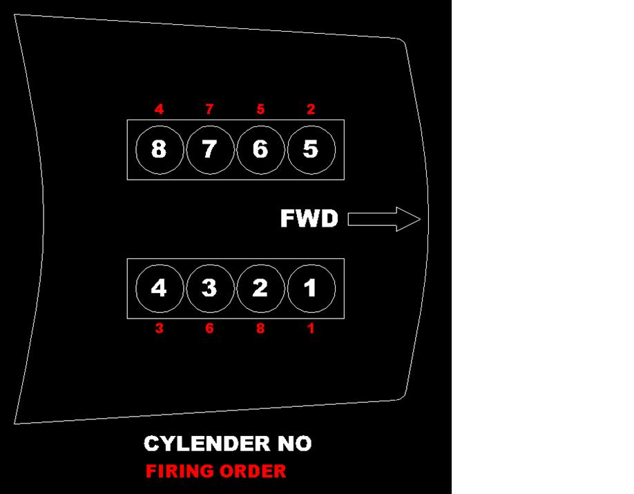

Possibly a daft Q, but which is no6 ?

It isn't a daft question....if you are looking at the engine from the front of the car....cylinder 6 is 2nd in on the right.....hope I got that right....maybe someone can confirm it for me.

Curious. 2nd in on the right from the front of the car would be the one that blew the plug. Brand new oem coil pack!

Old 22nd April 2013, 08:59 AM
This is right isn't it? If not let me know and i'll change it
