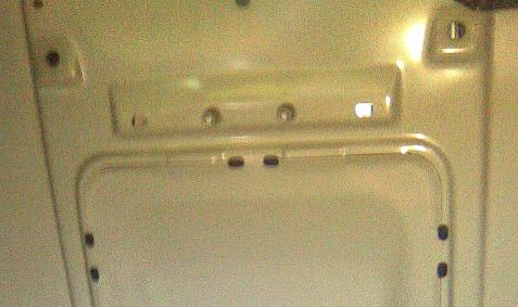

First raise the centre headrest and unclip the blind below it at its bottom edge, it just pulls off a couple of "poppers".
Then remove the fabric panel in the boot, just 6 clips though it was rather tight behind the offside bass speaker; I'll have to take the cover off that when refitting.
With the panel dropped down behind the armrest and the boot panel removed I checked for the relevant holes and poked an awl through to check alignment was good. This is the view from either side, you can see some holes are already clear. I'm guessing that the really big holes you can see through are for securing the fridge option.

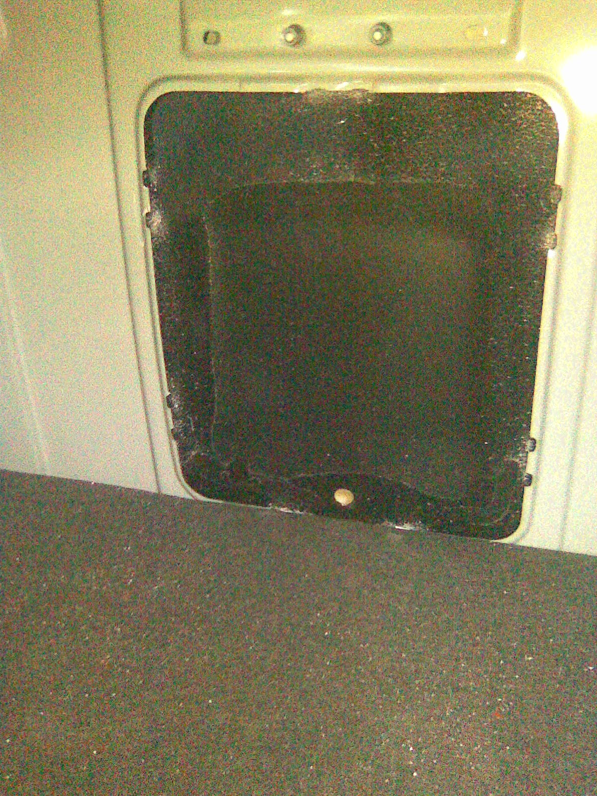

Old 5th October 2013, 04:42 PM
With a bit of pushing from the boot side and peeling from the cabin side that material came free except on the top edge, which I cut through with a Stanley knife.
At this point the hole is all ready to accept the hatch frame (I will probably go back later and smooth off the cut edges and maybe even paint them).
The pictures show the sticky fabric released but not cut and then the view through from the boot once the fabric has been cut away.

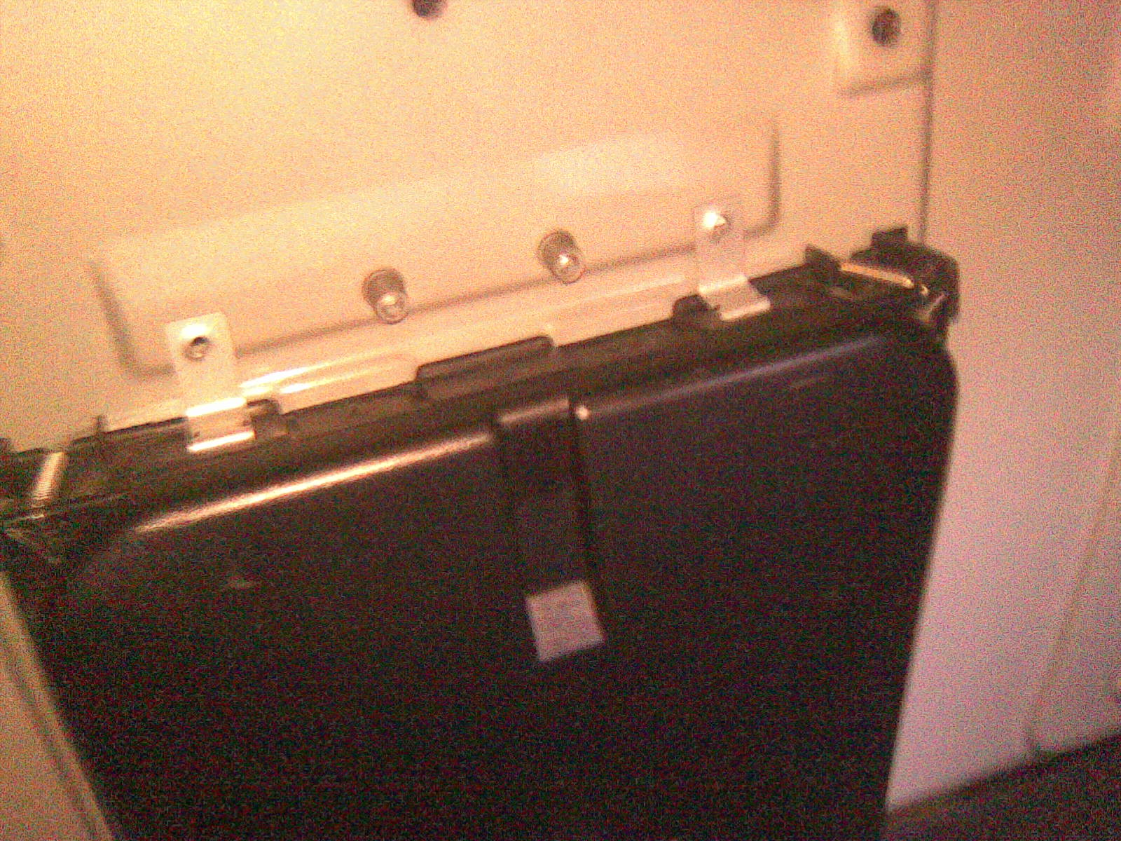

Old 5th October 2013, 04:47 PM
The next step is to clip in the 2 brackets at the top of the frame (without the screws!) then engage the plastic lugs at the bottom over the metal edge of the hole. You can do this quite easily from inside the car as the frame will go through the hole and has a handy handle on its "lid".
Note: You might want to fit the metal strip in the roof of the boot before doing this (I didn't) as I think it might be easier to do reaching through the hole than crawling into the boot!

Old 5th October 2013, 04:49 PM
Then, from inside the boot, push the top of the frame firmly into place so that the two plastic latches engage on the metal edge of the hole and the screw holes in the brackets align with the holes in the seat back panel.
Then go back into the cabin and fit the two screws to secure the frame. They go either side of the big bolts that retain the seat back.

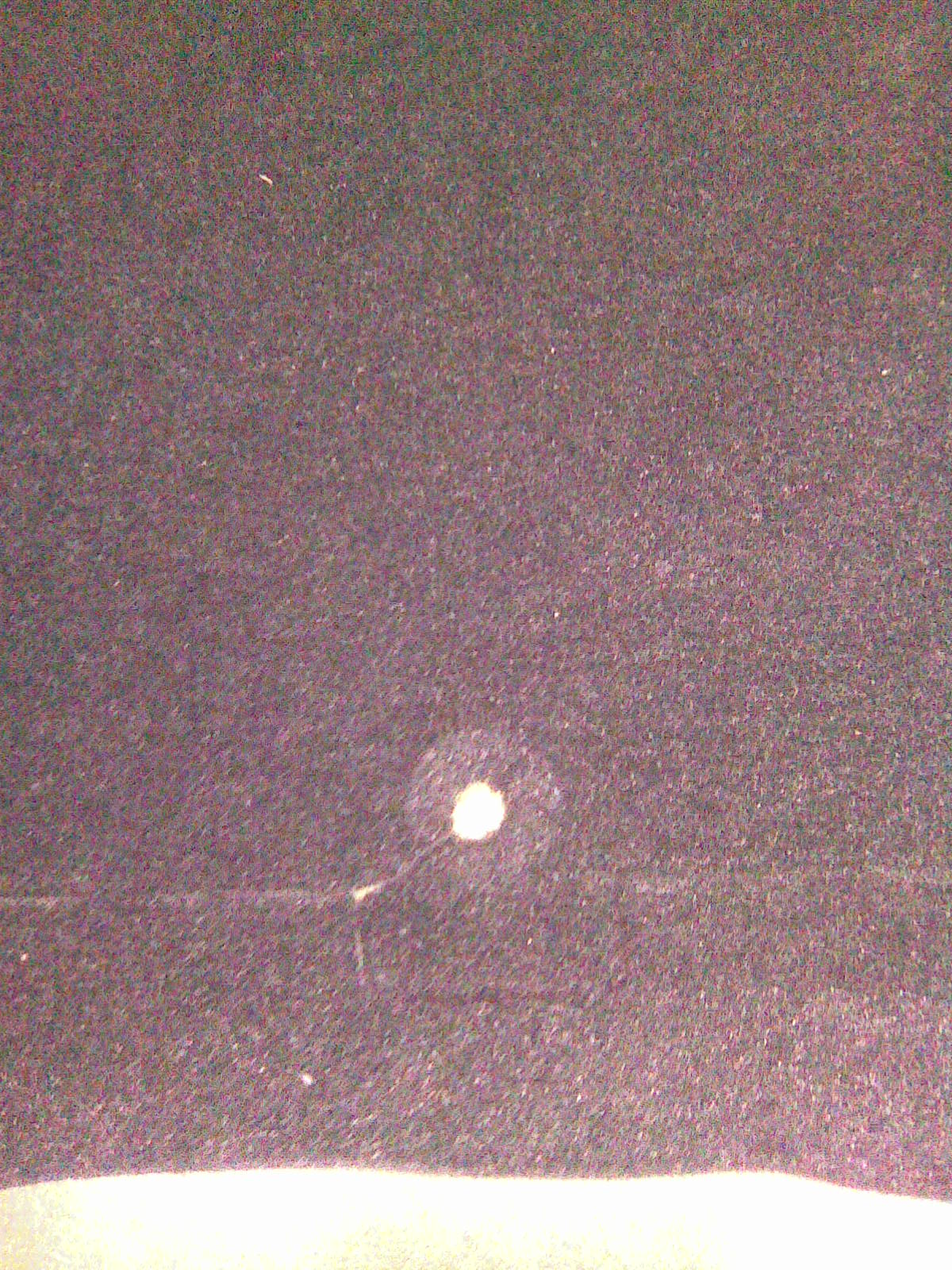

Old 5th October 2013, 05:00 PM
To cut the hole in the boot trim, lay it out boot side facing you and identify the bottom-centre clip hole and how it aligns with the clip head (may be slightly offset).
Lay the metal panel on top (either face up, it's L-R symmetrical) and check the alignment of the clip/hole; make sure it's square and mark round it.
IMPORTANT NOTE (see later post by Notorious). The basic "factory" dimensions for this hole are 240mm wide and 280mm tall, which is slightly larger (3-4mm all round) than the metal cutout.
I cut closely to the metal and it fitted fine (eventually) - see comment below about enlarging the hole by 30mm along its top edge - but you might want to try a "first fit" before doing that, or just cut outlines for the screws/brackets/bolts.
Cut out the hole carefully; I started from the clip hole using robust scissors.
I removed the hatch (2 screws and it pops off), fitted the fabric panel, then put the frame back over it on the basis of it being tighter and quieter that way.
All now done , though refitting the panel in the boot involves a lot of uncomfortable lying on your back inside the boot.
Some of the clips have to go through 2 layers of trim, so aligning them is rather tricky. And the offside speaker cover, which has 6 screws up into the underside of the parcel shelf, does have to come off to make a tidy job

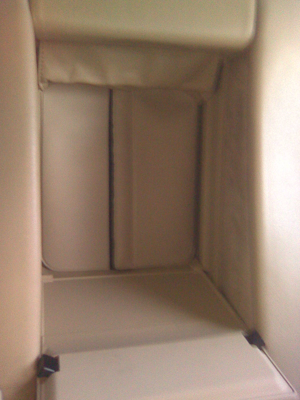

Tips:
At the bottom edge of the hole I put small bits of tape where the lugs of the frame clip over, to keep the metal and fabric together as it's a tight fit!
At the top of the hole I eventually cut off a strip of fabric 30mm wide, so that it was clear of the top edge, securing screws and bolts holding the seat in place.
This was to avoid the "sausage shaped" metal bulge above the hatch, shown in the 4th picture attached. All these obstructions stop it going flat and prevent the top edge of the frame latching into place and fitting tight. I may stick the offcut back later after shaping it around the frame, screws and bolts, though probably not as it's totally out of the way.....
Note that if you don't remove that section of material (or at least trim it round the bolts/screws) it will either stop you fitting the frame properly or block the hatch from opening fully, or maybe both. It does not fit well over the sausage-shaped bulge, especially with the seat bolts protruding, and interferes around the hinge area.
