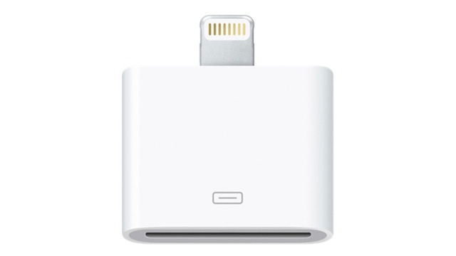

Please don't put S8 mirrors on it, it looks awesome in blue with the mirrors coloured the same. On the iPhone 5 issue, you can use an adaptor like this one to plug into the iPhone 4 lead for the ami until something bespoke is finally made by Audi -

Thanks Neil - I have one of them but it doesn't work for me. I'm quite surprised Audi haven't yet sorted out a proper cable for it yet
If you buy the "official" (and much more expensive) apple lighting to 30 pin adaptor then it should work with the AMI whereas cheaper ones don't
Thanks Neil - I'll have a go at that as you're right, mine's not an official one.
