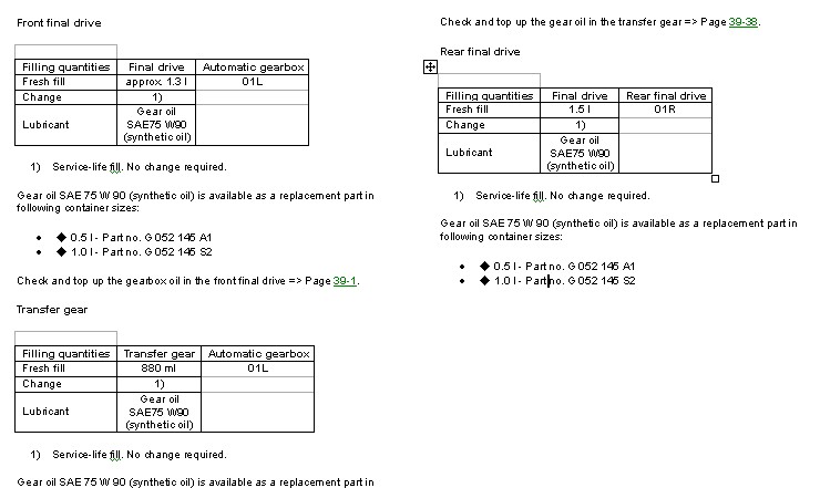

so the rear output seal need the same oil as the rear axle diff?

Straight from the good book....

cheers for clearing that up mike
