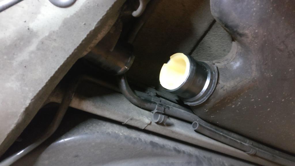

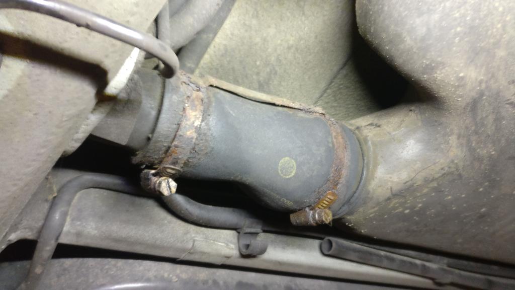

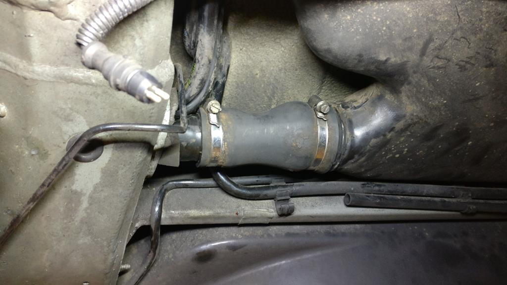

This crusty clamp connects the filler neck to the tank and disintegrated as soon as I touched it
http://forum.a8parts.co.uk/attachmen...1&d=1609176440
Coupler removed

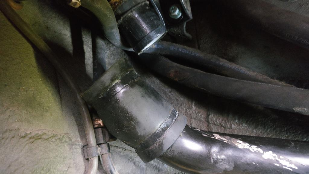

Slide this coupler down the filler neck and then the tube can be removed

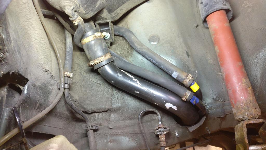

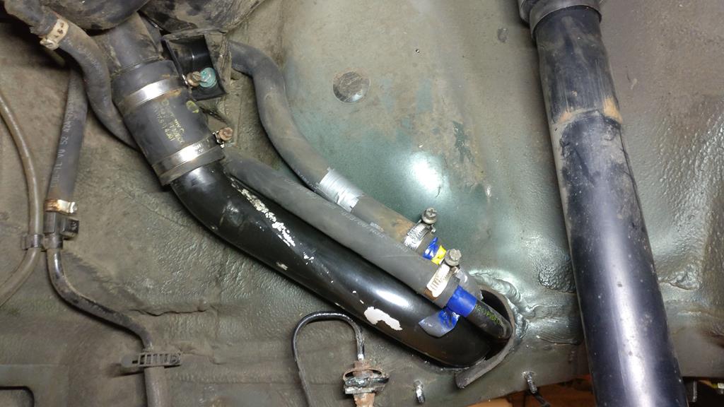

Mark and disconnect the vent hoses

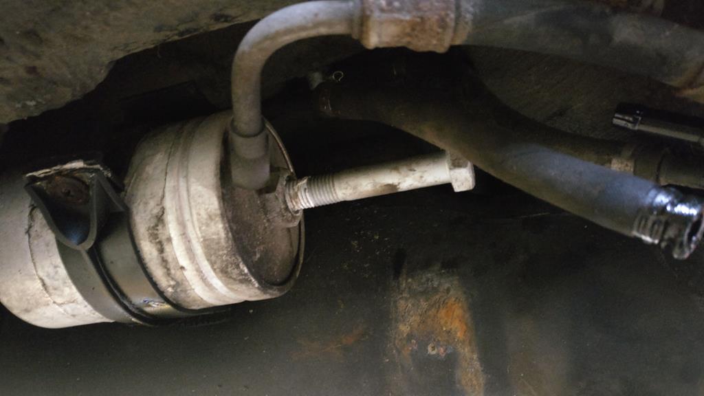

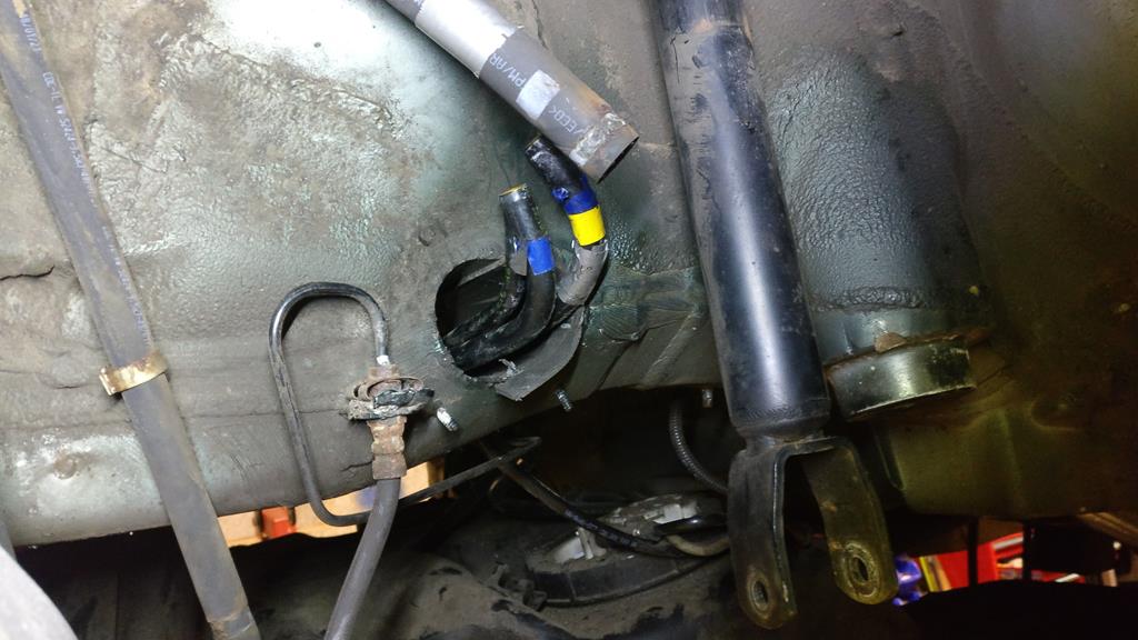

Disconnect the fuel feed and return. Random suspension bolt in the fuel filter to stop it dripping, although it still poured a load of fuel down my arm

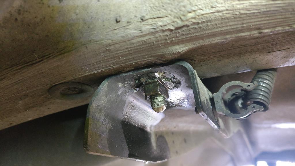

These nuts on the tank support are known to be problematic as the studs are just rivnuts and tend to come loose from the body before the nut comes loose from the stud, so I just slice the nut straight off.

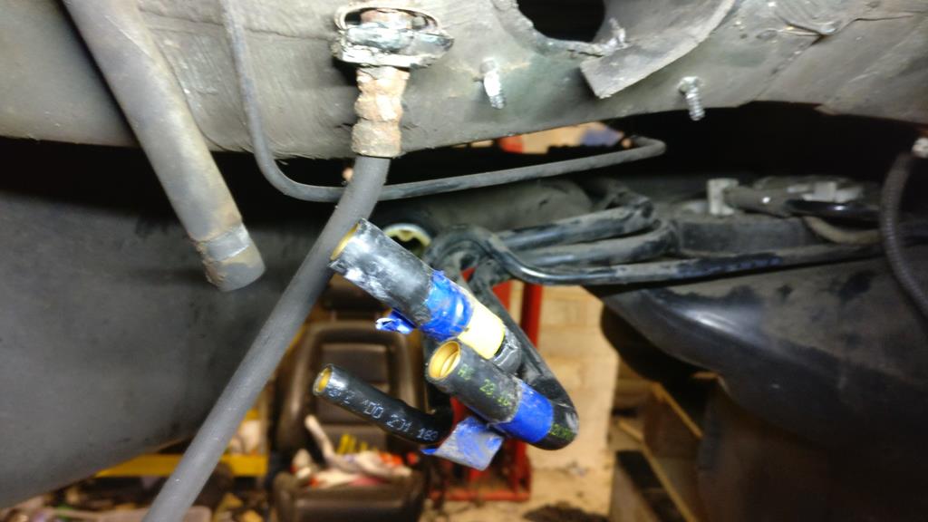

All these vent hoses have to be carefully pulled through the chassis leg without kinking them

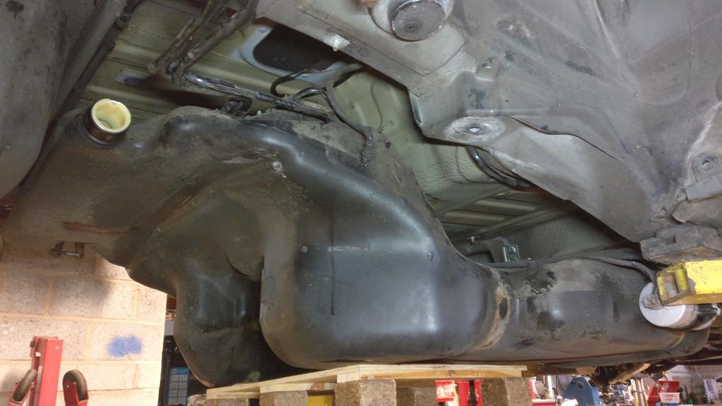

Tank out

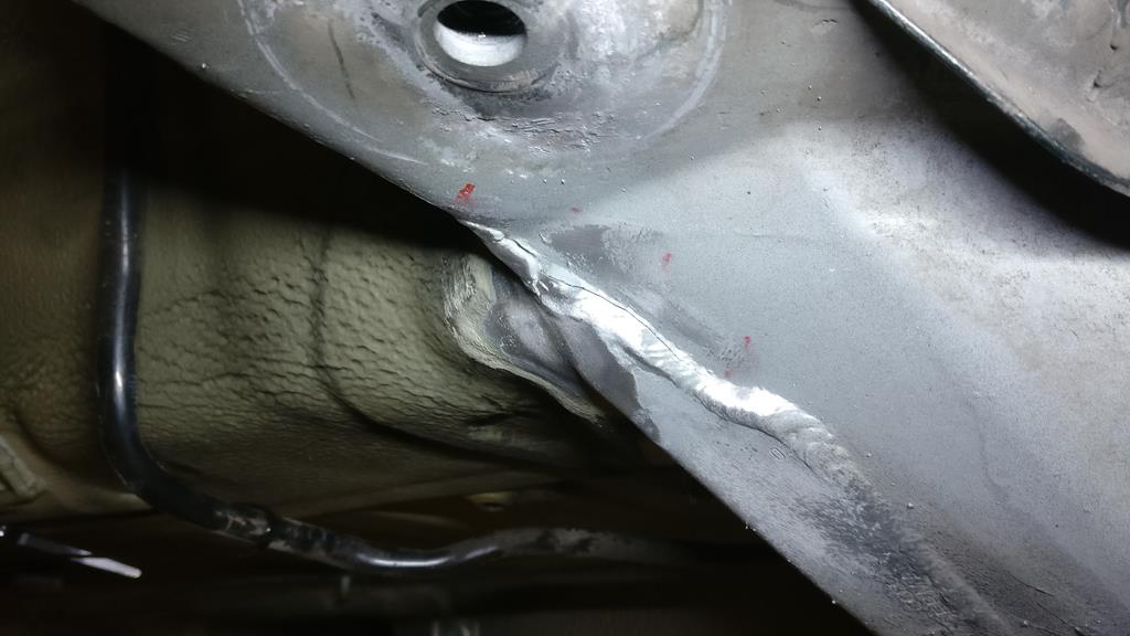

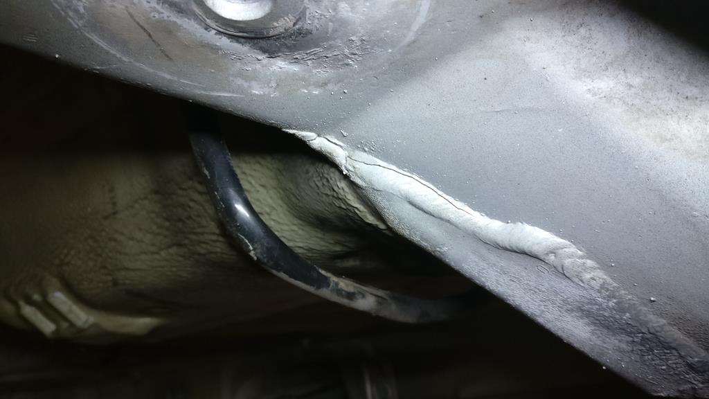

Once I got a closer look at the crack, I was glad I did remove the tank as it just curved round the edge slightly.

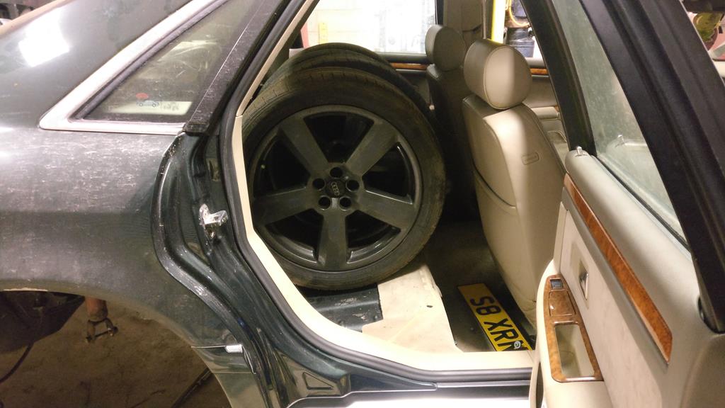

I pulled the back seat to a; make sure it didn't catch fire, and b; open up any body grommets to make sure the chassis leg is empty and not full of expanding foam like the sills. Good access inside the parts to be welded is essential in case anything does catch fire (wax is often a problem).
I replaced the weight of the back seat with wheels ;)

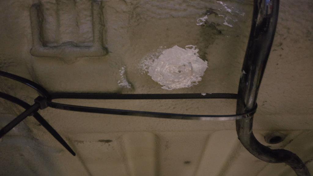

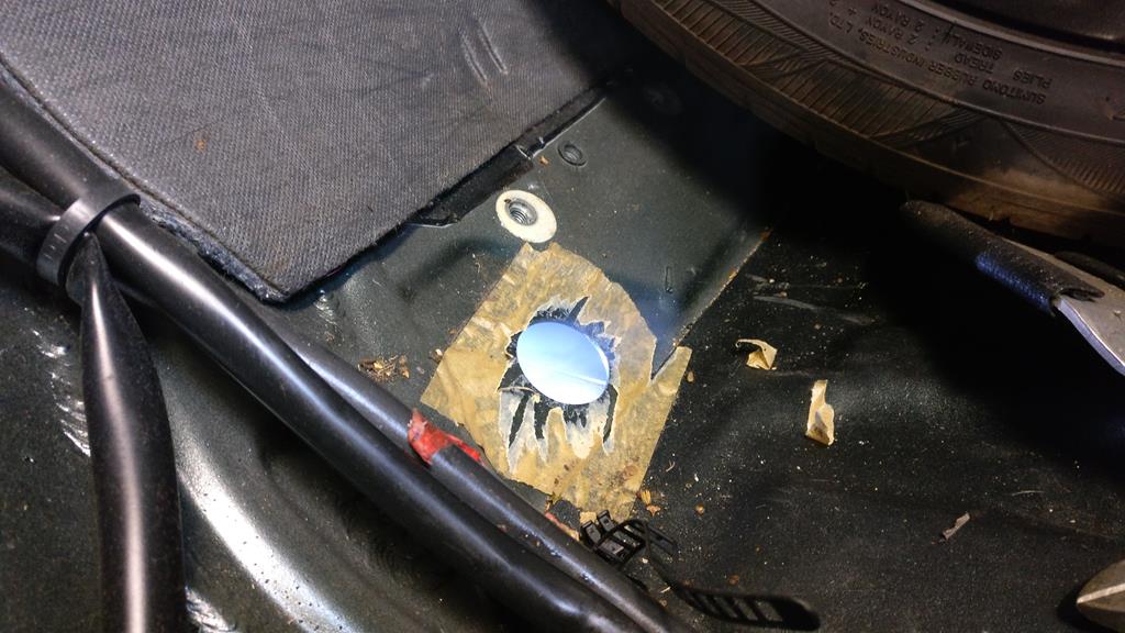

This taped-over hole was actually the best access to the void above the crack, such that it lit up from the welding arc :cool: I was standing on a ladder with the fire extinguisher while the welding was happening underneath. I knew when the crack was sealed up again as I could no longer see arc-light through the hole.

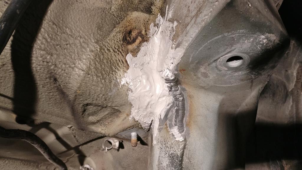

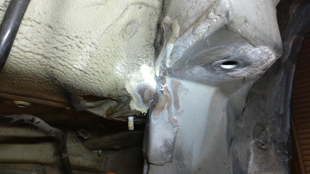

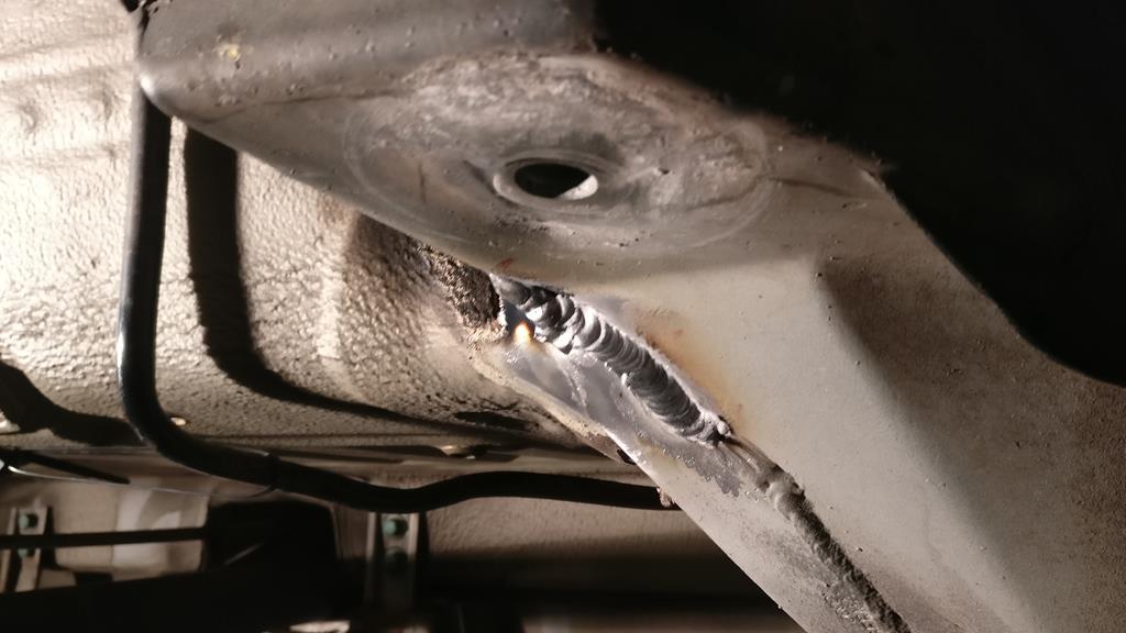

Craig the welder drilled holes at the end of the cracks to stop them propagating, then tig welded the crack back together
http://forum.a8parts.co.uk/attachmen...1&d=1609177779

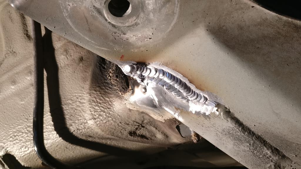

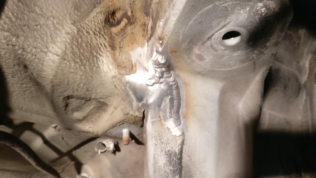

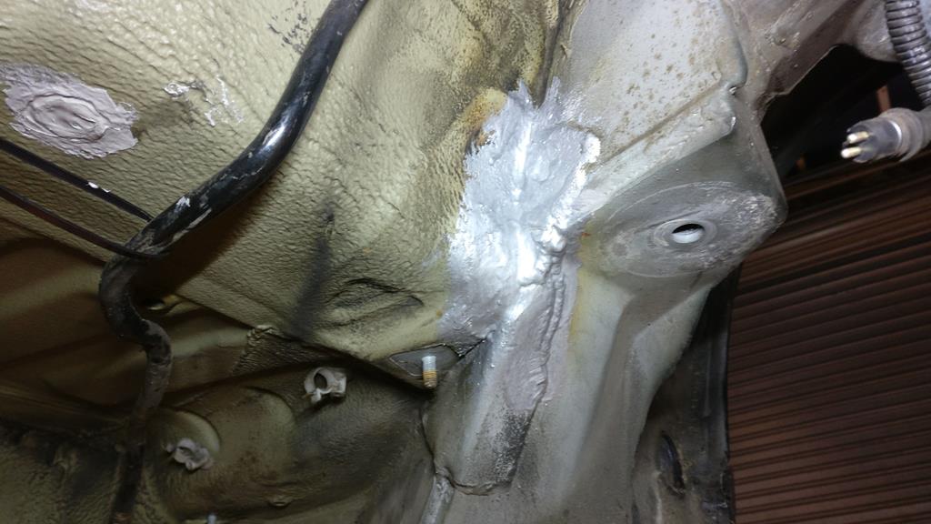

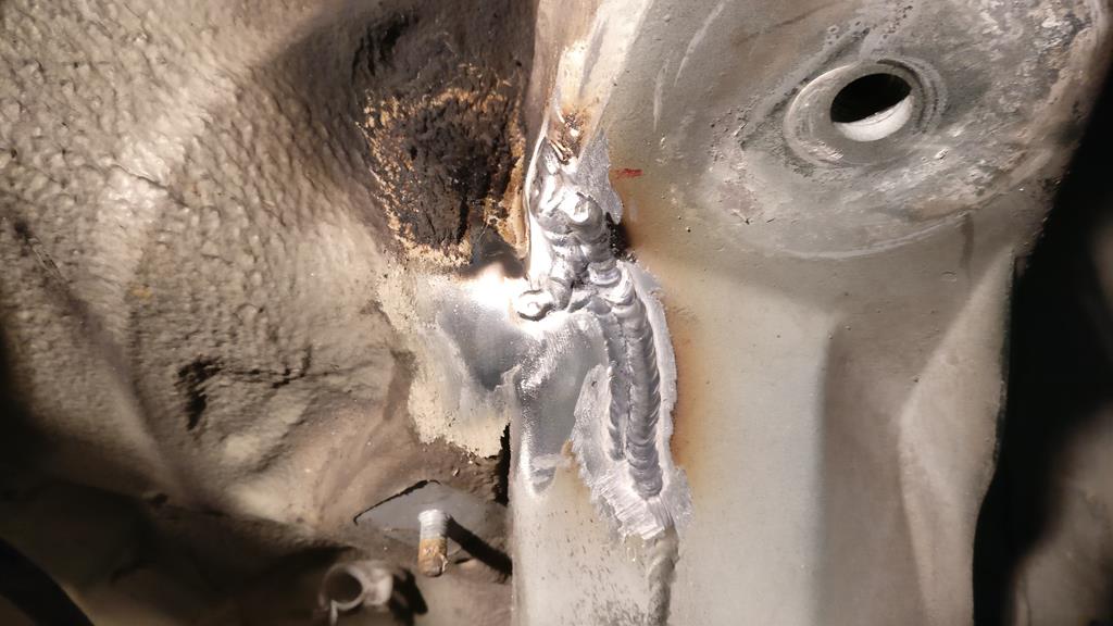

He then laid a second bead down next to the first for added strength. You can see from the bead going left from the main one where the crack had also gone sideways - this would have been impossible to get to if I had left the tank in. Apparently I didn't quite remove enough underseal though, so that got a little crispy!
Smoke mostly cleaned off and the whole area wiped down with thinnners
