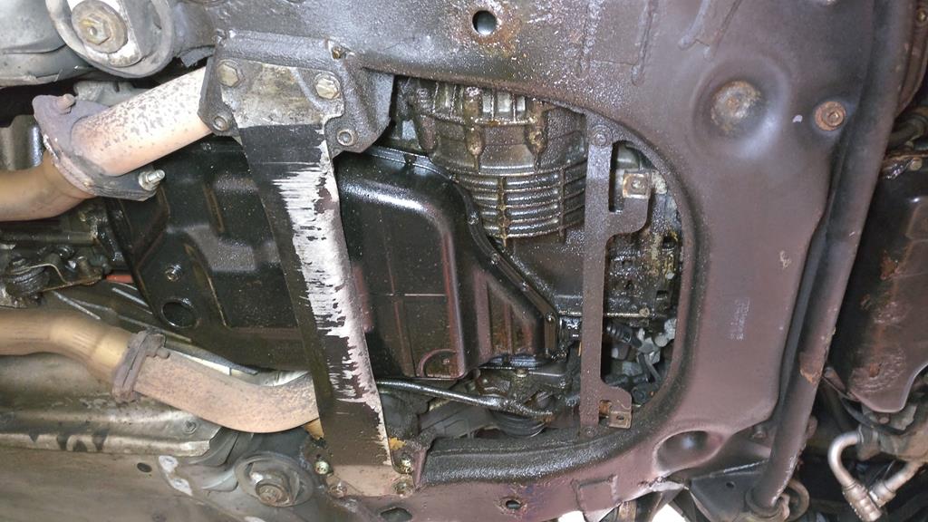

Getting it on the lift was no easy task with the rear end steering wherever it wanted! In the end I put it on forwards, since I would be mostly working on the rear end anyway.
It is leaking so much oil even BP is looking smug!

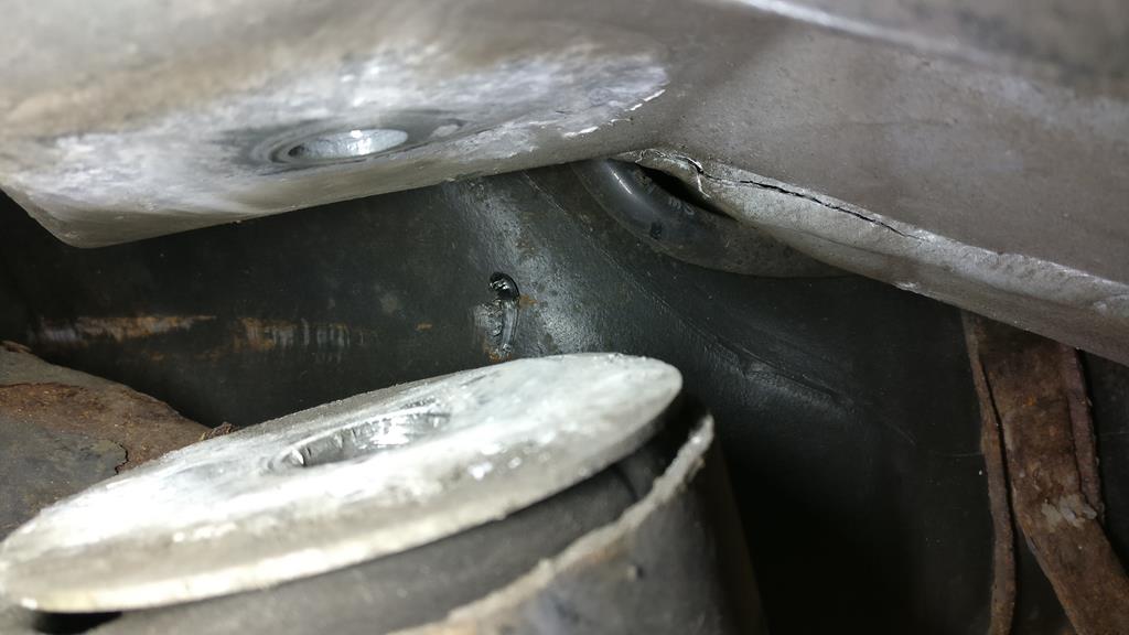

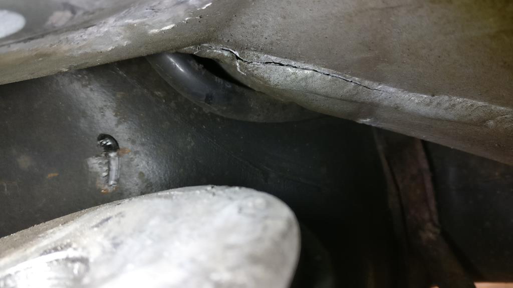

Uh-oh - a crack...

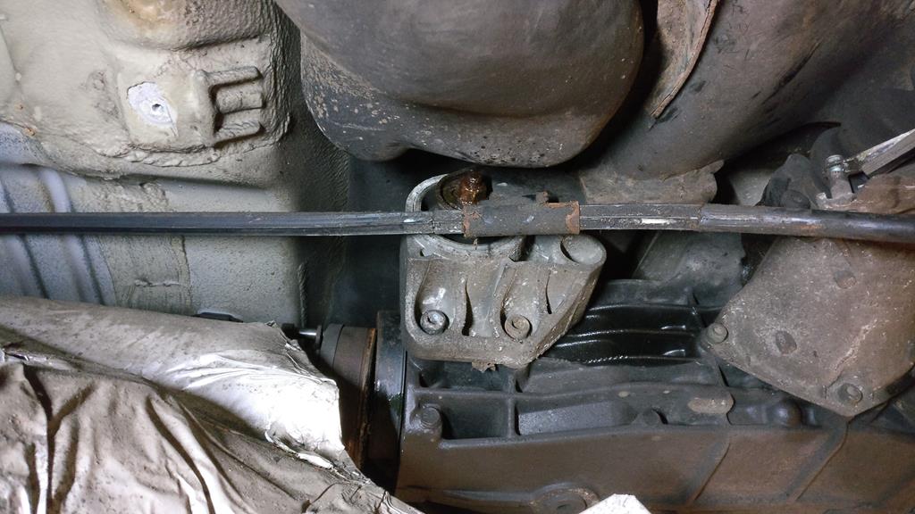

The rear subframe took the brunt of the impact and all the control arms are still intact. This is the bolt from the front right subframe bush!

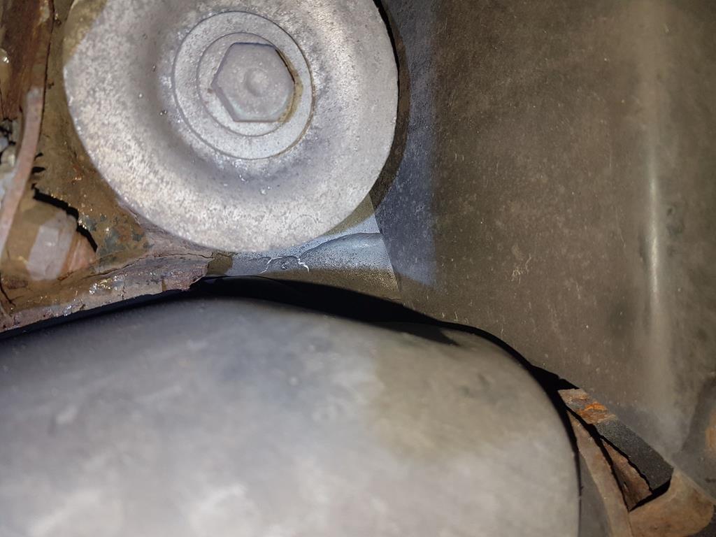

The crack is along a weld and is about 50mm long by 1mm wide. There is a scuff on the fuel tank as the subframe came in to contact with it, but the tank is still fine.

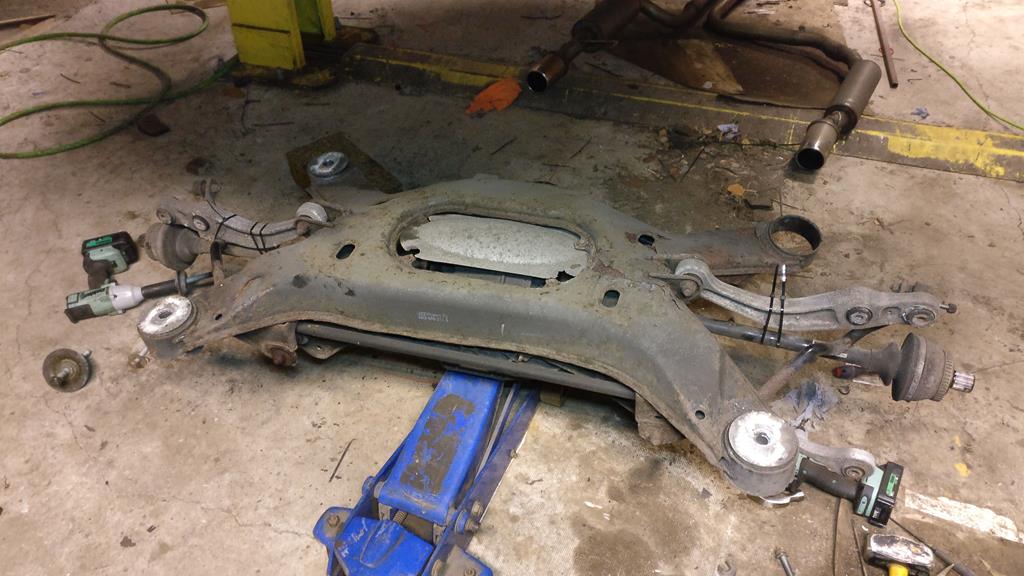

You can see here how bent the subframe is. There is a dent in the mounting pad just in front of the threaded boss which is what has caused the crack.

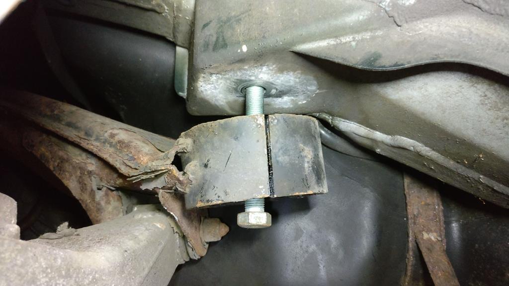

This bump in the subframe bush (from the solid boss where the bolt fits) is what caused the dent in the mounting pad.
A closer look at the crack. This would be trivial to tig weld, were it not for the plastic fuel tank right next to it!
The subframe folded like tinfoil

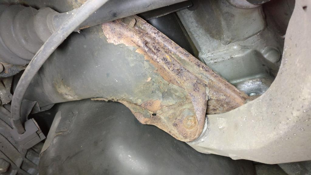

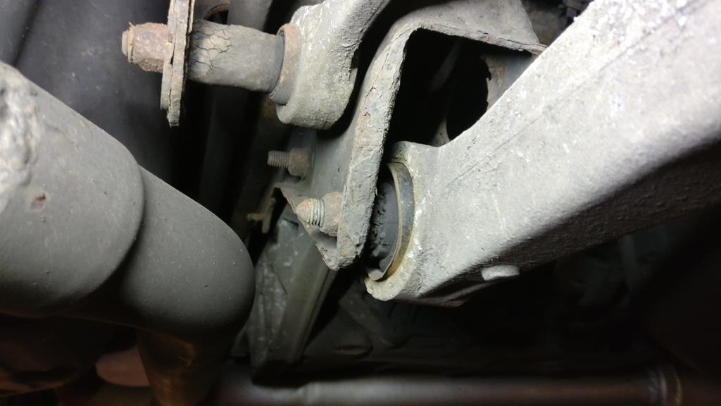

The front lower arm mount is distended and twisted
Since the subframe is dead anyway I cut the bush out to get a good look at the threaded boss before proceeding. The good news is that the boss is still perpendicular to the body and has not shifted. It measures within 2mm of my Murple which means I'm 99% sure this can be saved

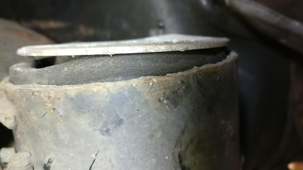

The lower rear bush tore out of the arm

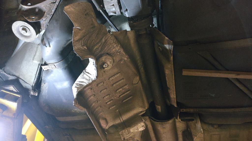

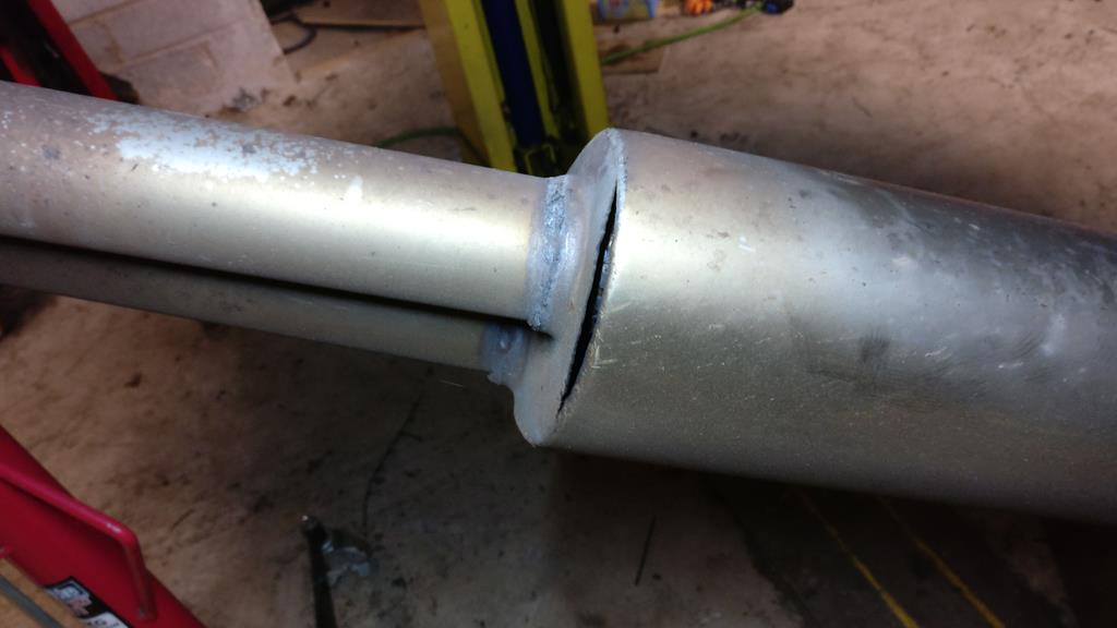

The funky dual exhaust was made in one single piece and was a bit of a bugger to remove
and unfortunately tore apart under its own weight Not sure what I'm going to do about this at the moment, but I'll probably cut it in to sections and join them with sleeve clamps, then weld this back together.

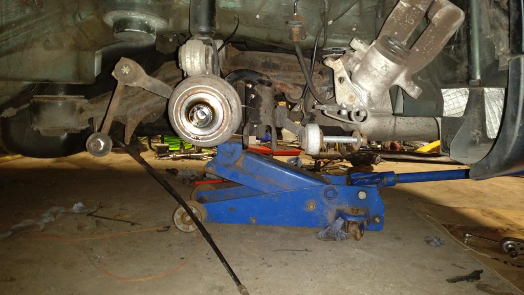

Stripped the suspension with the subframe in place as it's easier than on the floor since it doesn't move about

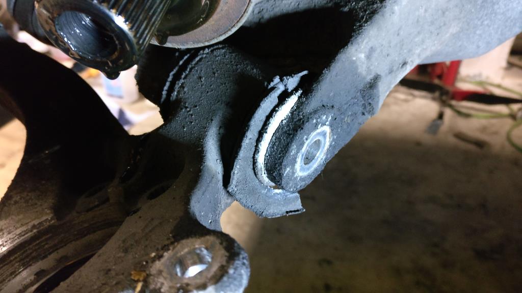

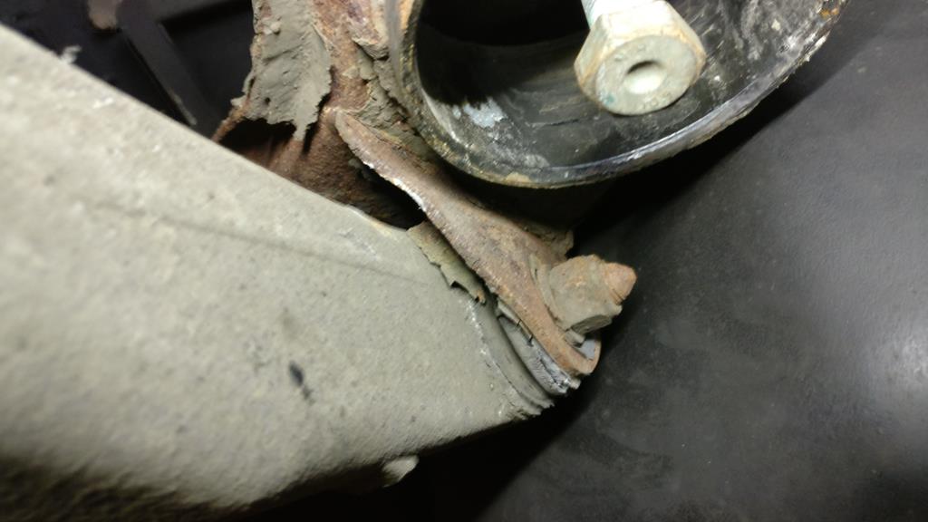

The lower arm front bush went splat! I've never seen a rubber bush squished out of shape like this before
I'm learning lots of useful things for when it comes to rear subframe removal and refurbishment, like the handbrake cable bracket is an arse to get to! Its bolted through the diff mount with both the heat shield and fuel tank in the way so the front of the subframe has to be lowered to gain access.

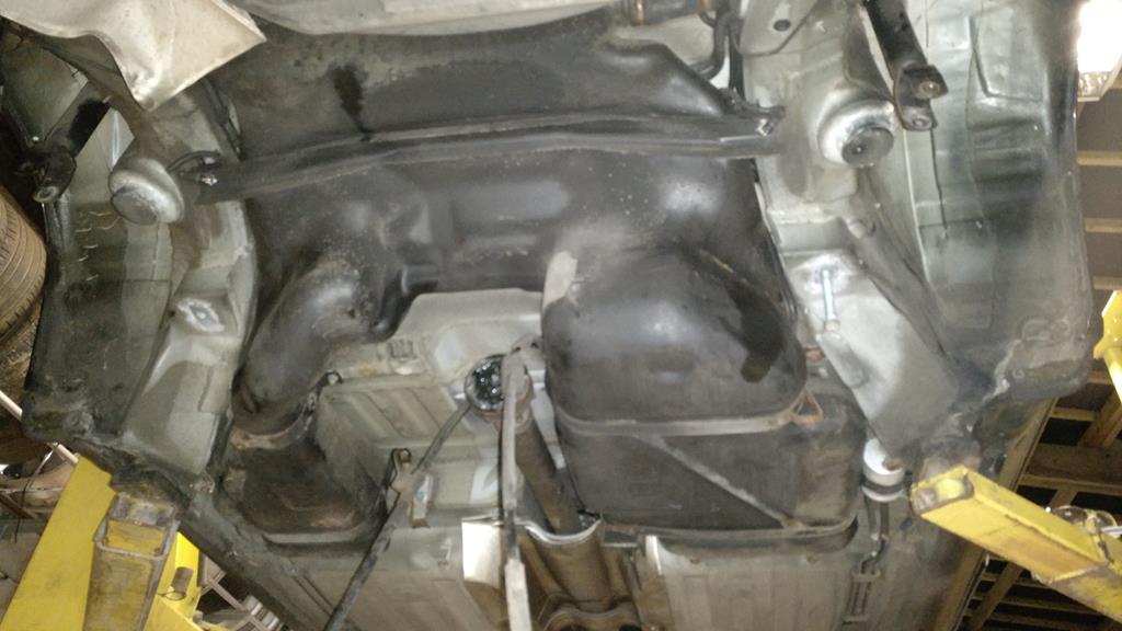

The fuel tank:

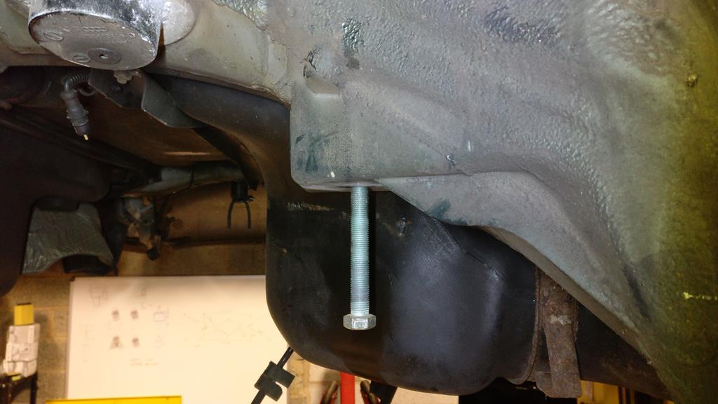

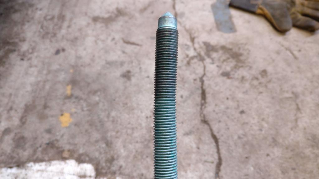

With a good bolt in place you can see that the mounting boss is still perpendicular
The plan is to temporarily replace the rear subframe and the right hand suspension components and also the front lower arms since the right front also took an impact, and then see how it responds to a wheel alignment. Assuming it lines up properly and confirms my measurements of the floorpan, I'll pull the subframe and the fuel tank so the crack can be welded.
If you're wondering why not just pull the tank now and get it done, two reasons: 1, I'd rather take the subframe off multiple times than take the tank off even once! 2, my tig guy isn't available until January and I want to know if it can be fixed before then

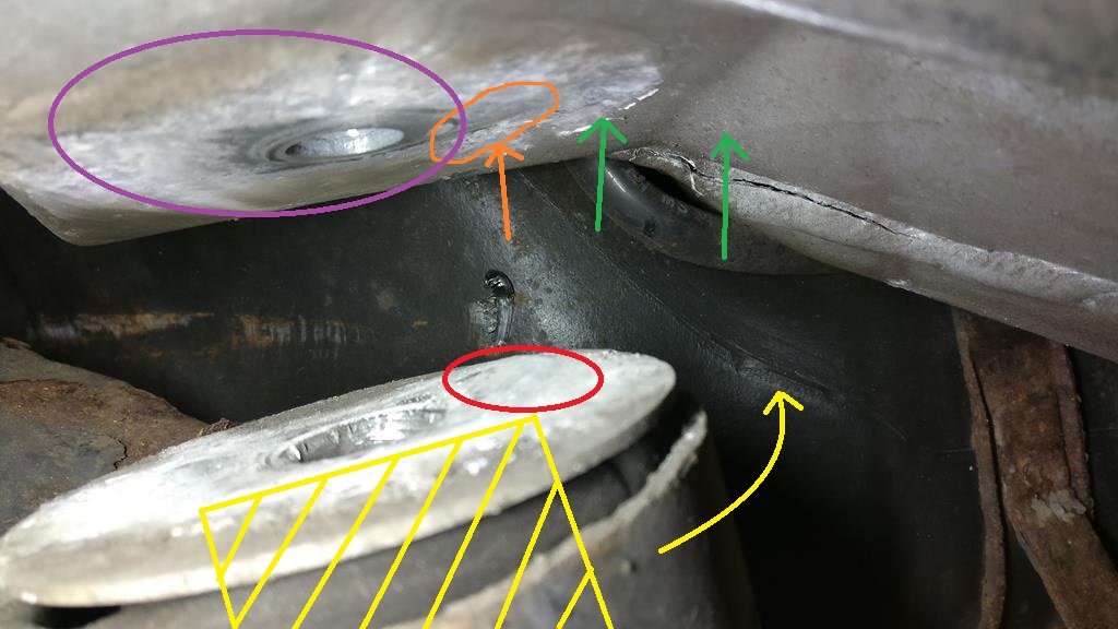

Old 16th December 2020, 12:36 PM
I think the S8 won that battle then.
Its impossible to see any damage at all at the front, other than the wheel being in the wrong place. The subframe had shifted but thats not the extent of it, hence changing all four control arms as a first step as the bush in the right lower rear is looking a bit squished. All the subframe bolts are in the right place so if control arms don't correct it then a replacement front subframe is also in order, but we'll have to wait and see on that.
The damage to the body at the rear is pretty superficial in the end as the hard points are all in the same place. This is what happened:
As the subframe moved forward, rotating around the bolt (yellow arrow) the solid block in the bush (yellow hash) ran out of travel and started pushing through the upper bush face (red circle).
This movement pushed on the subframe mounting pad, moving it upward (orange). As the cast aluminium moved, it was constrained by the threaded boss (purple) which is a very solid chunk of stuff. The energy was therefore imparted to the area in front of the boss, which moved upward slightly (green arrows) and cracked the weld.
The rear of the mounting pad (purple area) is untouched and still where it should be, so welding up the crack will put the strength back in that area and everything should align up just fine again.
The D2s use an amazingly strong aluminium alloy. I remember when we repaired the sill damage to Big Red, trying to bend the metal back in to position took a remarkable amount of force. It is much harder than steel of the era.
Unfortunately quite a common issue with stainless systems - had one made up on my bit of French tat, which is notorious for having no support between the exquisite 8-2-1 manifold flexi joint and the mid box, which lives just behind the back seat! Fabricator managed to create an additional mount using some of those cotton reel style rubber bushes and some spare holes in a bracket hanging under the front seats.
Mine has one sleeved joint half way along to aid removal
