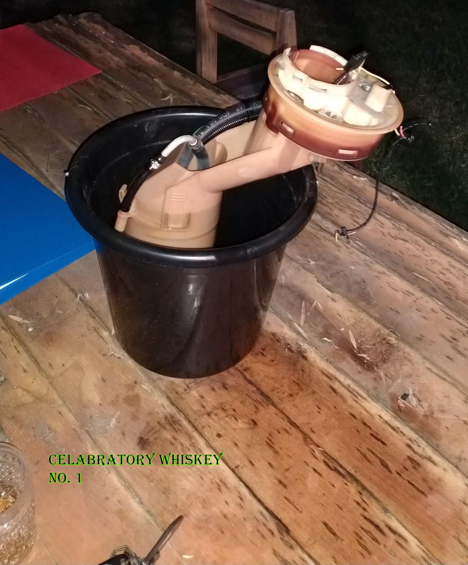

I wouldn't have thought it necessary to "celebrate with several whiskeys" after sitting in the boot for hours getting high on petrol fumes. :D
Thank you, thank you! My sense of smell has suffered since the back seat of my C4 A6 Avant caught on fire during a road trip a couple of years ago. I had to drag the seat out of the car and put the fire out with a bottle of orange juice.
I think that lack of smell affected me psychologically when I did this job, because I could not really smell the petrol and so, did not get high on the fumes. (Kind of like the logic of the Ravenous Bugblatter Beast of Traal if you have read Douglas Adams) Consequently, I felt that I did need to celebrate with some whiskey!
Attachment 23071
