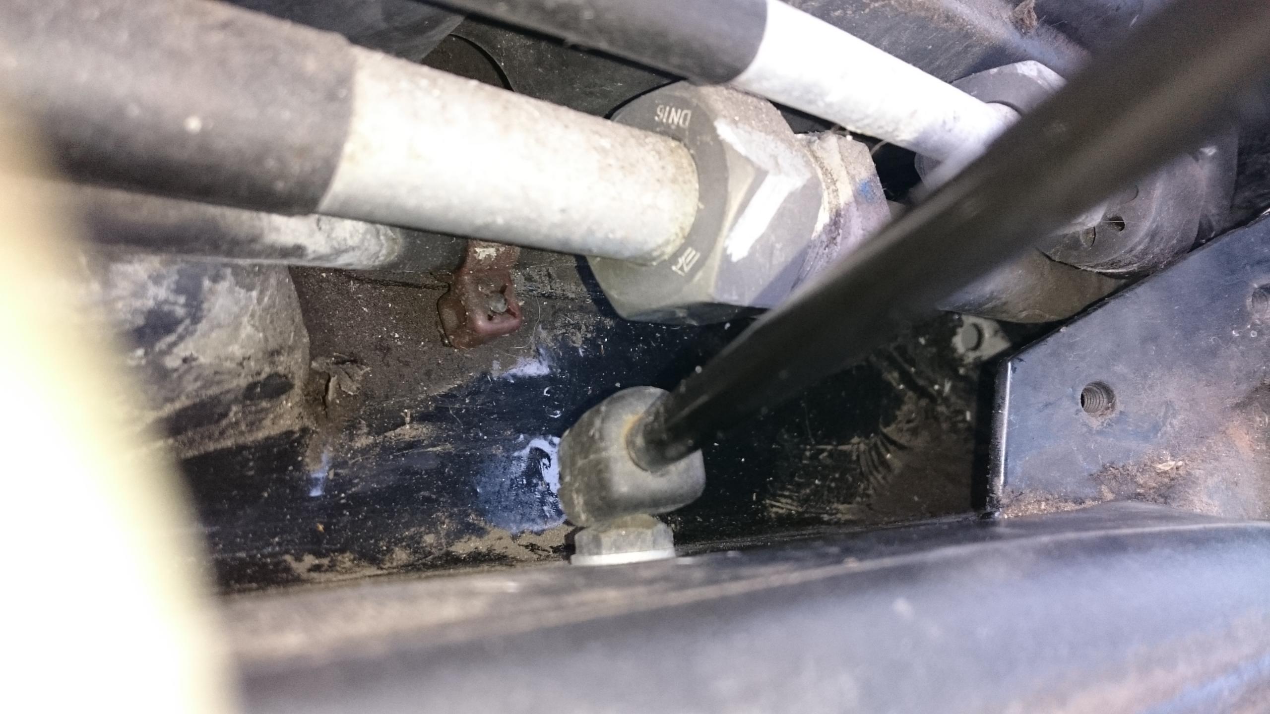

Daz 70 24th November 2016 02:50 PM
Hole at back
Well having looked at other posts....
I have indeed found a hole at the back under the air con pipes where they bend left (next to the electronics box in the right hand side of the engine bay).
Looked good ... welll was a faint line.... kinda just looked like how the sealing compond they used was..... however gently push that area and it just started to fall away and reveal the hole...
Cleaned it the best I can.....and put some sealant in and around the hole....
Not ideal weather so bloody cold.... but I did leave the engine running..... to get the car warm and engine bay so hopefully it will bond seal
Car is still not dry yet..... so I guess will see if it continues to dry out... or when the rain comes gets wetter... of course... it could still be getting in else where but was deffo getting in here... so at least one stop plugged :-)
Daz 70 24th November 2016 03:02 PM
Pic
1 Attachment(s)
Attachment 15157
Hole where the white patch is
HPsauce 24th November 2016 03:50 PM
Not quite sure, but is that the infamous Botang's hole?
moltuae 24th November 2016 05:25 PM
Looks like it to me.
I don't think there would be sufficient water getting through Botang's to soak the rear footwells ... would there?
I'd have expected damp front footwells at the most.
Dezzy 24th November 2016 05:37 PM
That's what I thought.
The hole you have there is indeed botangs and will benefit from sealing it up anyway.
You can hear water sloshing if the centre drains are blocked as you corner.
Daz 70 24th November 2016 07:23 PM
hole
Well centre drains are clear and I get no sounds of any sloshing of water.... both holes are clear left and right over wings.... and the I only ever seem to get water in mine... on the passenger side.
Well I've sealed this hole that clearly needed doing and will report back, once it's either dried out or carried on getting wet.
