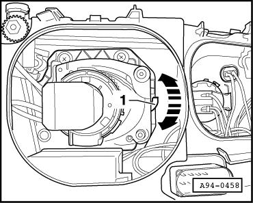

IT 15th May 2009 08:01 AM
1 Attachment(s)
Wow... Looks like i was right... Its been a tough day, best sit down for a bit +++
Servicing headlights
Converting headlights for LH or RH traffic
When driving in countries where traffic drives on the side opposite that of the homeland of the vehicle, both headlights must be adjusted so that the asymmetrical dipped beam does not impair other motorists' vision.
Note:
Bi-xenon headlights do not need to be converted.
  • Remove large housing cover from headlight housing.
Attachment 245
  • → Check the switchover lever position -1- for both headlights.
Left headlight:
    • Lever down = right-hand traffic
    • Lever up = left-hand traffic
Right headlight:
    • Lever down = Left-hand traffic
    • Lever up = Right-hand traffic
  • Move the lever into the desired position as necessary -arrows- until it engages -arrows-.
  • Reinstall the housing cover.
