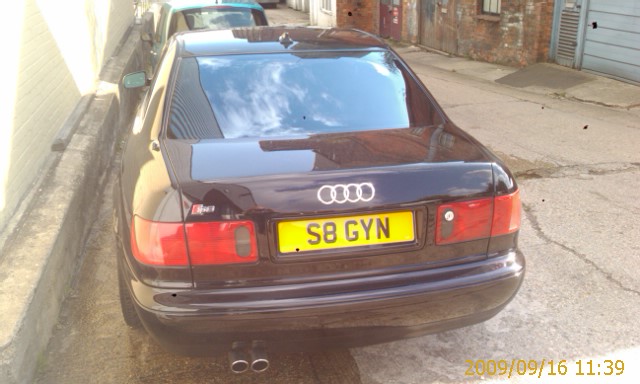

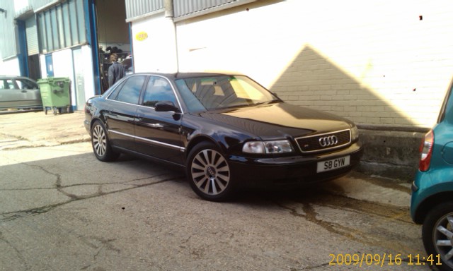

well..ive just had new discs and pads on the 8 and i also had to bite the bullit and have a new front drivers side wheel sensor...the frightening thing is seeing your 17 year old trainee mechanic son taking my baby for a test drive as he works at this garage....also amazed to see him plug the diagnostics Pc thingy into the connection point under the front ash tray and reset the ABS light......
