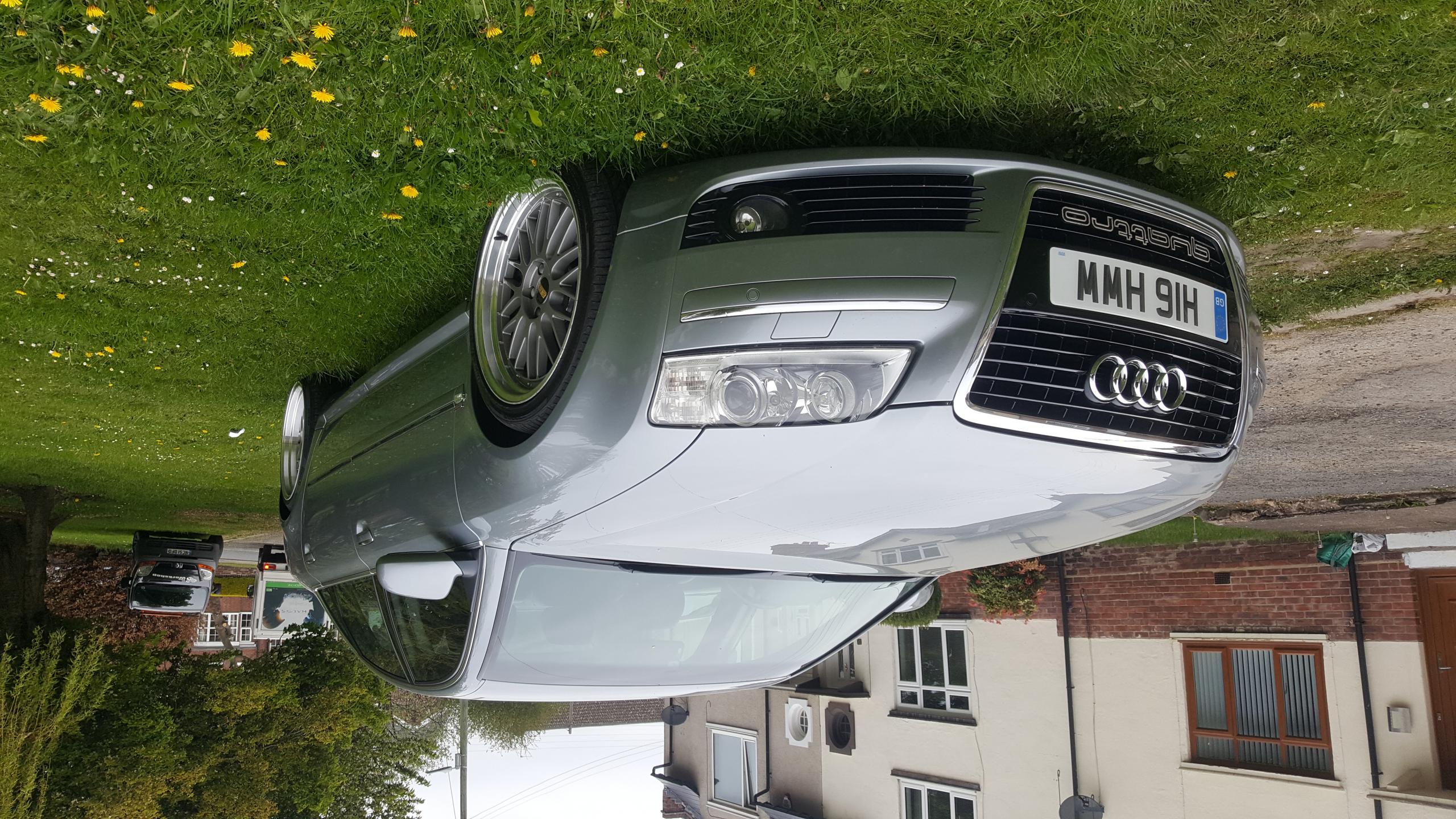

I have a staggered offset set of 20" BBS alloys on mine which are 11" on the rear and 9.5 on the front. If I knew how to post photos on this forum I could show how they look but I'm crap so I can't. The correct offset is most important to avoid any clearance issues. I've been running this setup for nearly 2 years apart from over winter with no problems at all. Hope this helps

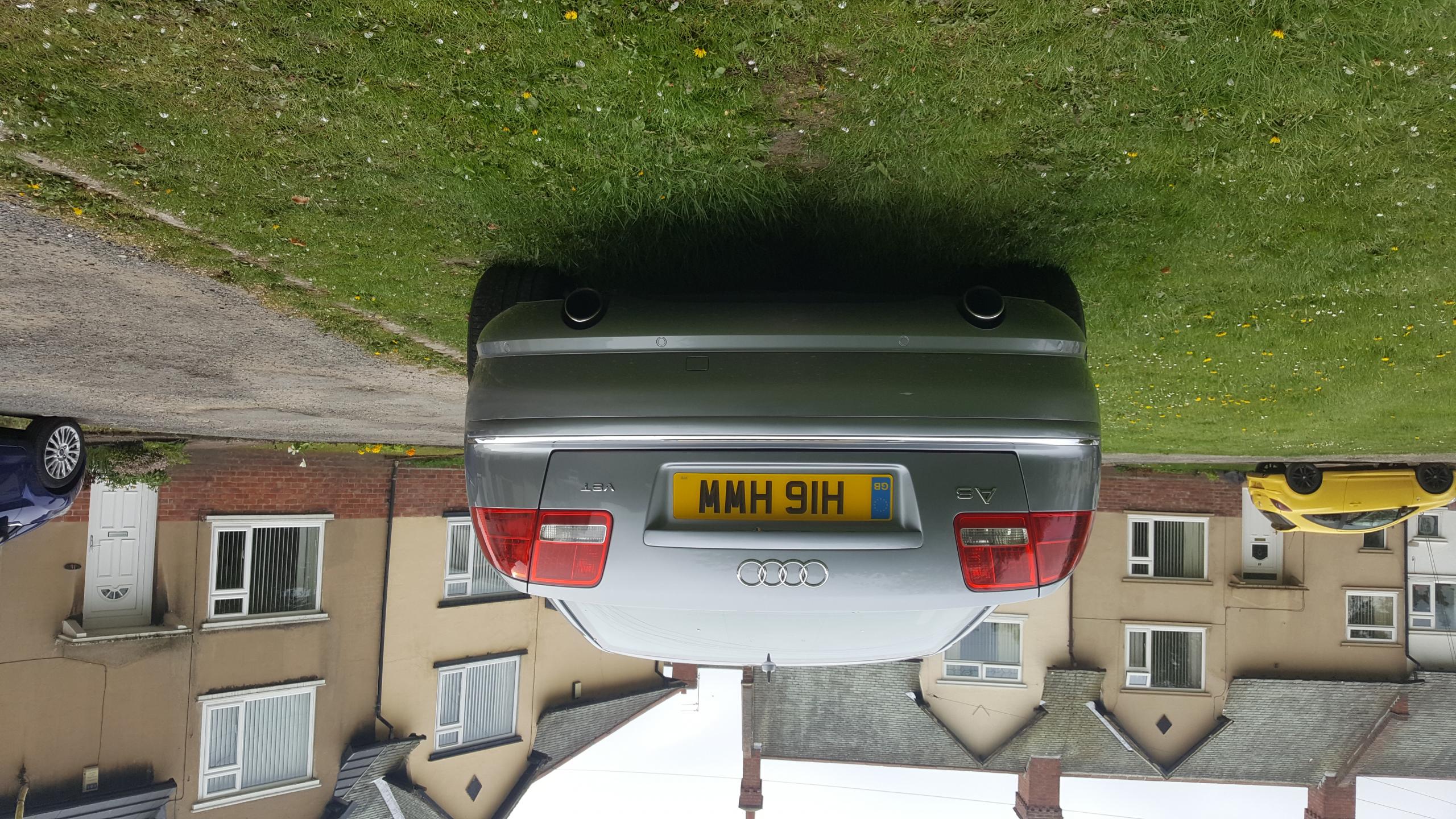

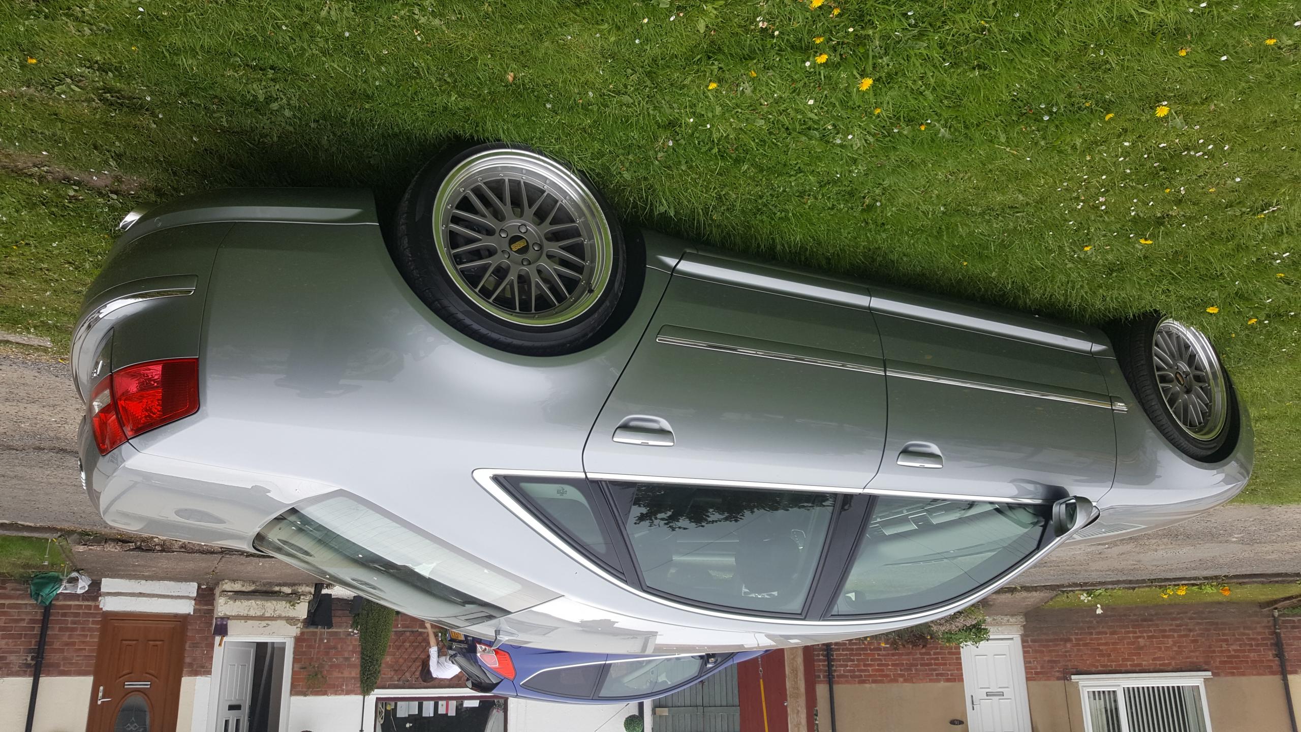

Here are a few photos as requested.

I have no idea why they are upside down, like I said when it comes to doing stuff online I am truly crap.

Damn that looks PHAT! Really like those rims, any rubbing issues buddy and what is the safest offset? is the 4.2tdi discs any bigger than usual?

Ha thanks, it gets a lot of looks and comments. No rubbing issues at all, I used lowering links to drop it about 35mm. The discs aren't a problem but the size of the front calliper can be, I used 10mm spacers on the front to get the look I wanted and clear the calliper. There's still quite a bit of space around the rears and I tow my caravan with this set up with no issues. Can't remember the exact offset but I'm sure I've made a note somewhere so I will get back to you.
