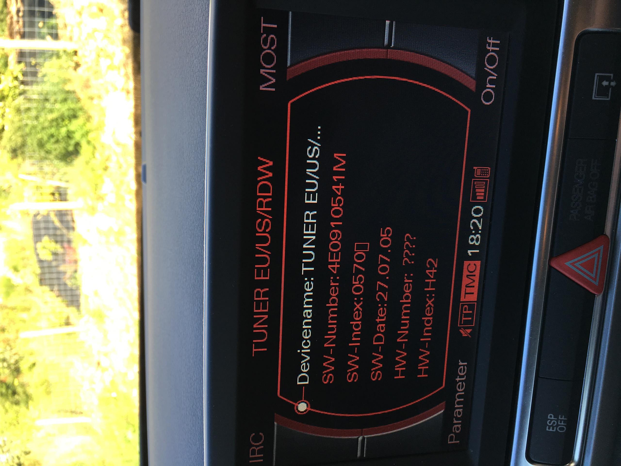

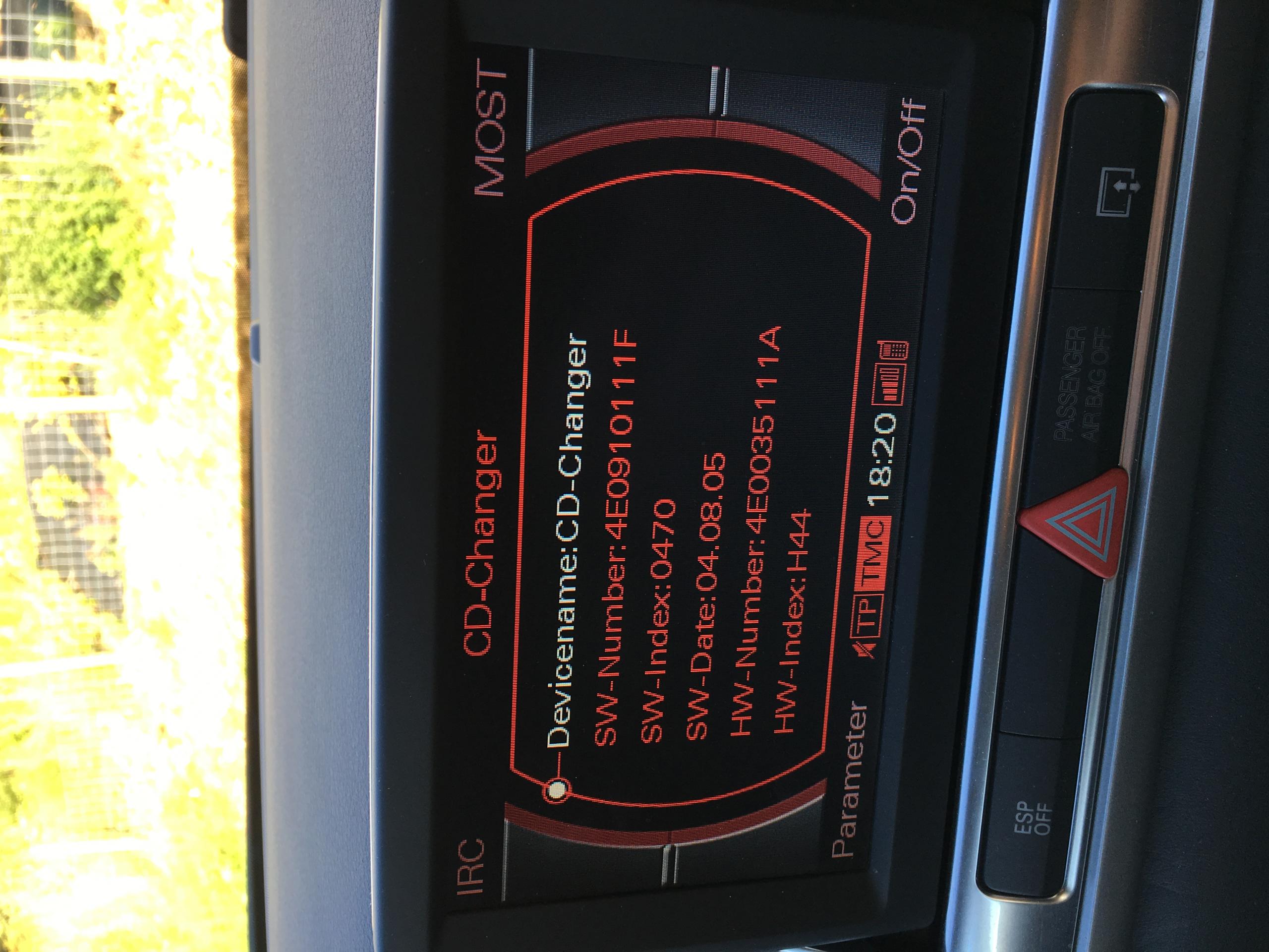

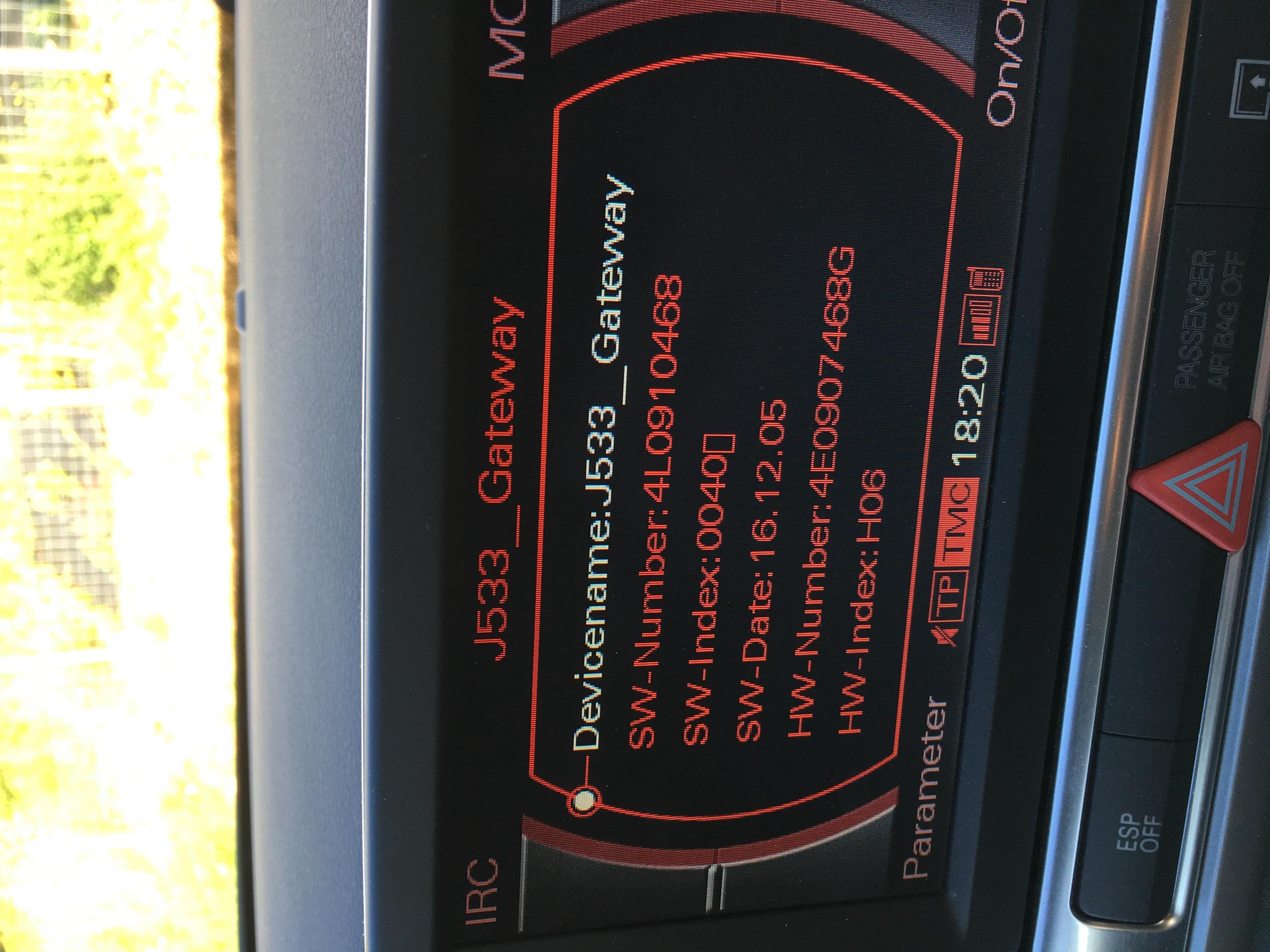

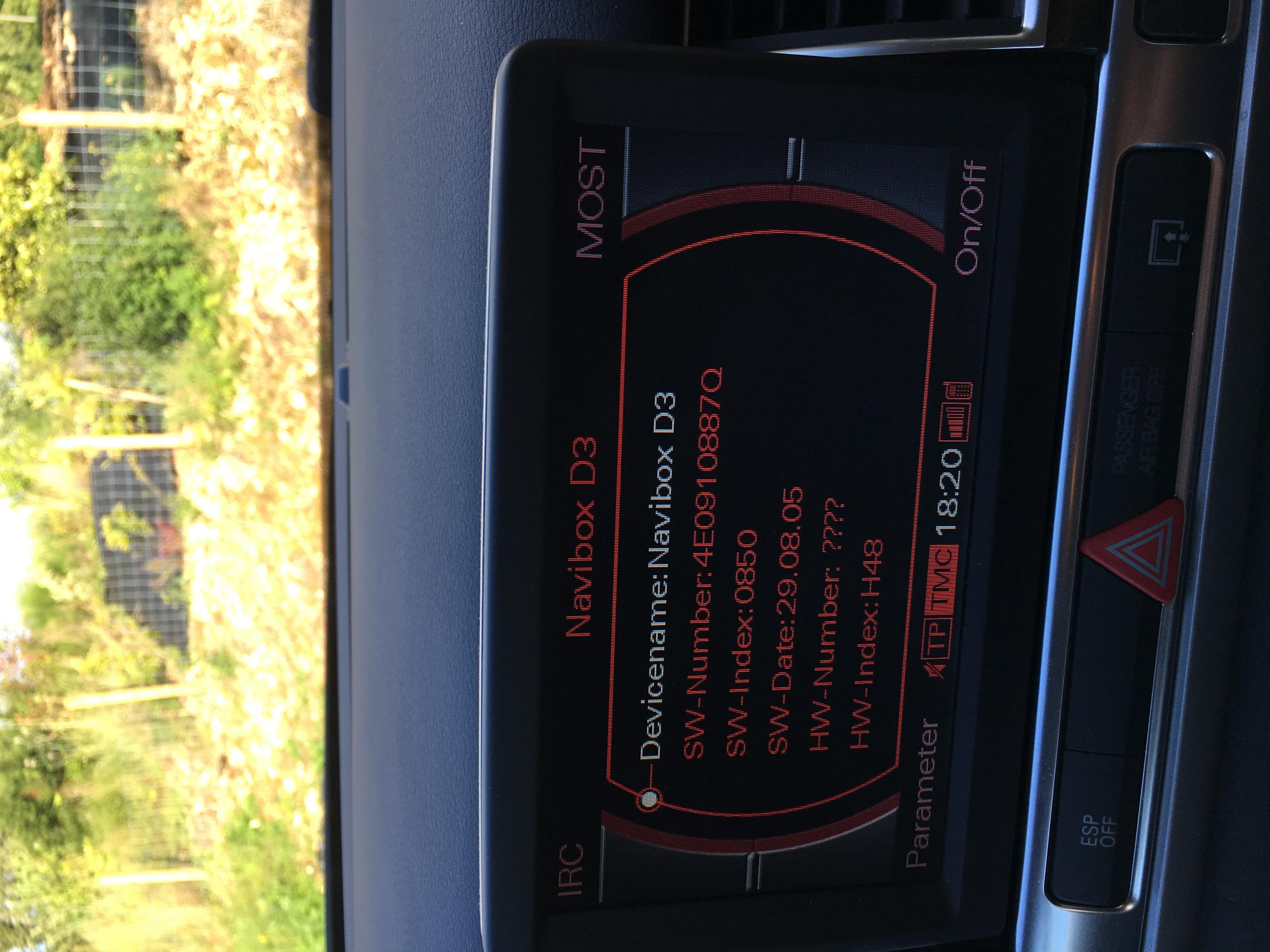

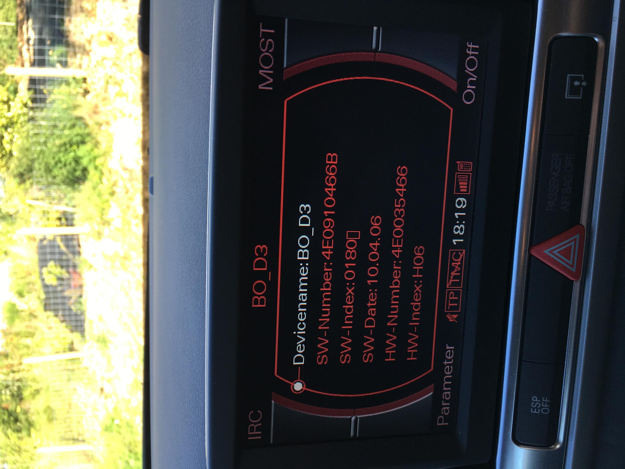

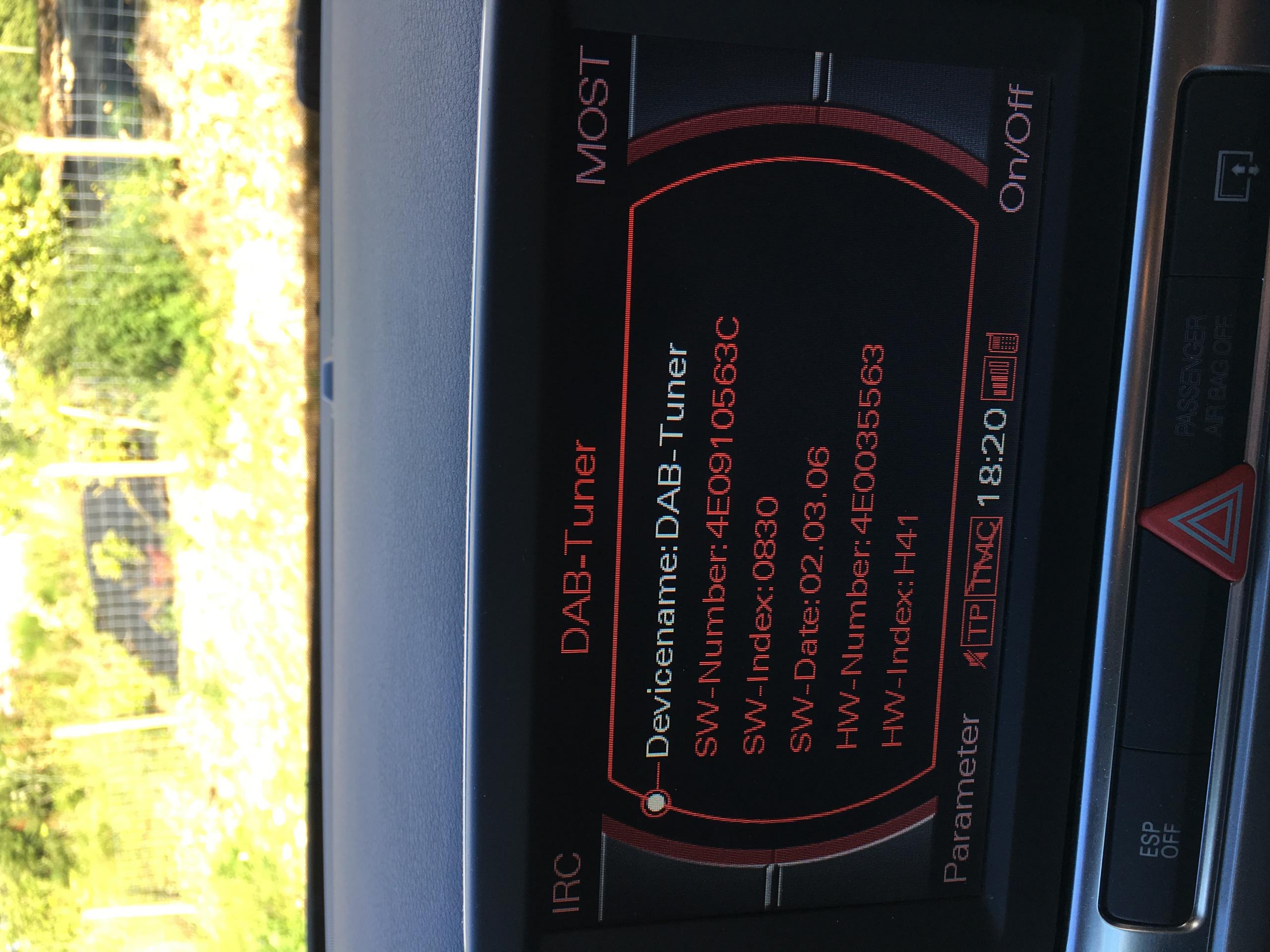

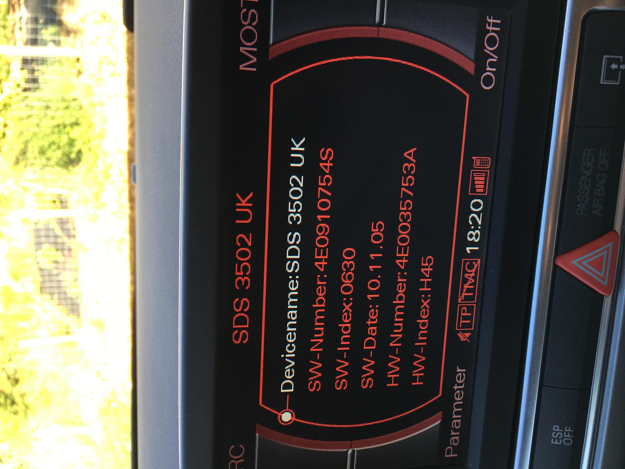

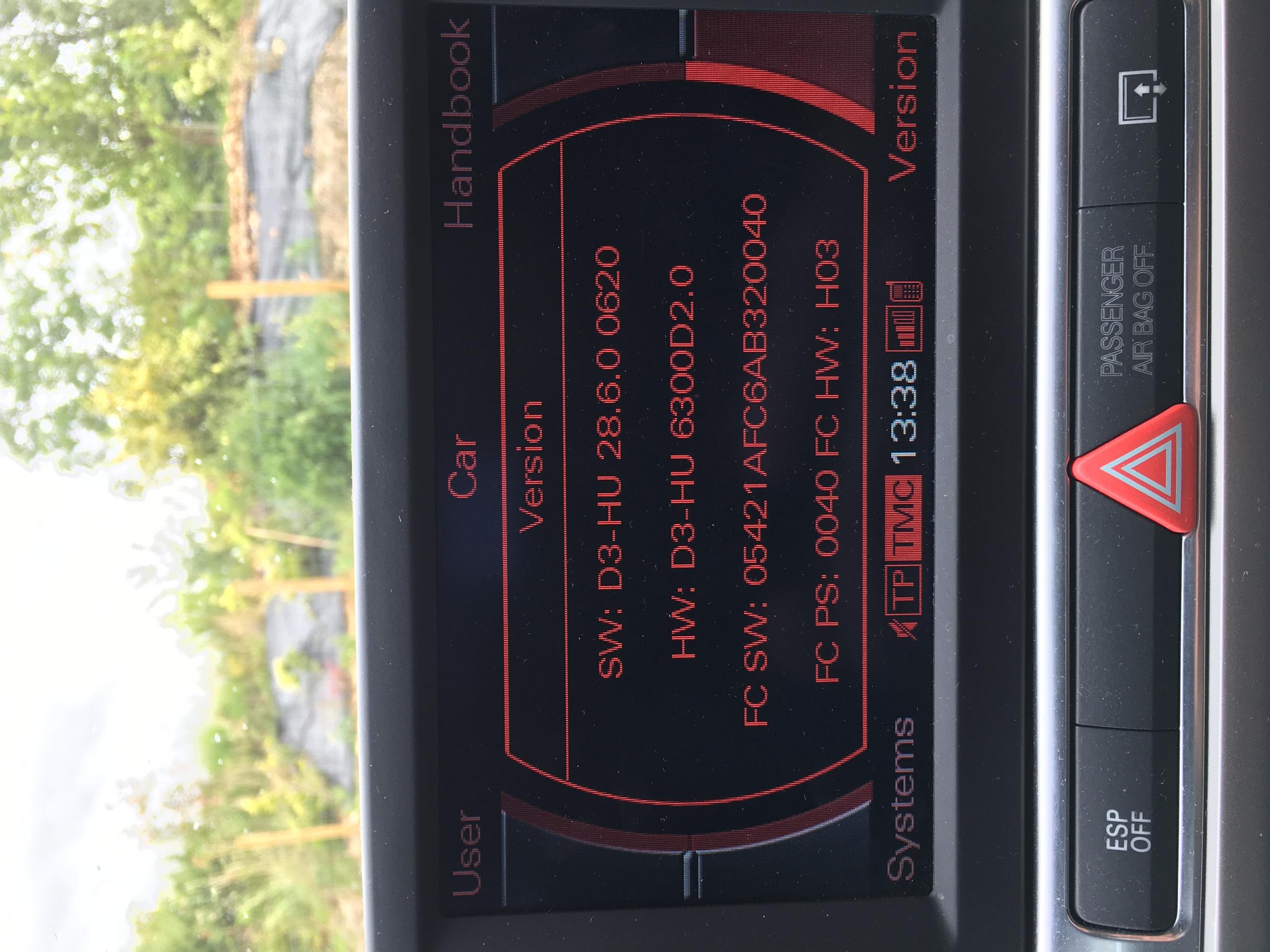

Default Results of red screen check
Please see attachments - they're photos of each screen which shows what I've got and versions.
Hope that helps :-)
Hope that helps :-)
Very Helpful
In order:
1) Interfacebox [aka Control Head] is the 'computer' that runs the MMI software. Currently 2860, it will go to 5150 [5150 CD] and 5570 [5570 CD].
2) BTA [Bluetooth phone] currently 0530, will go to 1120 [BT CD]. May take over 30mins and need 2 passes of the update runs.
3) BO-D3 [B&O Amp] currently 0180 will go to 0310 [5150 CD] and 0320 [5570 CD]
4) NavBox [Navigation drive] not done by MMI CDs, is updated by Navigation DVD. Current version 0850; final firmware 1060 is on all map DVDs from 2009.
5) DAB - 0830; already @ final version
6) SDS - 0630; already @ final version
7) Tuner currently at 0570 will go to 0620 [5150 CD] and 630 [5570 CD].
8) CD changer - 0470; already @ final version
9) Gateway - not updated by MMI update CDs
I would guess 5150 update will be about 15mins and 5570 about 10 mins. BT update will be a lot longer.
