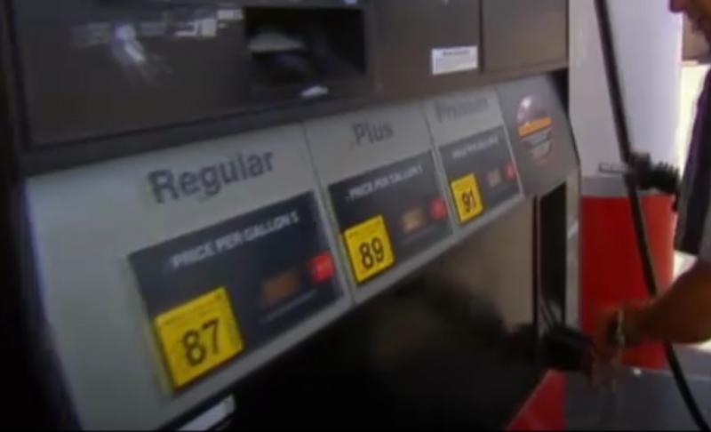

Just watched Top Gear USA on iPlayer, this is the screen shot from USA highway petrol station. The best they have is 91 so how do they drive cars which say to use 98 octane?

Some places do higher octane, but essentially the cars are slightly detuned for US use.

Apparently they use different rating system and their 91 is about 95 UK/EU
http://en.wikipedia.org/wiki/Octane_rating

Interesting... So their home-grown engines are even worse than we thought if they run on equivalent fuel

The United States rating is not RON (Research Octane Number). The rating there is PON (Pump Octane Number).
The numbers you see on the pumps in the States is not equivalent to the same values used in the UK.
