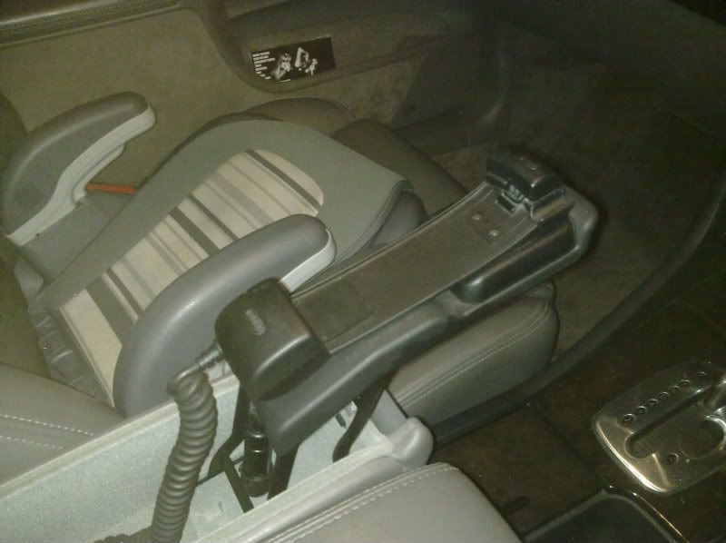

Hi Folks
Sold my A8 and got my dream car, a D2 S8.
Anyone any idea what kind of phone goes here ?
Also, in laymans terms, anyone know what i need to do to get the tv either showing digital tv or dvds?
Old 4th December 2011, 05:34 PM
Not 100% sure, but could be an old Nokia 6210/6310.
To get Digital TV, you'd need an external tuner unit to feed into the AV sockets. (which you may need to fit to the unit).

Old 4th December 2011, 06:07 PM
Think you'll find its a 3110 - You must have an early (1999/2000) Facelift S8, with the earlier fixed cradle.
Support for 6210/6310 didnt come until later with the interchangable Cullman cradles...
[/geek mode off]
Old 4th December 2011, 07:48 PM
That looks exactly like the cradle in mine which takes an old Nokia 3110 (NHE-8) phone - 900MHz single-band so O2/Vodafone only.
I've still got the handset and it works - on a separate PAYG sim to my main phone.

Old 5th December 2011, 07:09 AM
Think you'll find its a 3110 - You must have an early (1999/2000) Facelift S8, with the earlier fixed cradle.[/geek mode off]
Interesting comment, as mine is a 1998 PF S8 but fitted with that cradle.
HOWEVER....
There's documentation in the car for an earlier design, and none specifically for that one. Though I do have the handset original box complete with European (not UK) mains charger.
So, maybe it was changed over at some time early in it's life? (I acquired it aged 3 and a half)
How practical is it to upgrade that to a later design that supports a dual-band phone, integrated in the the audio system of course? I have a couple of Nokia 6310i's for example, though no car-related cabling.
Old 5th December 2011, 06:07 PM
But that type of cradle pops out of an early facelift armrest, only as per the photo...
On the Preface cars, the cradle sits between the two thinner armrests....
Photo ?
Old 5th December 2011, 06:17 PM
OK, I'm confusing you, sorry.
I was ONLY looking at the bit that holds the phone, not the supporting mechanism or armrest.
My phone cradle is between the 2 (narrower) armrests, actually fixed to the side of the drivers one and the lifting mechanism isn't very visible.
But my earlier question still stands:
