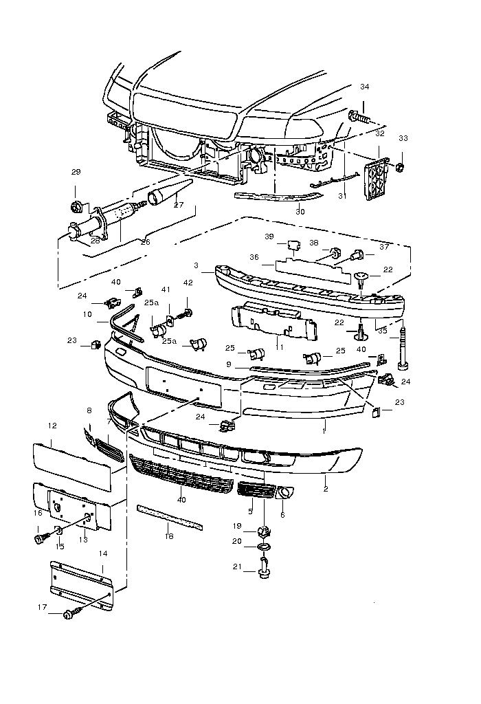

I didnt think the rears had a different fitment, just that they sometimes use shorter plates in certain states over there -
The front plates however have 3 choices, Euro style bumper with longer plate recess, or US style bumper which has holes in it for a choice of 2 different clip in sections, first is a complete bumper filler for states that dont require front plates (I have acquired one of these to fit to mine in the right colour) and the alternative is a shorter deeper plate holder that also slots in -

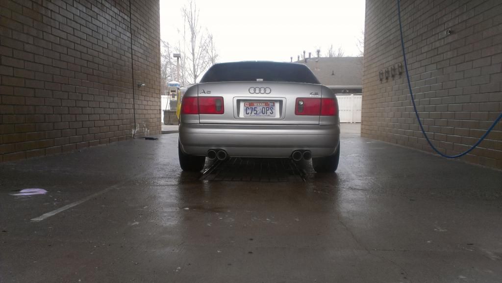

few examples
Looks like it might just be an insert to go into original number plate recess?
Looks different than mine
Old 2nd April 2013, 09:09 PM
Hmm looks like a different bootlid altogether on one and an insert piece on another, so unless you want to try and get a whole bootlid from the US then you need to find the other type of filler. I wonder why etka shows it at the front but not at the rear

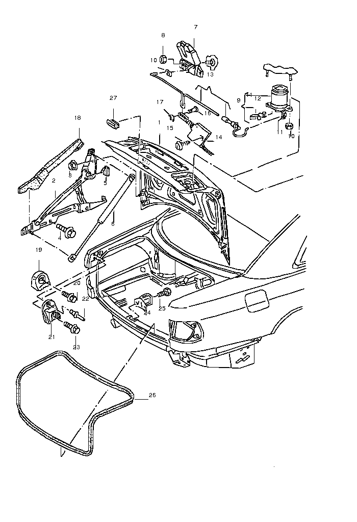

I'll look it up for you. Wolf Auto Parts are selling a trunk seal and if you look further down their ebay ad you can see they have an ok trunk lid in silver -
Audi A8 D2 Trunk Seal
Heres the trunk lid -
A8 D2 US Trunk Lid
