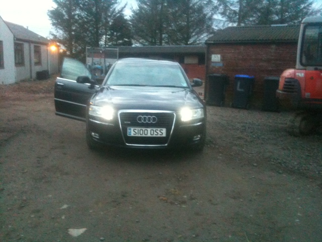

Here's a pic of the sidelights (parking lights)
Second pic shows Foglights which must go soon!
Last pic is the DLRs - had to fit resistor across the terminals to clear fault.
The resistor do run hot so I'll extend the wiring to bring the resistors outside the housing.

Yes, sidelights and DRLs are totally different. see pic showing both LEDs.
In my last post the first pic is wedge type sidelights with resistor - they are not central in the housing - look carefully, it's slightly offset.
Second pic is to show yellow Fogs against the Sidelights - fogs are H7 bulbs.
Third pic is the DLRs - they are type 1156 Leds and need a resistor across them - they are central in the housing, look carefully at the pic, it's central.
Access on '08 3.0 TDi:
Offside remove aircleaner box then plenty access.
N/S remove 4 internal hex head screws to allow headlamp to move forward a few millimetres then use grandson with small hands to remove/refit bulbs after I soldered in the resistors.
