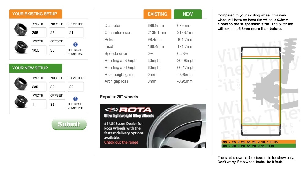

Offsets at the rear are ET35 from memory, I'll check when I'm next with the wheels as they aren't on the car at the moment. The hub was slightly thicker than the original 18" quattro sport wheels as I had to use longer bolts by 5mm too.
Yes the rubbing is just very minor tyre rub rather than rim rub
Old 30th March 2014, 09:30 AM
Looks like you might be ok comparing your rears against my existing but again you may get a tiny amount of tyre rub under full load / suspension travel. I have quattro sport rear suspension so same as S8 which is 20mm lower than standard A8
