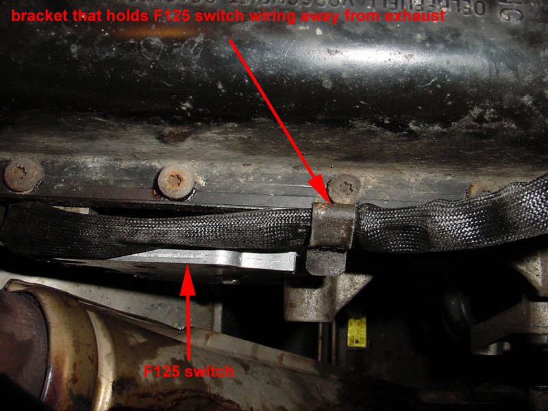

Default image of the wire
I m really bad with pictures....can never quite work out whats going on.....it looks like the wire from the switch is attached to the underside of the gear box....is it going towards the front or back of the gearbox?

From memory, it goes towards the front, I think.
On a ramp, with the bottom plastic under-tray removed, it's relatively easy to get to. I've cleaned the connector a few times myself on my previous '8s.
Fortunately (or unfortunately, however you look at it), the plastic under-tray was missing on my previous '8s when I bought them, meaning the connector was easier to get to. Without the protection of the under-tray, however, the contacts seem to be more vulnerable and prone to corrosion.

Looks like the connector is fairly easy to get to....so that will be the first thing i will check. The s8 will be on car ramps this sunday.....my son should enjoy that....he is only 5 but already audi mad.....he insists on being chauffered in the s8 all the time.....
