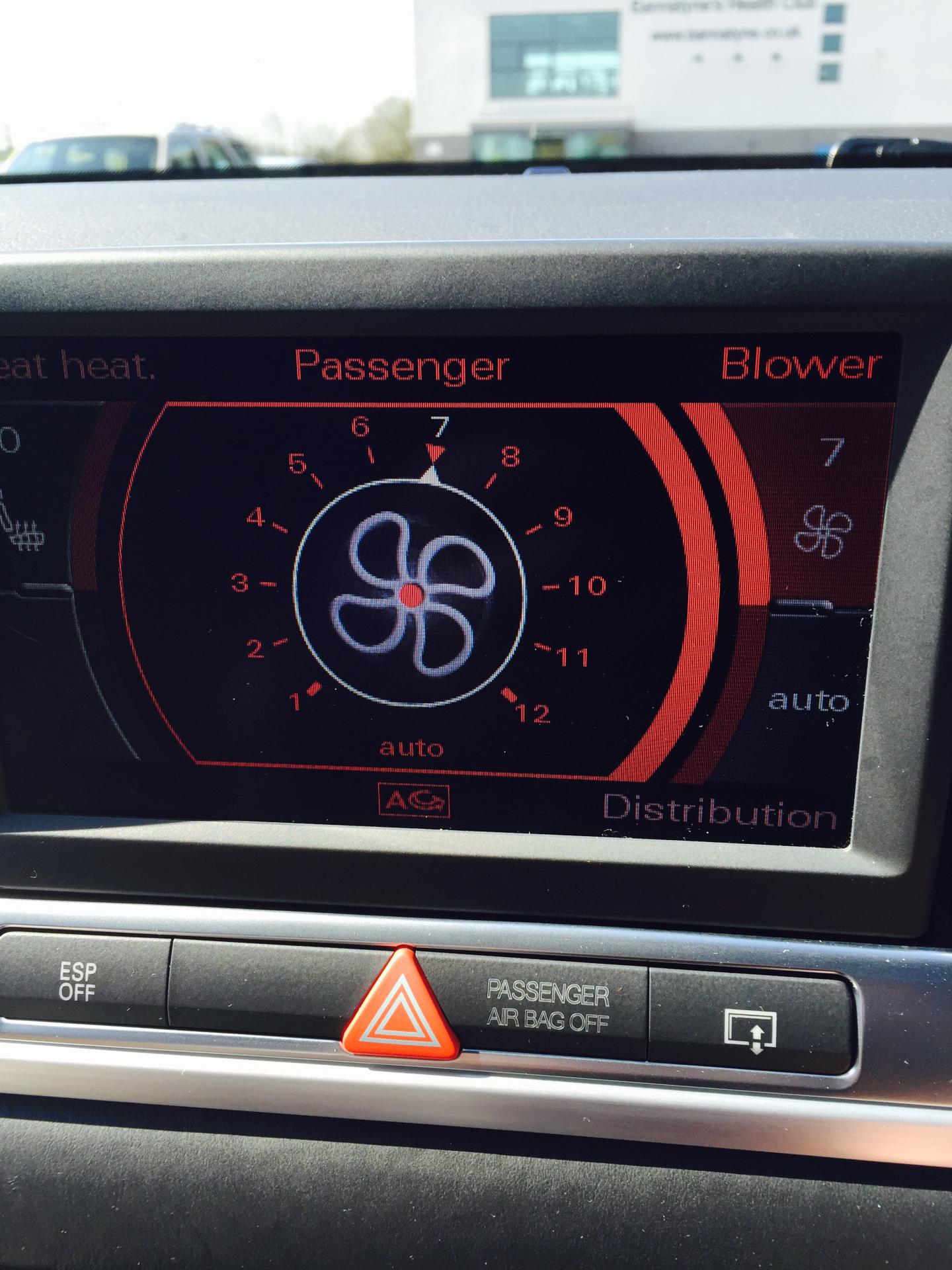

Hvac controls on my car appear to be coded for left hand drive but unfortunately there is no coding info or label files for it.
Is everyone's the same or is it just mine?
You can find out by pressing the fan speed button on your side and see if it says driver or passenger

Mine certainly says Driver for Driver and Passenger for Passenger correctly for RHD. I did test drive another '8 where is was labelled for a LHD car but didn't think much of it.

Try this Del,
Go to the MMI secret menu (car+setup)
Go to Diag Settings
Uncheck Linkslenker (this is the setting for left hand drive vehicles)
Restart the MMI
Climate control should be back to the settings for a right hand drive car now!
Matt
Old 14th April 2015, 03:58 PM
No idea how you found that out Matt but your bang on it.
Cheers fella, I love this forum
