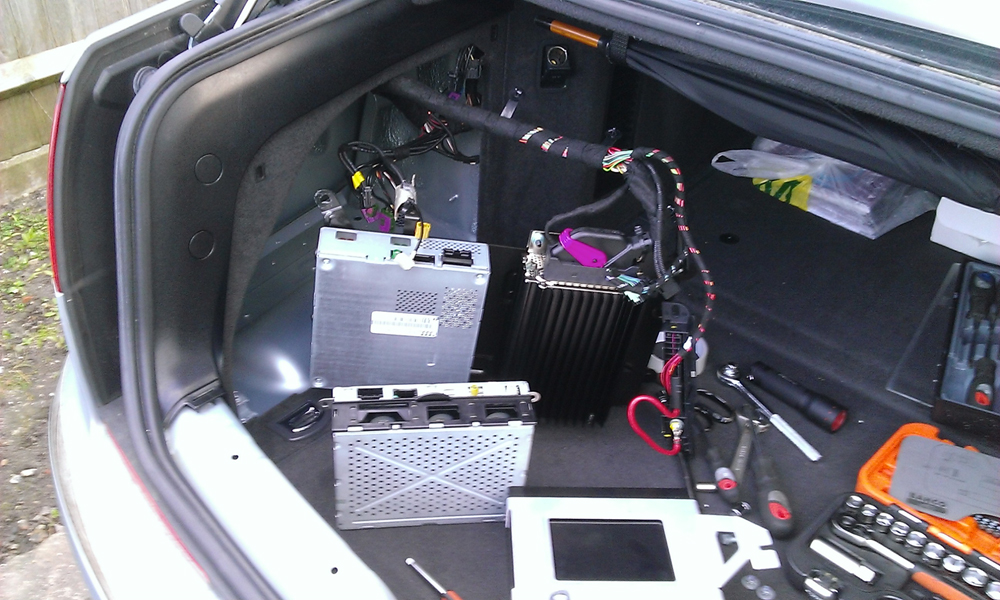

I'm glad I wasn't the only one who struggled for an hour or two getting that damn media rack out. I nearly posted on here asking for clues, but was too shy for what seemed like a 10 minute beginners job

It is defo a 10 job, maybe I'm a little practised on it....
Never mind that though, just clocked Mattys brolly holder in his boot photo, and I love it....

How do they do it, Ray?? Who knows?? I told my SHMBO that I simply installed a new aerial and it magically worked
Ian, the brolly is looped through the carry bag straps and it works a treat
