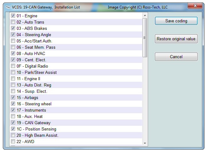

The CAN Gateway performs a [sort of] similar function in your car that a Gateway does on a computer network. It acts as a 'starting point' for comms between the devices.
It has a list of possible devices [including media devices on the optical MOST bus] and it's supposed to be set up to match the devices installed.
With VCDS you can see the list and which ones are selected; then you check what you've got and make sure the list matches
On my car I started getting Gateway error messages like yours when my telephone ECU failed; the Gateway thought it didn't have one so it generated the mismatch DTC.
Delboy's guessing you haven't got that function in OBDEleven ...
