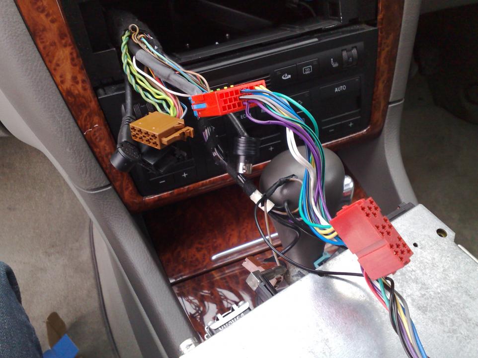

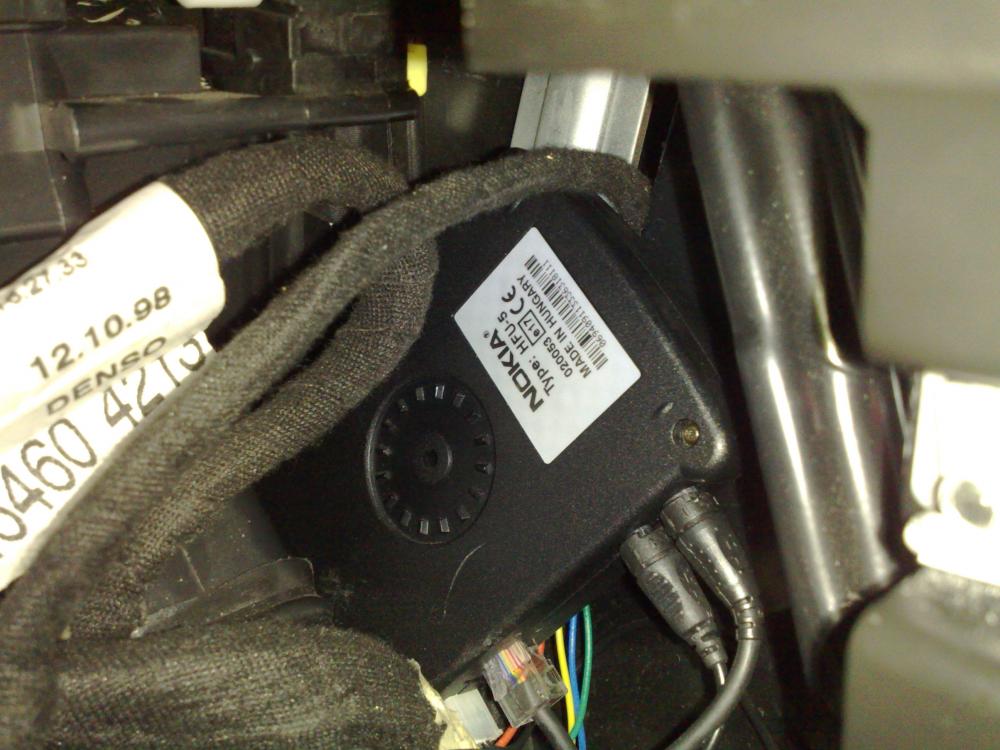

I've now managed to have a good look in the light of day and the wiring has been modified. I have attached a couple of pics showing the arrangement.
Is this something I can do myself or will I need an audio specialist?
By the way anybody know what the Nokia box is?

Old 1st February 2009, 01:29 PM
The Nokia box is a handsfree kit. Does the car still have the cradle, as I don't think that one is handsfree.
You could remove it and the adapter loom it's wired into (the one with the two red ends) and that may fix the problem. Or at least make it easier to diagnose. Just unclip the connectors and put the original 3 blocks into the head unit again.
Old 1st February 2009, 01:40 PM
Yup, I agree ^^^^^^^ - Remove the bypass loom withthe two red connectors, and instead plug the blue/yellow/green connector straight into the Nav unit. This will almost certainly bring your CD changer back to life.
The nokia is a hands free kit, but I suspect the computer-lan type RJ45 connector either does, or did go to a cradle. Unless you want to preserve the nokia functionality, then it could be removed if you trace the various wires and remove them too....

It Works!
Thanks a lot for your help. I now have a working multichanger and a happy missus!
