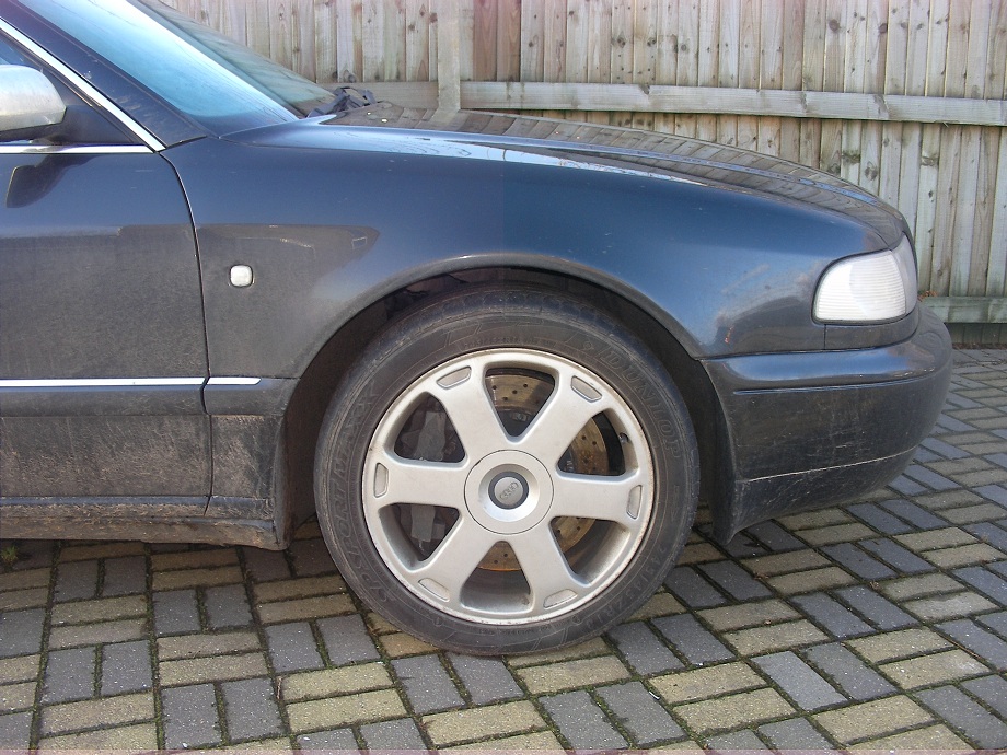

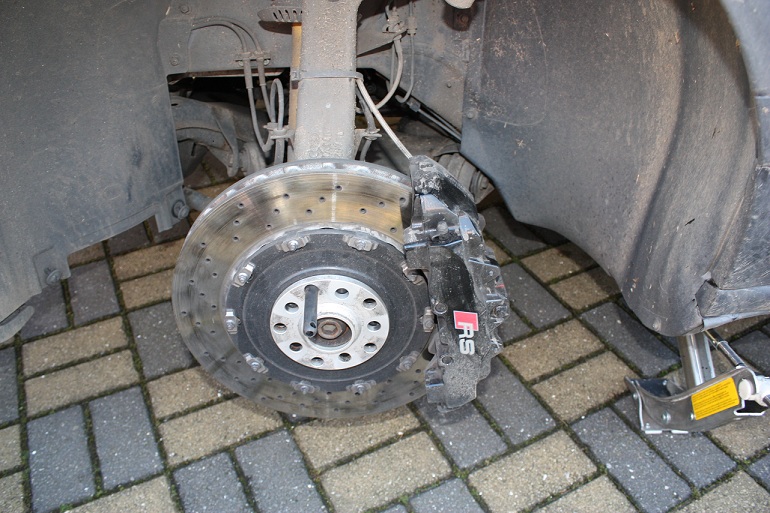

Pre facelift S8 running RS6 brake calipers. I confess, I dont recall if the discs were the standard RS6 ones, or B7 RS4 ones... Or if the rears on this car wre B7 RS4... I know B7 came into the setup somewhere , and that sadly is the level of detail I have on these photos from a car that was dismantled 3 years ago......
The wheels are standard facelift 18" avus....

Old 6th August 2012, 12:40 PM
Brave man there using the 'Audi jack of death!'
Old 6th August 2012, 12:41 PM
Even braver . . . posting a pic of a car THAT dirty on here!
You should post this pictures and info in this thread:
http://forum.a8parts.co.uk/showthread.php?t=1047&page=4

Old 6th August 2012, 01:18 PM
I could have cropped that out, but thought I'd leave it in to see how long it took for someone to mention it
Why not?
The RS6 disc is only 365mm so it would fit under 18" rims.
Erm...Thanks for pointing that out. Is there a prize for the most wrong answers on a forum?
Now to back peddle and try and recover a bit of cred (I'm praying this is right )
You can fit up to 390mm front discs on the D2 and these will not fit under 18in rims.
Ian, I bought the rear brakes from that car . I'll get the part numbers for our friend Rallyquattro the next time it's on a ramp.
There is a thread about the brake upgrade for that car on Tyresmoke somewhere which details what has been fitted.
