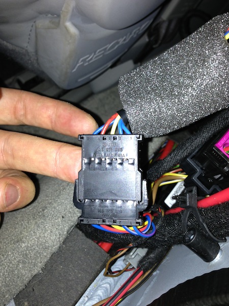

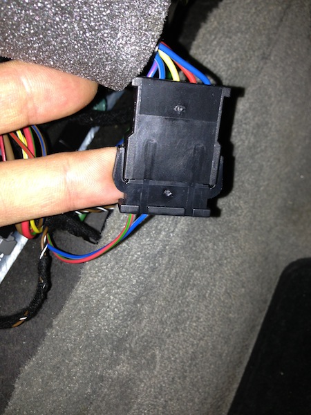

I removed lower b-pillars and inspected motors. Both motors are equipped with memory senders. On passenger side wires from memory sender only go up to electrical connection to main loom of the car where they connect with nothing! On driver side wires from memory sender are properly connected.

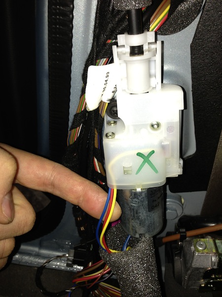

Pictures! This is how belt height adjustment motor looks like in the lower b-pillar.
There are 5 wires there. Two wires are attached to the bottom of motor barrel to actually drive it and 3 wires (blue, red and yellow) are connected to memory sender, which sits under white plastic cover with green 'X'.
Now those 5 wires travel from motor to the main loom of the car and we have electrical connection there. In that connection only 2 wires which drive the motor are actually connected to car loom. The other 3 for the memory sender are hanging in the air!
On driver side everything is tip top. All 5 wires are connected.

The thing is motor has positioning sensor (rheostat) inside it. I have opened it and checked where the wires go I have proper motor with memory function with wires going nowhere. When I purchased car there was no single evidence anywhere in the car that someone pried off trim or modified anything electrically.
