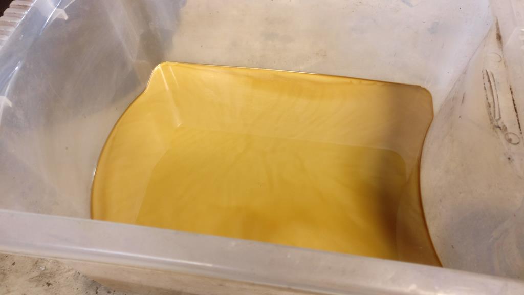

Why poorly though? This is the contents of the sump
There is no oil in the coolant, so its not the oil cooler. Logically therefore its either a headgasket or a crack somewhere. Obvious we're hoping its just a gasket, but I'll be doing some pressure testing to find out once the engine is stripped down.

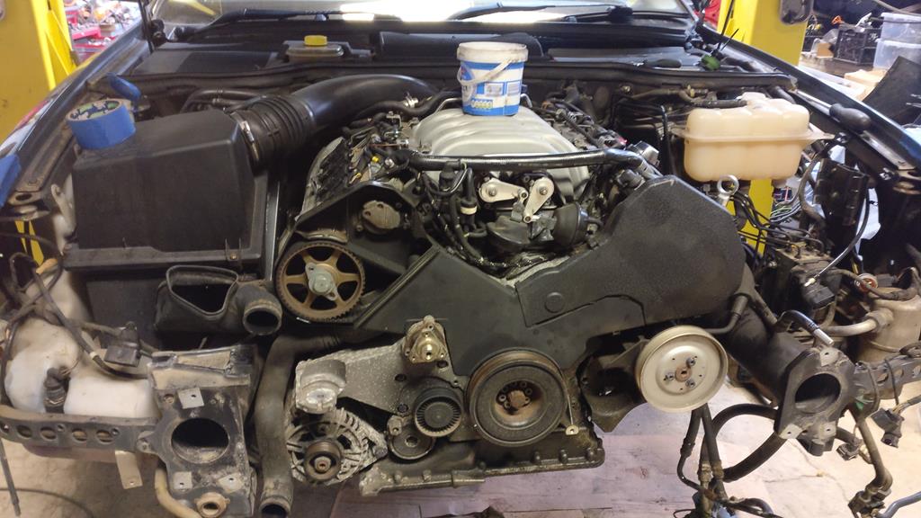

Engine out today. It didn't start well as the main bumper bolts refused to come out so I had to take it off with the supports. I'm getting quite good at this now though since the last four I've done have been like this! I am running out of new bumper bolts though
The power steering fluid is past it's best so I'll change that.
After the bumper, everything else came off just fine - no other seized bolts and it all went really well Front panel off:

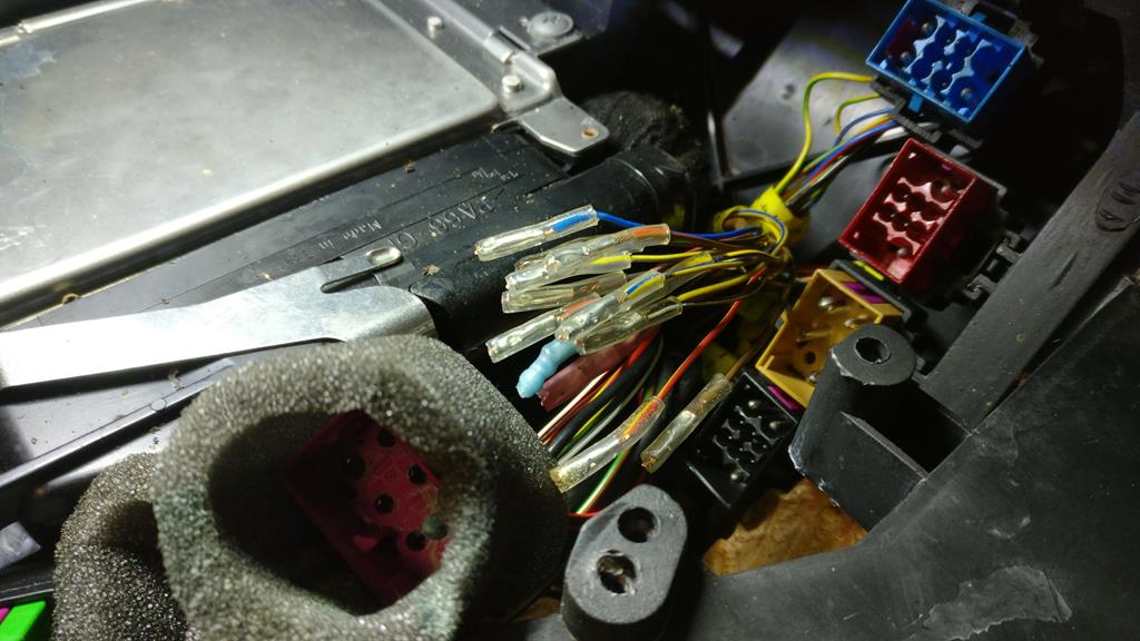

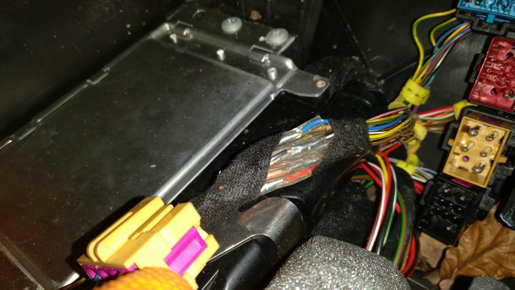

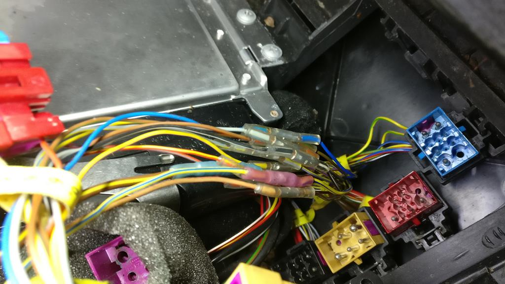

Oh, well apart from this
At some point in the past there has been an issue with two of the connectors in the electronics box and someone has made a really nice job of splicing the body harness to the engine harness. Unfortunately, the engine harness must come out with the engine - its nigh impossible to get it off with the engine in and completely impossible to refit it like that, so I had to cut these apart
I'll fix this later with some original connectors.
