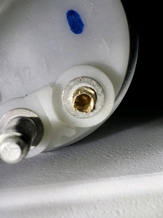

I wasn't careful when I was tightening the nut for my new fuel pump and snapped off one of the terminal post looks like I need to buy a new fuel pump

Maybe a stupid idea but if you're careful could you not try soldering the terminal to what remains of the stud? Your gonna scrap the pump now I guess so maybe worth a try.

or drill and tap it?
There isn't much left of the stud on the fuel pump. Is soldering even a good idea?
It's possible but I have no idea how far I can safely drill down into the broken stud on the fuel pump side. Also finding a small enough replacement stud to screw into the newly drilled hole and have it tapped out to receive new stud.

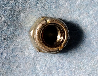

This is the nut for the negative post on the fuel pump and it looks like it has a nylon insert?

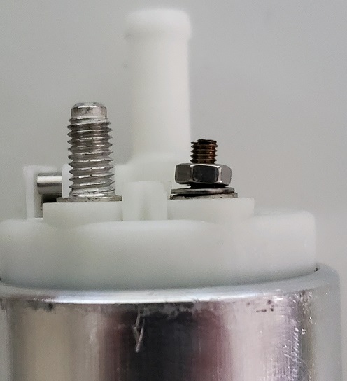

Here is my attempt at fixing my broken fuel pump stud. I was able to drill and tap the hole.
I was able to get stainless steel screw, washer and nut for the repair. Unfortunately I wasn't able to get the hole drilled completely straight .
Got the head cut off and now I'm wonder if this is going to be a problem as this is not sitting straight and could cause a problem?

Could you use a spring washer to help with the offset?
Old 15th June 2020, 06:33 PM
Can you just ignore the offset by tightening two nuts together on the bolt, keeping clear of the body, rather than tightening the nut down onto the body? Maybe with a locking washer of some sort.....

^ What he said. 🙂
Thats a nyloc - the insert stops it loosening from vibration.
