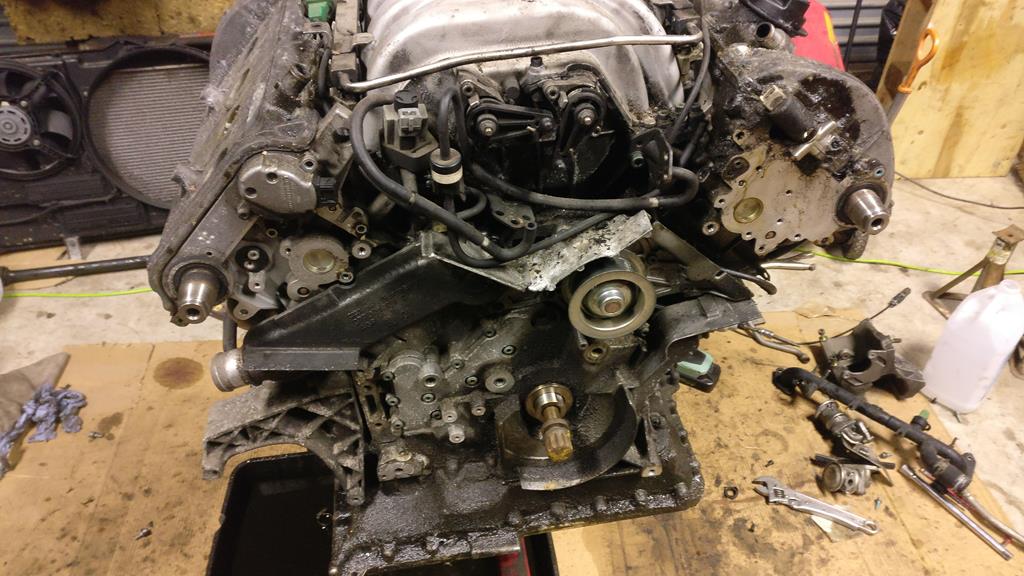

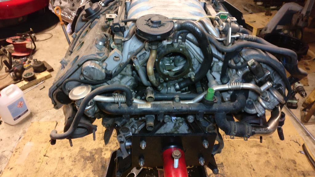

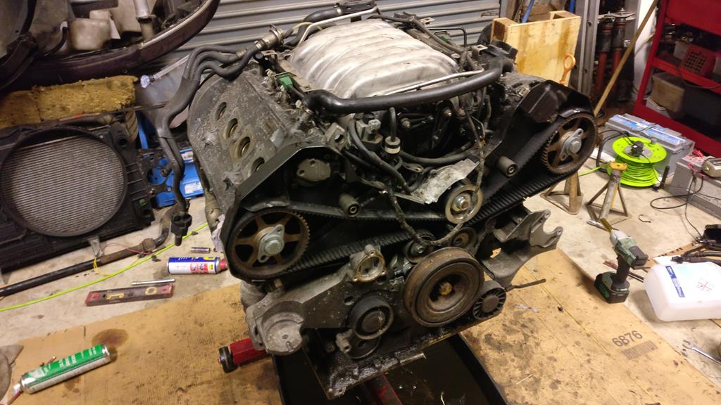

Soooo.... wind back the clock to Sunday when everything was just oily and not broken. Insert Time And Relative Dimensions In Space joke here...
I've decided this AQH is too much work right now, as I have a couple of fixed points in time coming up and I need this one turned round quickly. While the engine mount is fixable, its going to take a week or so of ordering and making tooling, making the repair insert, and actually applying it, plus fixing everything else like the inlet manifold, injectors etc and I just don't have time. I've got a spare AVP from stock and I'm going to do all the same work to that instead, and I'll sort the AQH out later.
Part of the role of this car is to allow me to test all my spare engines and get them all rebuilt and ready to use, so I've just shuffled the order a bit.
AQH on the left, wrapped up to stop anything getting in the inlet ports, replacement AVP on the right
Started stripping it down
So much cleaner!
Obviously this has set me back a couple of days of cleaning, but it will save much more than that since this engine is in a far better state to begin with It also had a genuine timing belt kit and water pump fitted shortly before it was decomissioned so all that stuff is in pretty good condition and can be re-used, apart from the belt which will be new.
