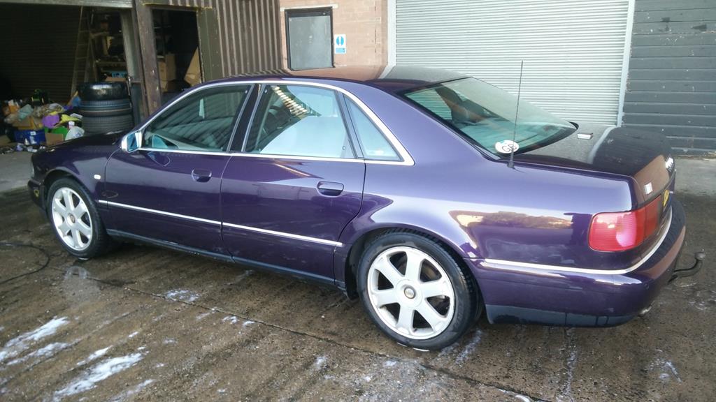

Hi all,
You probably remember the Merlin Purple S8 that Dezzy found in Bristol a little while ago. Its been sitting in the workshop since I picked it up as the drains are all full of leaves and I wantd it to dry out before I did anything else to it. I had to move it today so beforehand I hoovered up all the leaves and then gave it a bath.

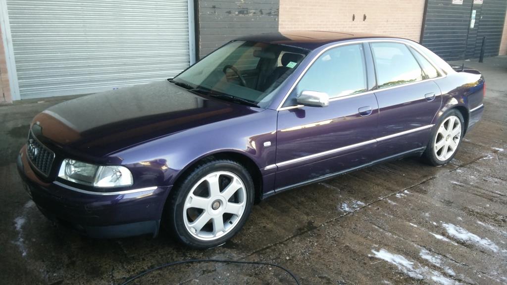

Overall, its pretty straight but the paint is fairly battered. The bonnet has been painted badly and has lots of damage to the lacquer, and the boot is covered in cat scratches. Some other paint, some other scuffs and scrapes.

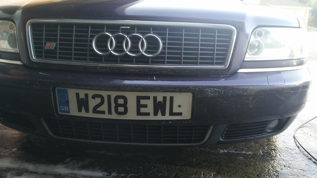

The front end looks like it has been sand blasted!

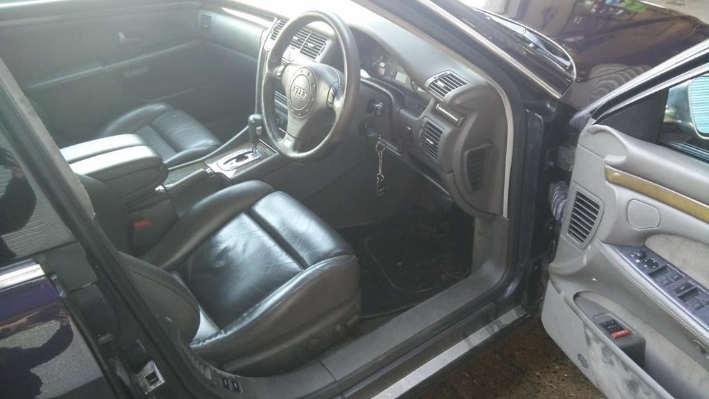

The interior is very tatty swing grey, second only in awfulness to blue. Its filthy, trashed and stinky so will be replaced with a stock black interior.
Who at Audi thought this colour match was acceptable?

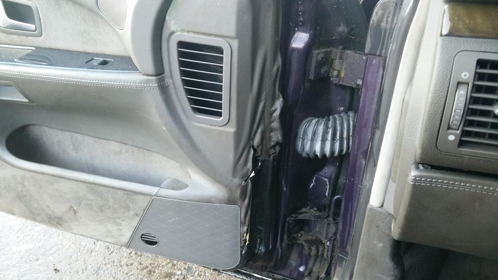

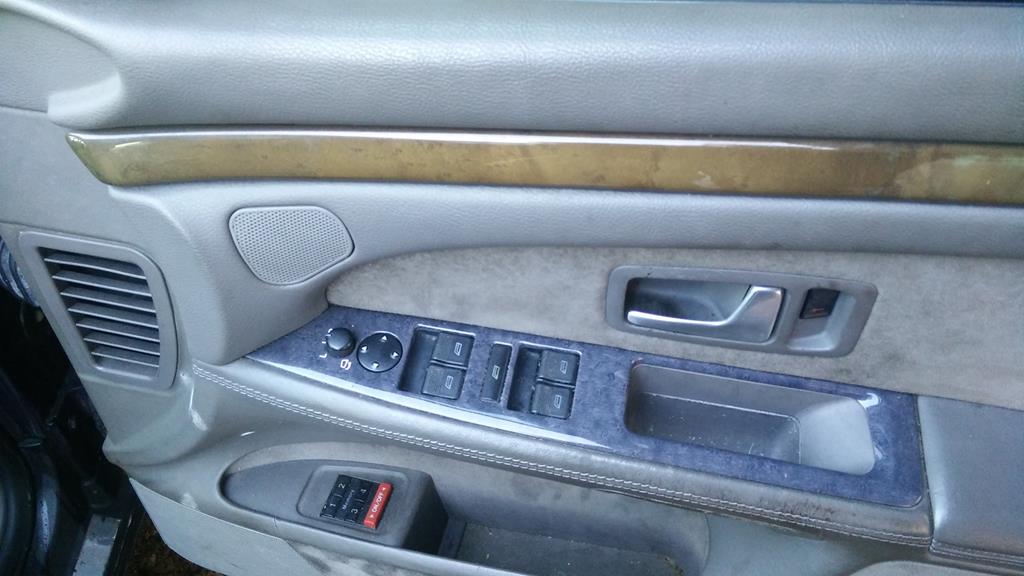

The passenger door card is completely destroyed - shame, because it's extended leather.

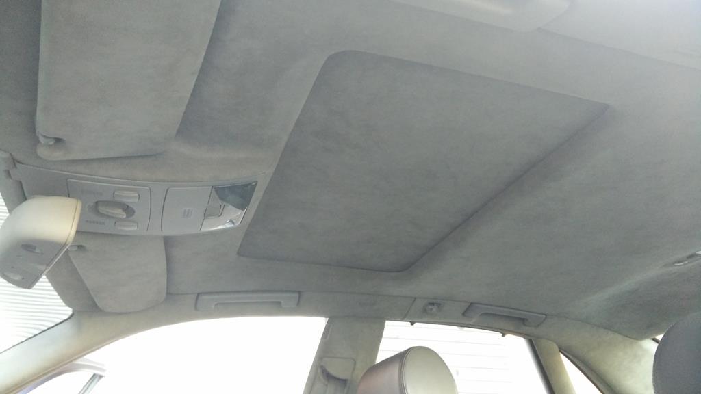

The alcantara headlining is closer to platinum than swing - much lighter than the leather colour. That is staying so will just get cleaned. Not canon for an S8 with black leather, but never mind. It'll still be a nice place to sit once it's finished.

What on Earth has happened to the door card? It’s been a little mangled at some point in its life!

There's a fundamental design flaw with the extended leather door cards in that some of the leather is actually outside, since the weather seal is actually on the card itself. On most examples this manifests itself in the leather discolouring and peeling off the back of the door card as the glue gets wet, then it shrinks as it dries and pulls tight. This pushes the weather seal further off the door, compromising the seal, and so the cycle continues.
This one is an extreme example of that problem. It's lived outdoors all its life, drains blocked, crud in the door shuts, and the leather has just rotted away.
I'm researching a way of fully waterproofing this portion of the leather in order to prevent this from happening. Most waterproofing agents have an optical impact on the leather though, mostly adding gloss, so its a matter of finding a product which is effective enough without looking obvious.

This extended leather door cards problem is documented in ELSA.
Audi released an updated version of extended leather door cards with full plastic perimeter, so that leather actually starts only inside the car.
There is a photo of this new door card in ELSA too.
These door cards were replaced under warranty.
I never seen one though in reality and don’t know if they have had a separate part number.
There was no official recall to fix the flaw. Only an advice that these new door cards are available if customer complains.

Is that a sun glasses holder i spy mine hasn't got one?
Erm, no? What are you looking at?

on the last picture by the interior courtsey lights / sun roof controls
am i going mad looks like a drop down bit for sun glasses

That's just a stock D2 roof. Sunroof switch, airbag warning panel, interior lights. No sunglasses thing.
