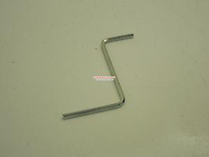

Old 8th May 2013, 08:28 AM
Originally Posted by SilverS8 View Post
Thanks for all the replies
I did close it manually with the tool hidden in the fusebox cover, Its very smooth and opens easily in all ditections when done manually...
When ignition on it moves apx 1 cm back and forth before it stops, this happens if it is on tilt,half open, fully open...
Is there anyway to calibrate/reset the sensors like on the windows?
It could be the pinch protection playing up maybe.
No idea what this is, hope you get it sorted soon.
Could you post a photo of the tool and its location?
Jim do you not have a owners book? The tool looks like this
And on a PF it's stowed inside the cover for the sunroof, int light lens off, 2 off phillips screws out and down comes the cover with a pull.
