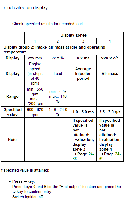

Here is the correct data from the horses mouth (ElsaWin)
Your new values look fine at idle, if a bit high. I have seen around 8g/s at idle recently too.

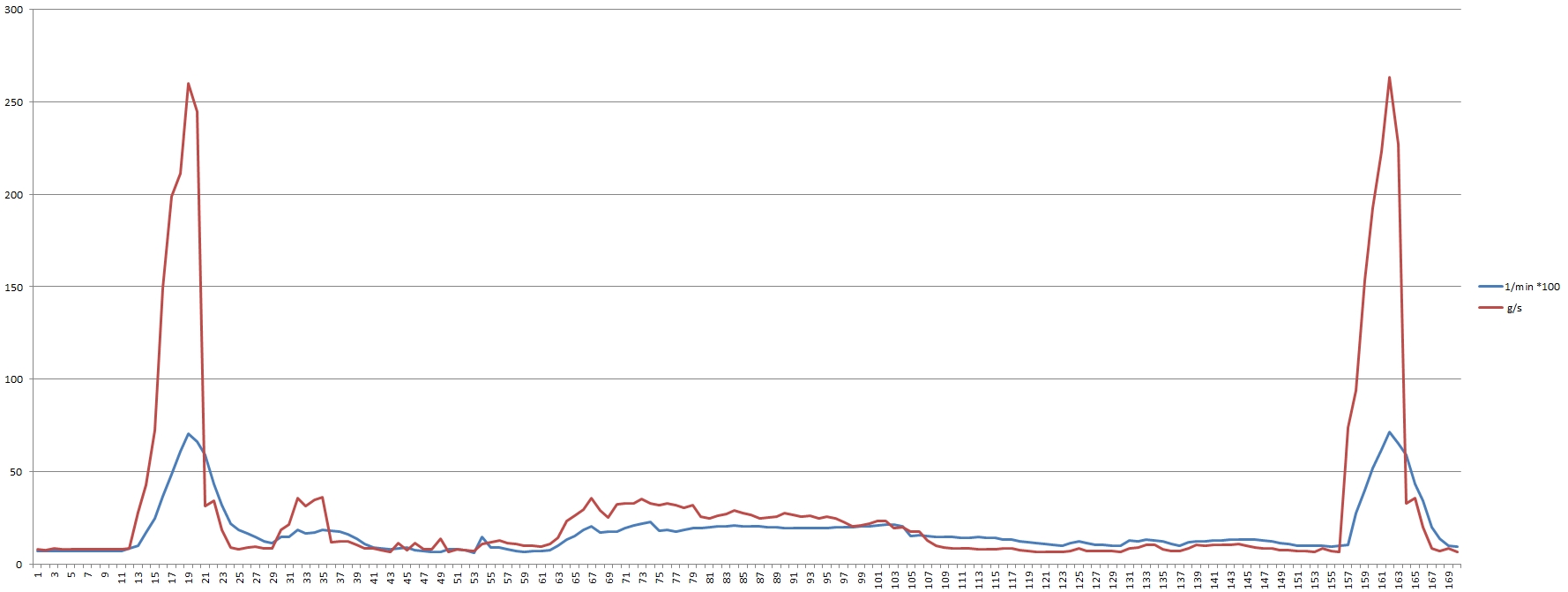

285g/s looks good too at 5000rpm. Plug in VAGCom and select log values and go for a little run, make sure you hit the red line at least once, then plot a graph in excel.
I found a old graph from my previous MAF which was working ok (as far as I know). Rpm/100 for easy comparison.

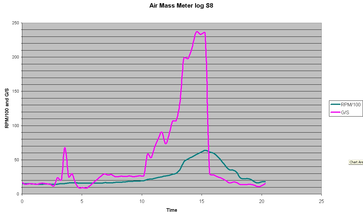

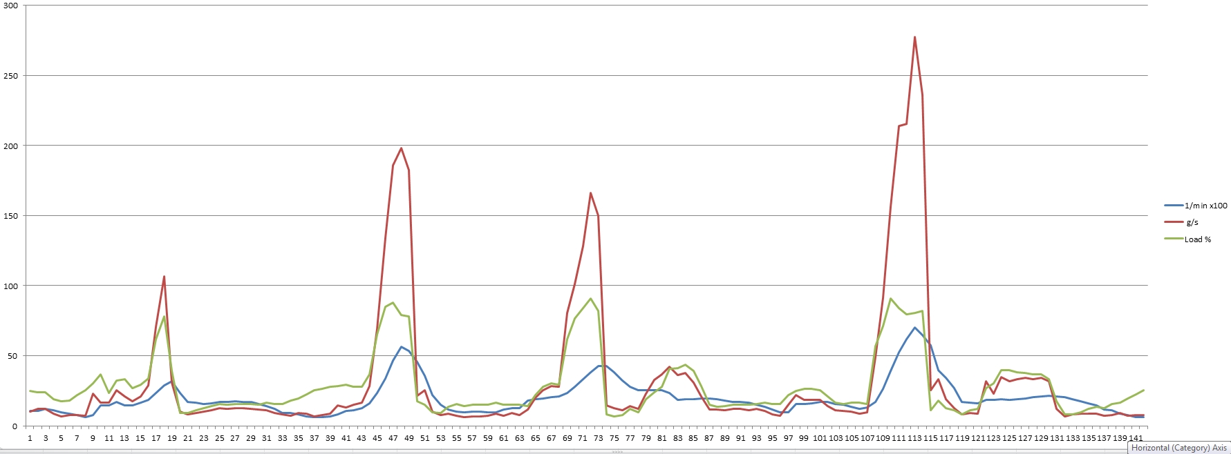

Logged values om 002 and 003 Bit ny excel skils are not the best. Anyone willing to make a graph if i email the .cvs files?

Old 1st August 2013, 11:05 PM
No probs, post it here.

Seems it wont let me upload that file type here.
Had to change from .CSV to .XLS before uploading
Looking forawrd to the graph guys

Old 12th August 2013, 12:42 PM
