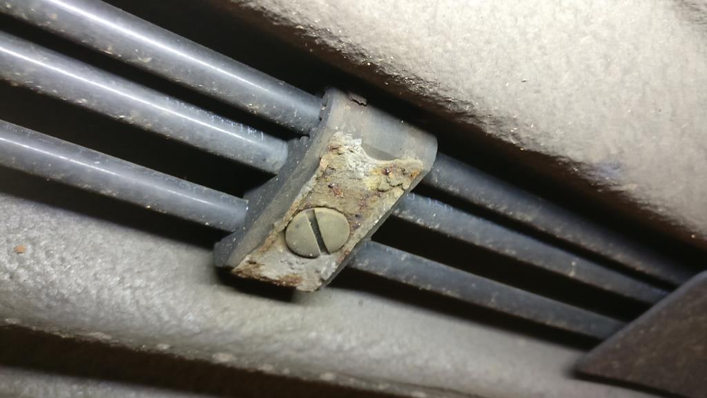

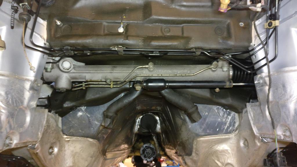

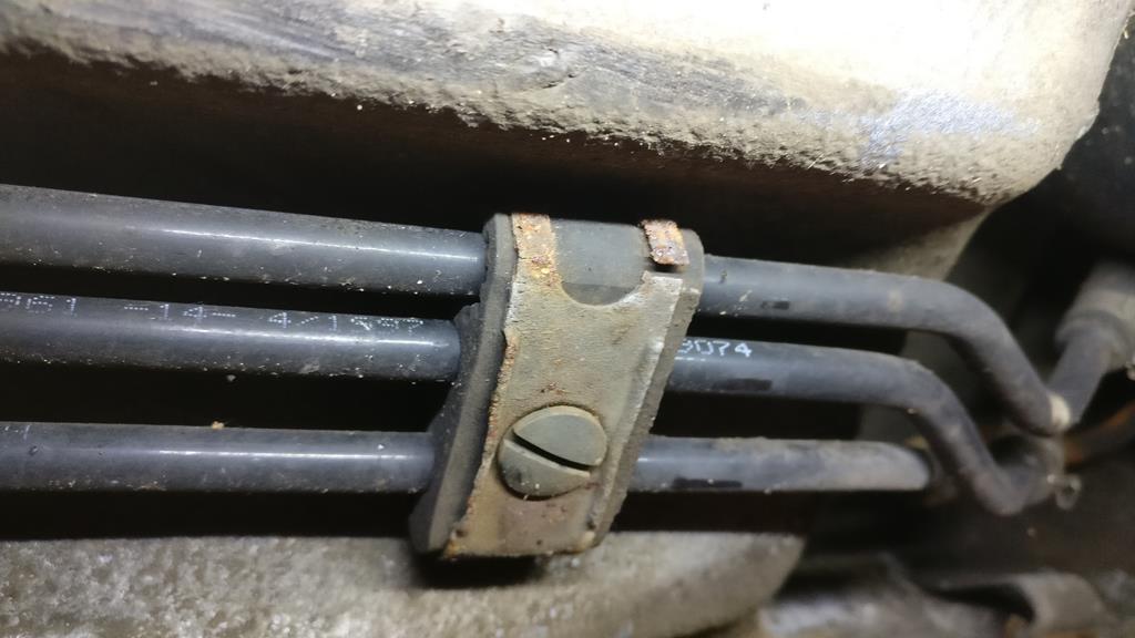

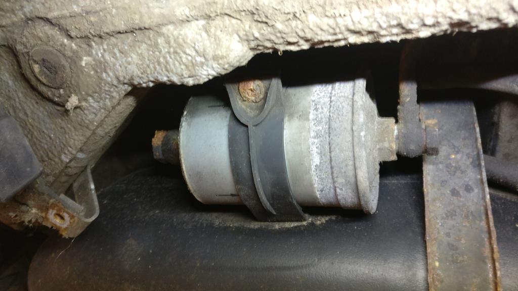

As usual the fuel line clamps have rusted away so these will be replaced
Original fuel filter?

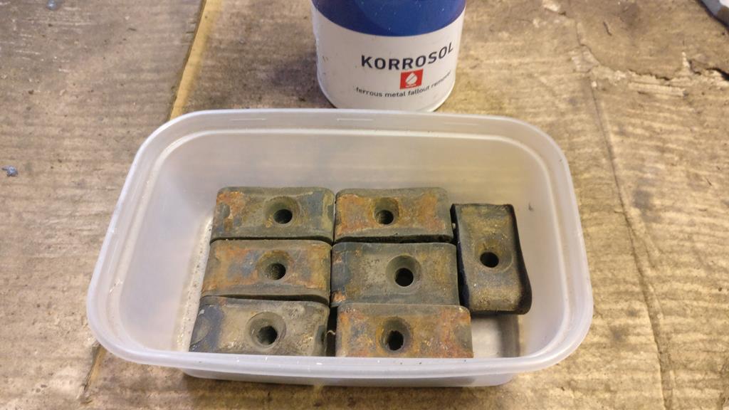

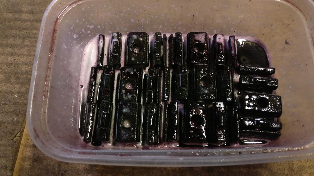

The fuel line rubbers will be soaked overnight in Bilt Hamber Korrosol to remove the embedded rust
Purple gloop
I put something back in!

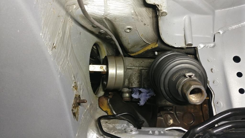

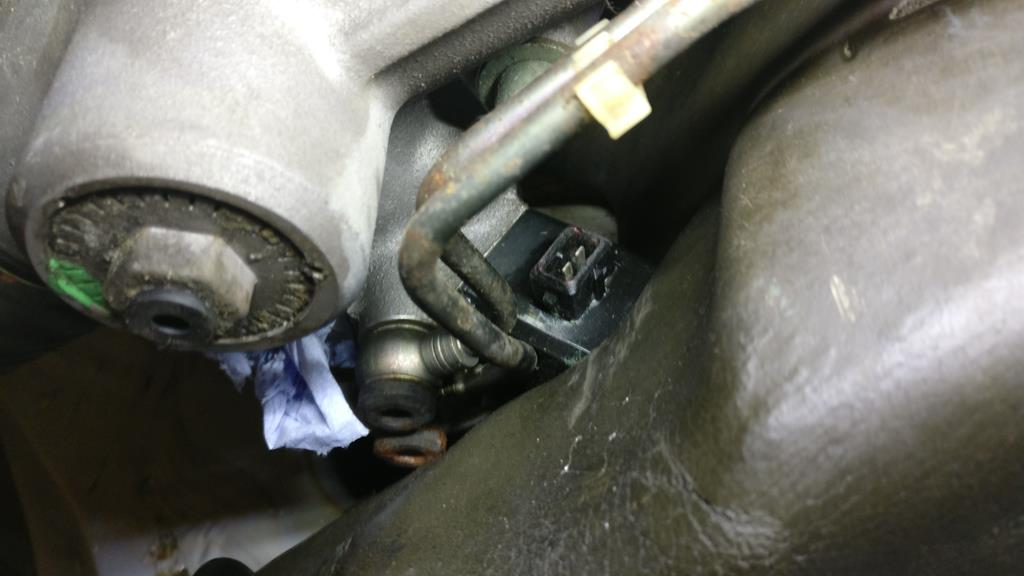

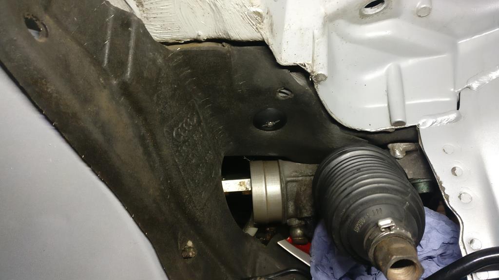

The connector for the servotronic solenoid is easily accessible, despite Audi's assertion that they used the ridiculously fragile trailing cable to make it possible to install the rack.

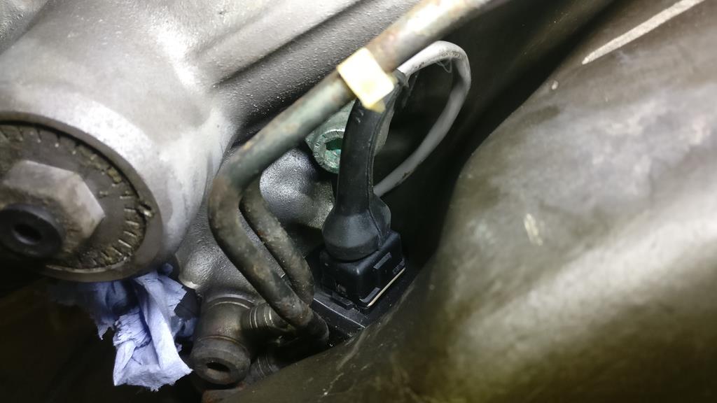

Connector harness attached
I run the cable over the top of the rack out of the way, rather than underneath like the factory did where it could get cooked by the exhaust

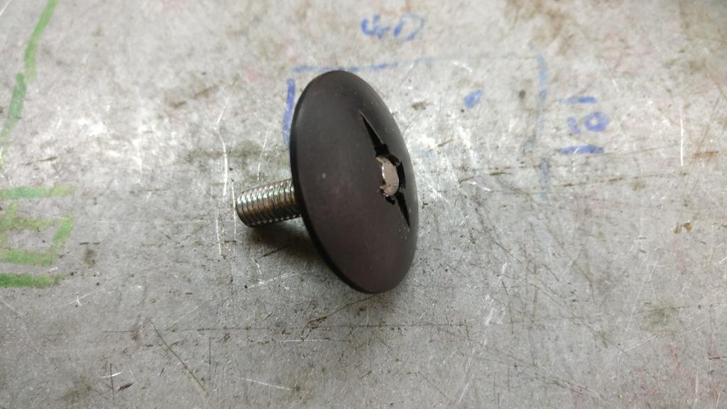

This plastic nut used to go on the stud which is now replaced by an M6 rivnut, so I screwed some M6 threaded bar in to it to make a hybrid bolt
Works perfectly

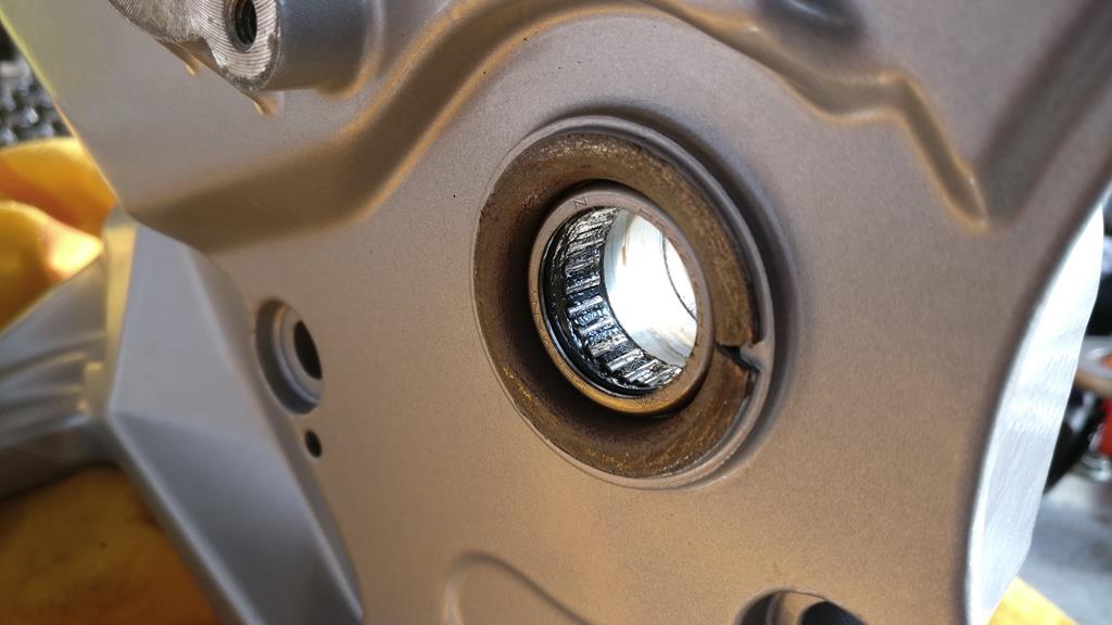

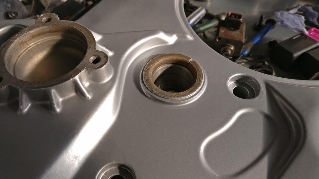

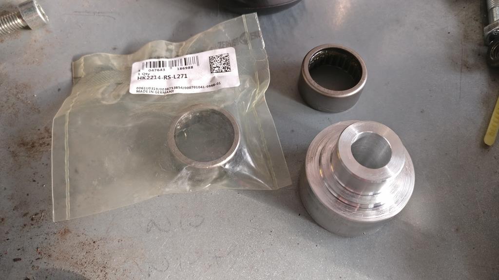

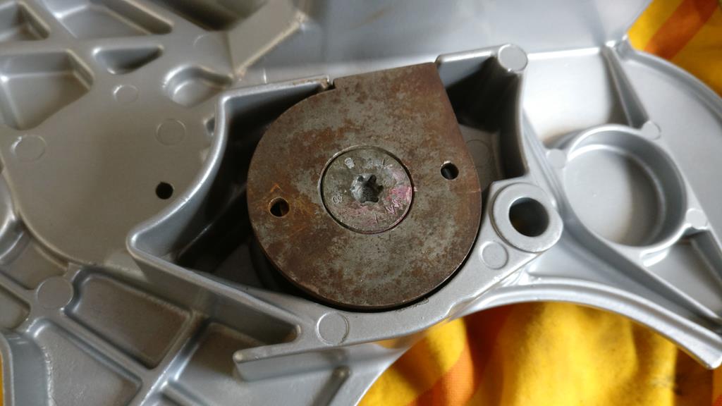

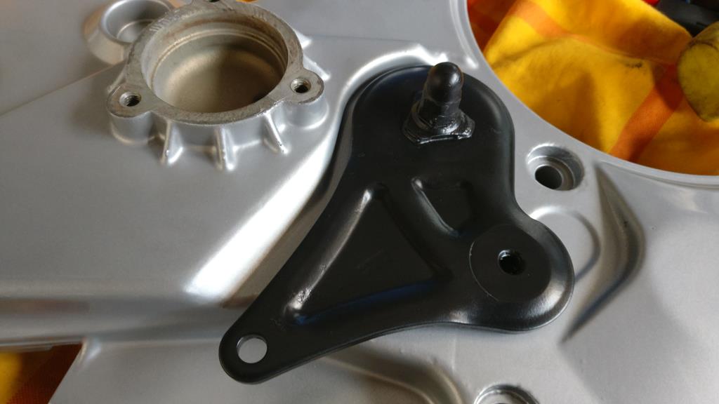

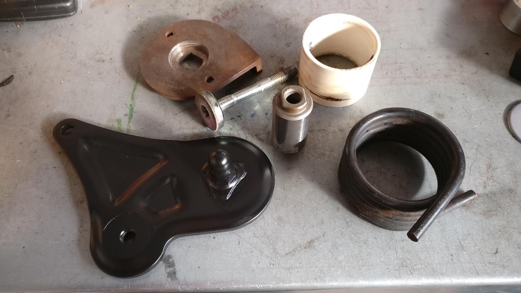

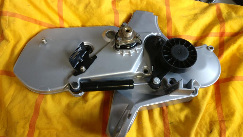

The aux belt tensioner in the PF is part of the timing belt cover. Its a complicated affair which runs on a pair of needle roller bearings which I had to remove to get it powdercoated
Two new bearings, and I made a tool to press them in to place
One of the bearings fitted
The tensioner, complete with massive spring just waiting to go sproing and break something / someone
Tensioner arm
Assembled view from the back.
I managed to put it together without scratching anything or the spring going sproing. I also fitted a new fan pulley bearing. I need this to finish the timing belt reassembly as the crank pulley locking tool fits in to the slot at the bottom of the cover

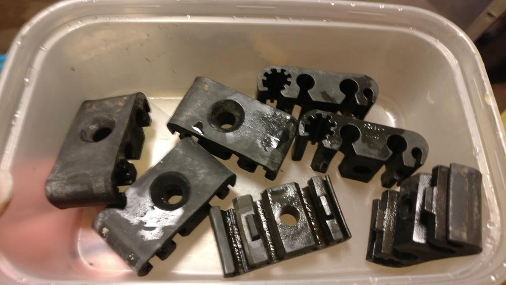

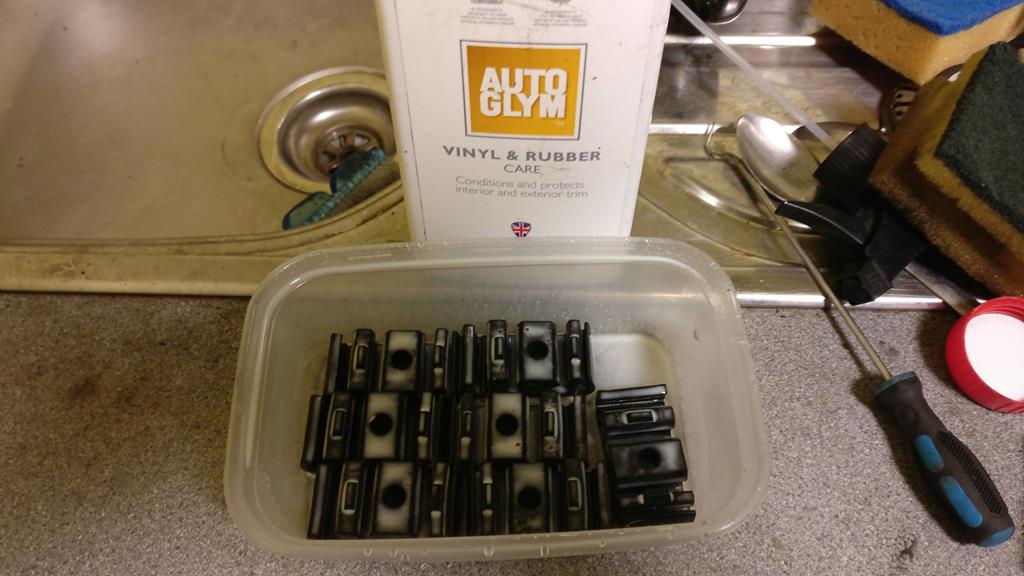

Fuel line rubber doodads now free of rust
They'll soak in rubber care solution overnight

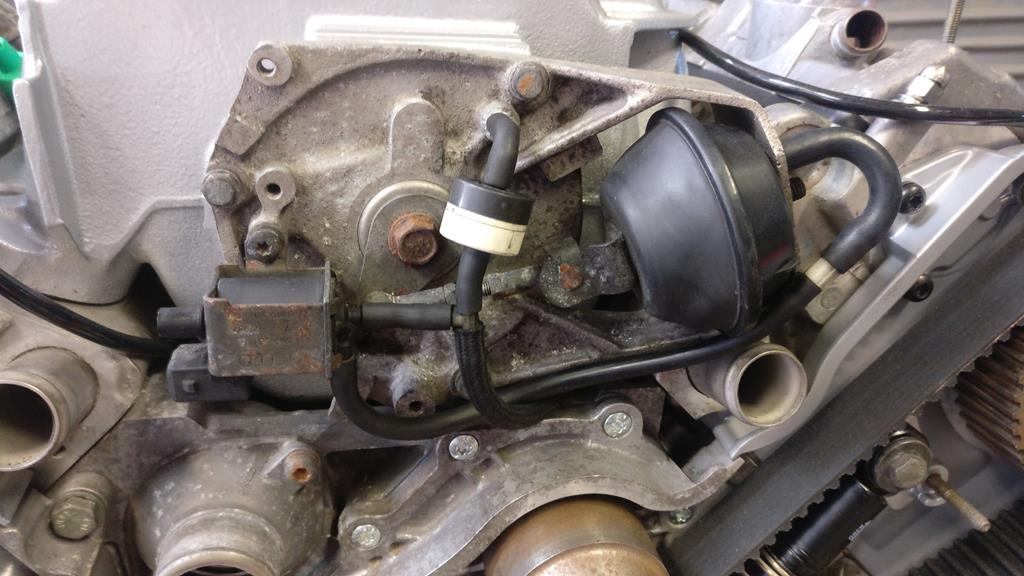

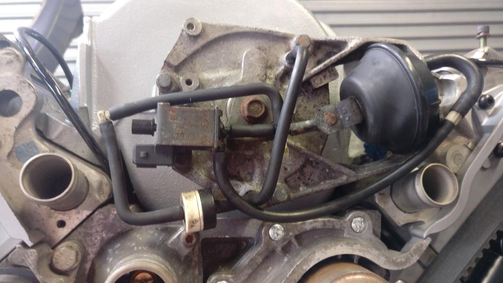

I put the inside of the inlet manifold back in and noted that this arrangement of vacuum pipes is very silly indeed, especially since it just flaps about.
Much better I've also tucked the vacuum reservoir hose under the inlet manifold and out the back, instead of it dangling over the top of the PS pump. More on that later.

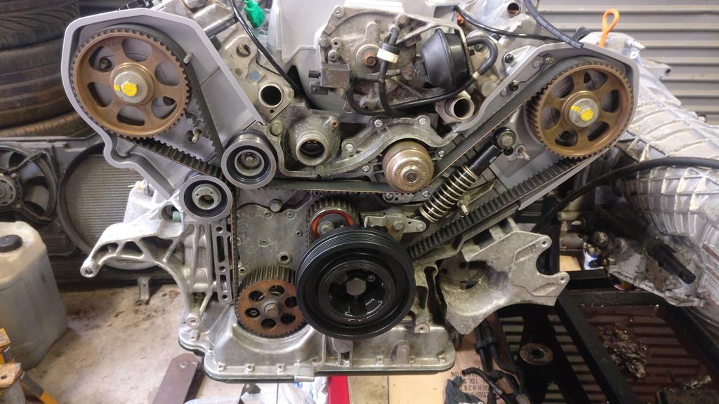

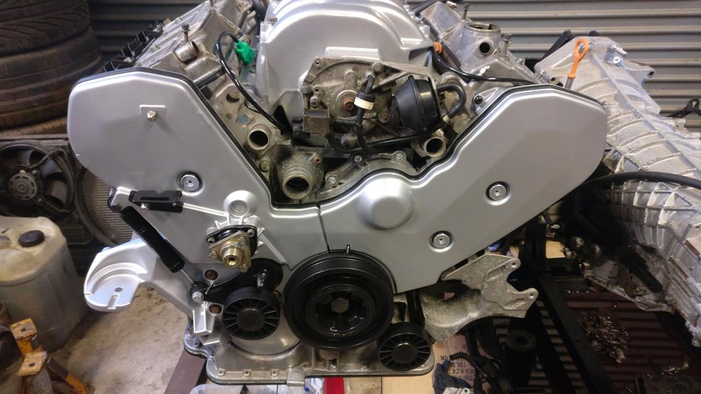

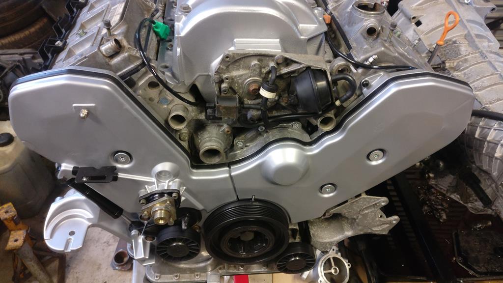

I finished off the timing belt setup and got the tensioners correct and the locking tools removed. Next job is to visit the local tractor workshop and see if they have a torque wrench that goes to 450Nm so I can do the crank pulley bolt

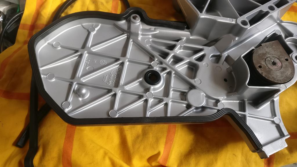

I couldn't put the old rotten rubber seals on the beautifully powdercoated covers, so even though the price of new seals is £ it just had to be done
Covers back on, and I'm pretty pleased with how smart they look
Manky rotten rubber here would just have let the whole thing down
