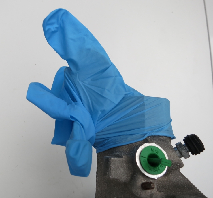

I'll give it a go, don't want the brand new calipers to be ruined too quickly. I have some silicone sealant somewhere I wonder how well it will stick to cast aluminium.
If you're going to use a glove make sure it's a nitrile, otherwise the oil / grease will react with the rubber. Not sure how long the silicon will last. It's an awkward shape to cover isn't it. Maybe some cable ties in the right places will zip the glove / cover down to the caliper body? If you were to cut the top of a finger off would the quadrant pop up through it so you could reattach the cable.

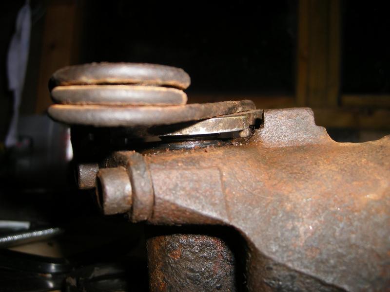

Could a track rod end gaitor like these be used to protect that area do you reckon?
Something like that Neil yes, but i'm thinking you'd probably have cover the whole area with something and put a slit in it to allow the quadrant to pop through, or a smaller boot. The gap between the quadrant and the caliper body is tight when it is back into position. In that photo above i had pried the quadrant out to scrape the crud off, this is how it looks when back in.
and is why i just threw a load of grease in the gap.
But were nearly there and obviously put in more thought than the original design. Anyone want to go into long life brake caliper design? Pull the udder one.

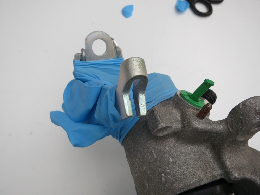

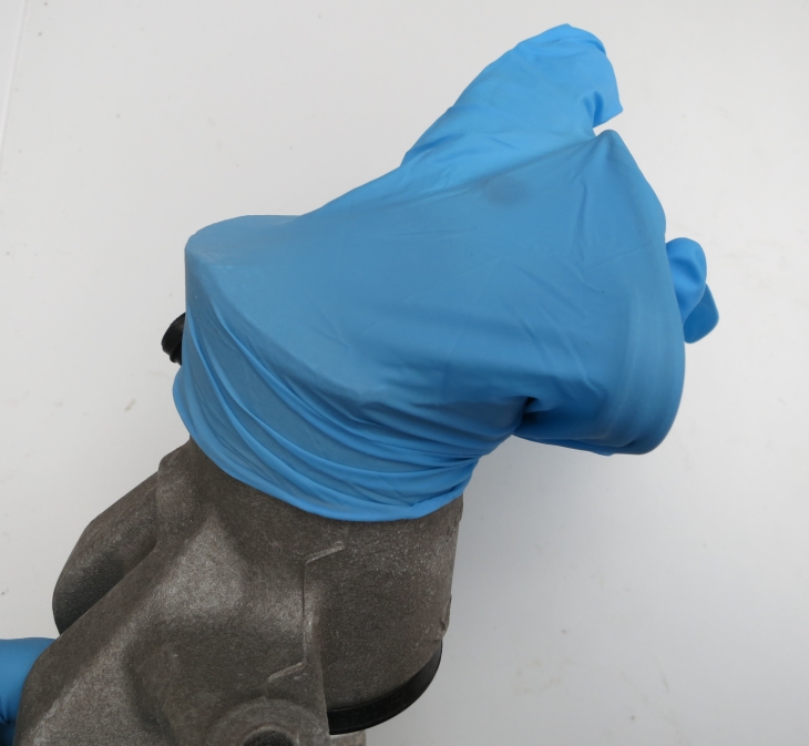

Dezzy you're right it does look really funny with the glove on there. I should have inflated it so it looks like an udder
The glove fits almost perfectly with thumb going over the eyelet post, and the 3rd finger going over the handbrake lever. The plan was to smother silicone sealant around the glove openings and zip-tie the big opening after application of sealant.
I have these thin nitrile gloves but I think they wont last, too thin. I need some thicker gloves. Also my mechanic is going to think I'm bonkers if I hand them over to him like this
So considering the calipers are only £95 each and last roughly 10years, I'm trying a less promising approach, just to see what happens. I sprayed both calipers with ACF-50 into the pivot hole. On one caliper I smeared high-temp silicone sealant as a makeshift seal/washer around the opening. I don't think this is going to last but lets see.
On the second caliper I'm going to try to find a nitrile washer that will fit and see how long that lasts and if it keeps dirt out.
Also I wish I had time to get the calipers painted.
