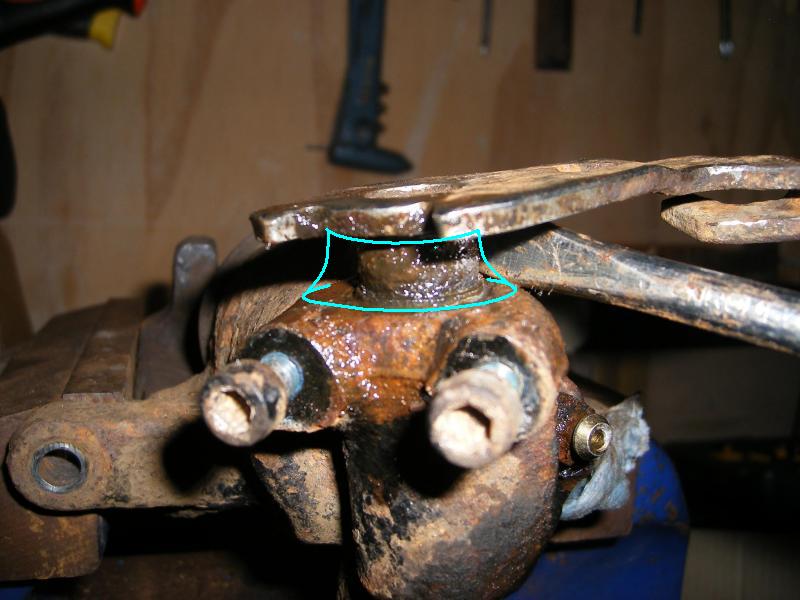

Hi Goran, a few years ago i had a go at my rears as the handbrake was always sticking. There is a rubber seal but its in the caliper body rather than a boot as such. And you're right it is dirt and rust build up at the point you suspect that eventually stops the handbrake from returning. That or the cable its self sticking in the liner, but i would go with rusty pin into the caliper. There are a few photos of what i took off my 8 just for reference so you can see the part that sticks HERE and HERE
Unless you have a bit of time, want to play or have a MOT needed badly and no way of getting remanufactured parts to you in time then go with the referb'd calipers.
Old 20th July 2015, 09:34 AM
Thanks Dezzy, good guide and lots of good pictures. I wish I had more time to have a go fixing it myself, but my MOT has expired so I'm in a bit of a rush to get the car road worthy again. I ordered the remanufactured calipers, fast service, should arrive tomorrow.
The caliper I replaced on the old car may have been so corroded I couldn't see the rubber washer. As soon as I saw the handbrake lever assembly I was disappointed that Audi didn't add a large gaiter between the caliper body and the handbrake cable arm. Just going to borrow your picture, something like this.
I was almost going to glue a rubber glove (onto the casting) over that area as a makeshift gaiter, but I doubt that would last so I didn't bother.

Snap, the rubber washer type seal i could not see until i scraped all the rusty crud off.
A rubber boot like your drawing would have been a good idea.
I think knowing that they will end up seized at some point, it is an area that needs maintenance. Keep packed with copper grease around that pin. I'm sure a glove or similar would help
Old 20th July 2015, 09:19 PM
I'll give it a go, don't want the brand new calipers to be ruined too quickly. I have some silicone sealant somewhere I wonder how well it will stick to cast aluminium.
