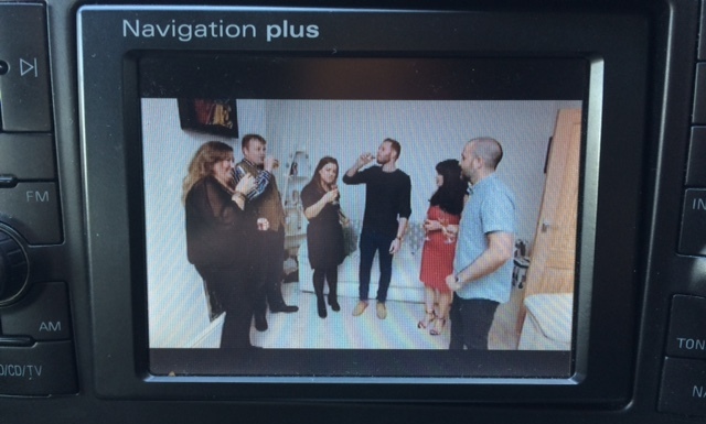

First test, that's it for today.
Aerial not yet supplied with power and we're in a valley in a rubbish reception area, but it still got Channel 4!
