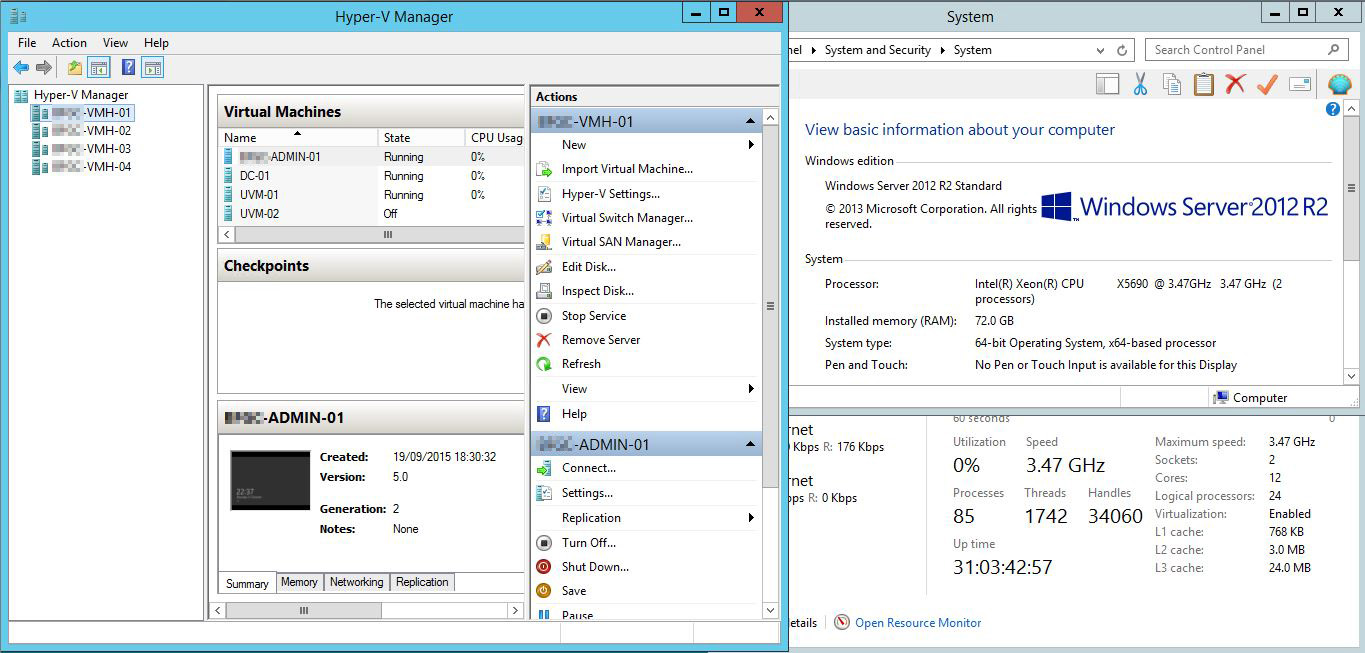

This is what you need .... some serious server power (notice the 24 logical processors and 72GB of RAM)
This is a setup I've been working recently on for a business customer. There are 4 servers in the group: 2 of them are of the spec you can see in the screenshot and the other 2, which only have 12GB of RAM each, are running the free Hyper-V 2012 R2 'core' OS (but can be managed from any of the full Server 2012 R2 Standard installations). The best thing about MS Hyper-V is how you can 'live-migrate' VMs from one physical server to another with zero downtime. I also have some of the VMs configured for replication such that, if one server dies, I can quickly power-up VM clones on another server in the group.
