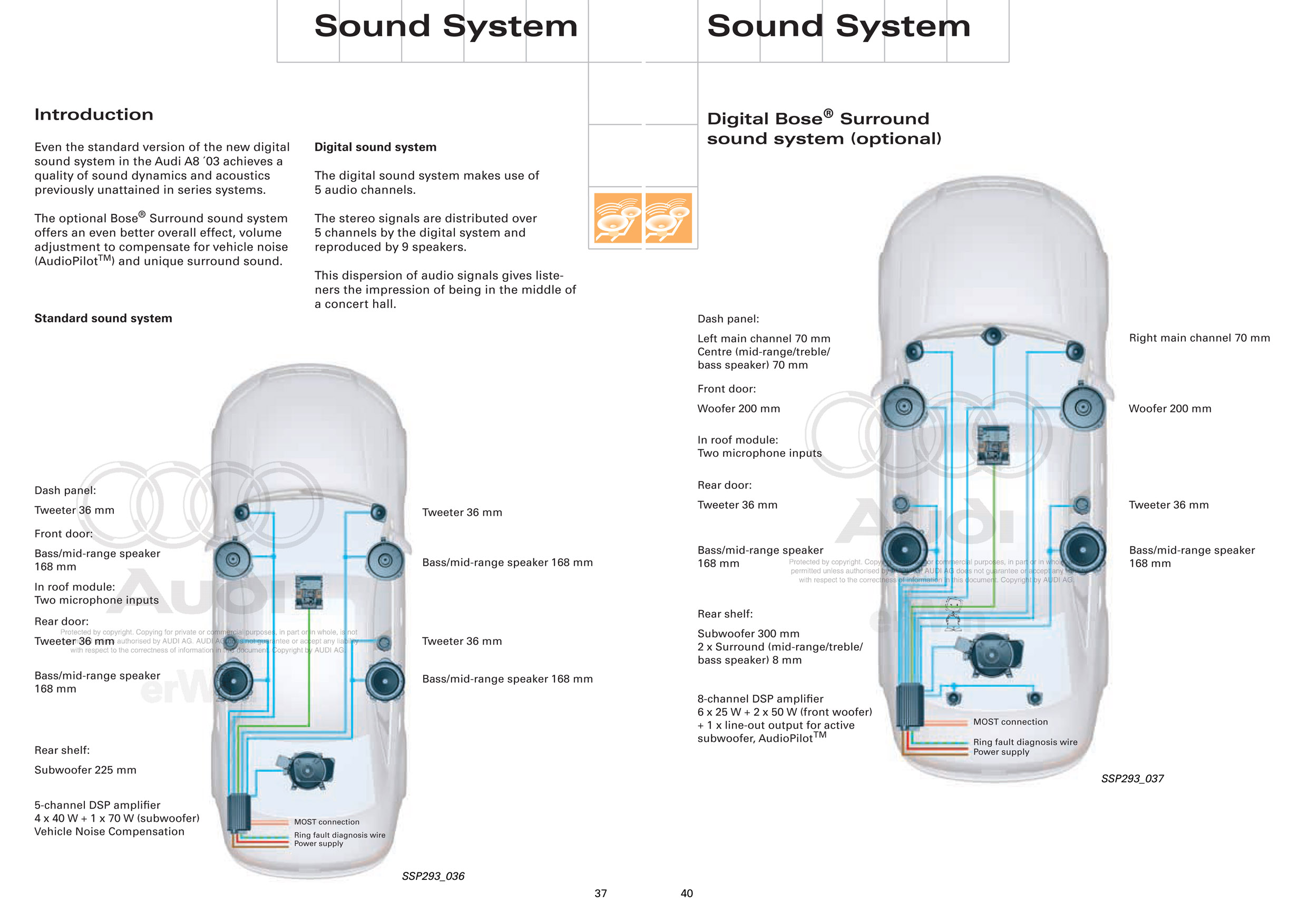

Page 37 and page 40 of the 03 document show you whats in the standard and bose packages
So also MOST based. Amplifier in the left rear. At least this means I can pickup on the speaker wires going to each of the locations if I wanted to replace the amp. I suspect the only option is to leave the existing amplifier in place to act as a convertor from MOST to 'analog' and then using something like a BitONE unit, try and clean this signal up and then push that back into a new amplifier.

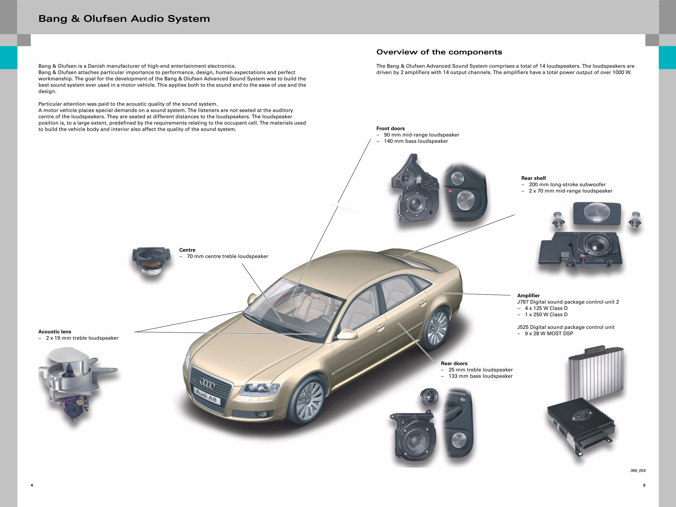

Here's some info on the differences between the systems.
ID:	12000   Click image for larger version
Matt
