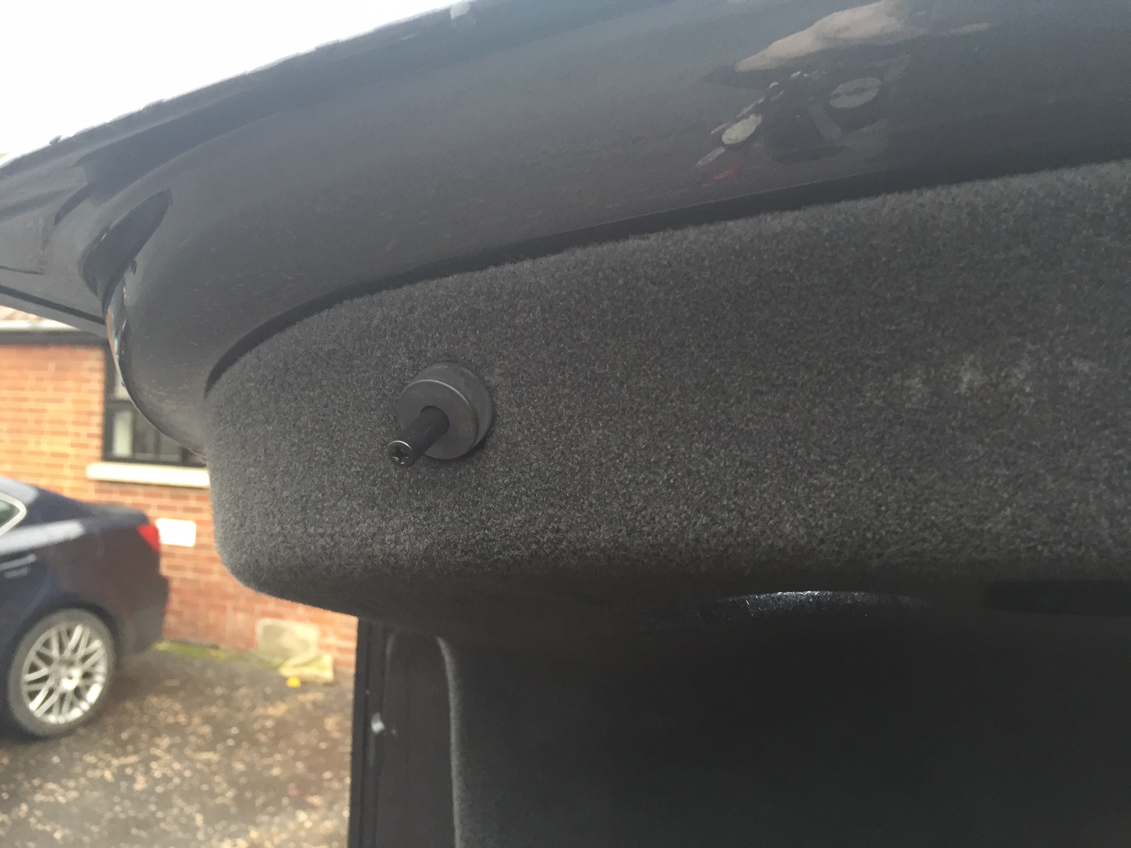

Here you go chaps
ID:	12061   Click image for larger version
ID:	12062   Click image for larger version

its just a simple unscrew of the blank one thats on yours (by hand) out of the other half of the unit which is fixed to the boot lid, then separate the new parts and just use the outer part to screw back in to the existing part in the boot - much easier than changing the whole thing

My spring-loaded buffers arrived the other day. Took about 10 minutes to fit (it's easier if you pull the trim away, because the hole in the trim is slightly too small for the wide end of the buffer).
The boot has opened perfectly every time since

Mine arrived yesterday, fitted them an hour ago, as Witchfinder says above, a 10 minute job.
My boot always opened, but somewhat "lazily" compared to what it does now.
